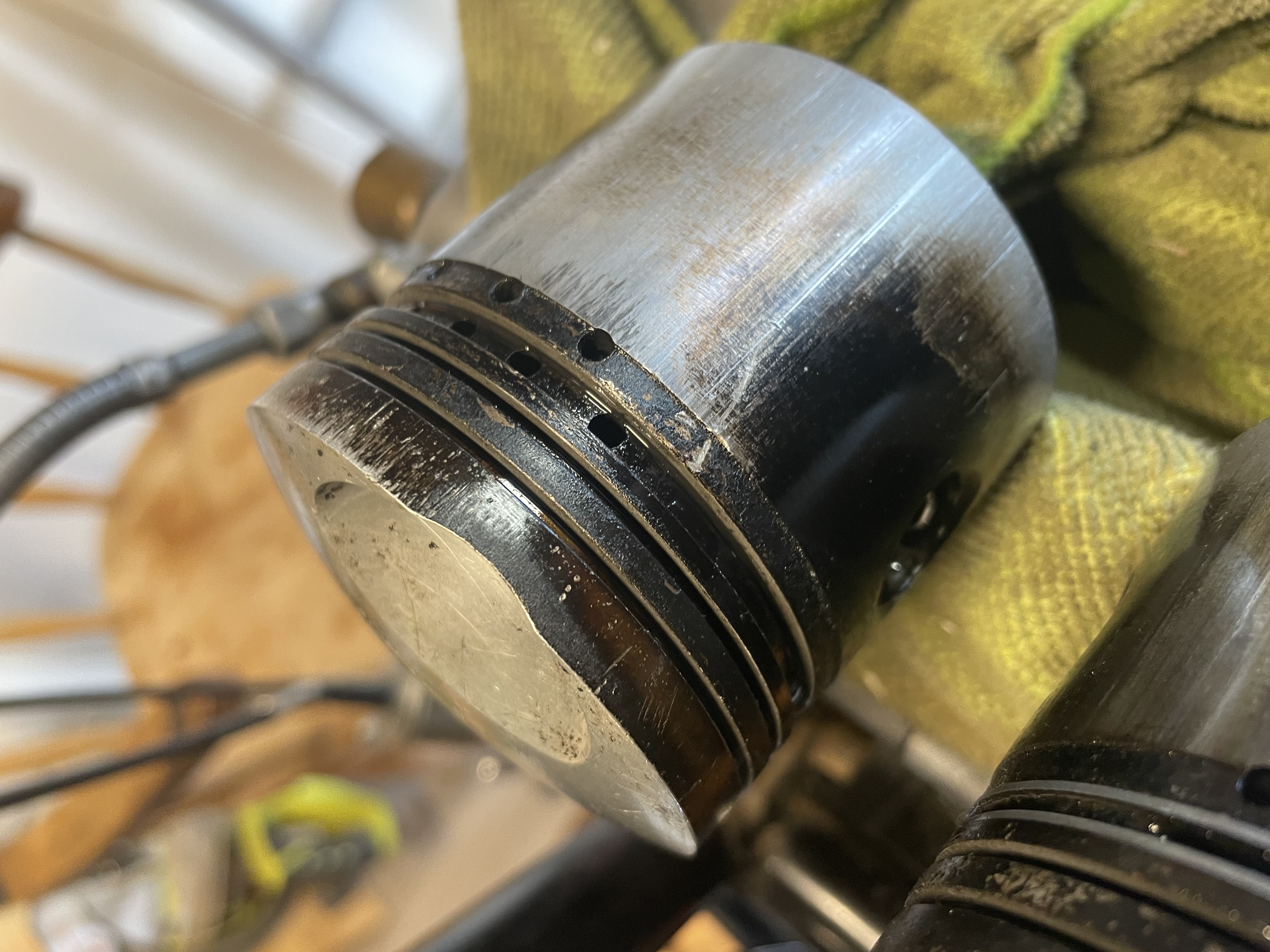

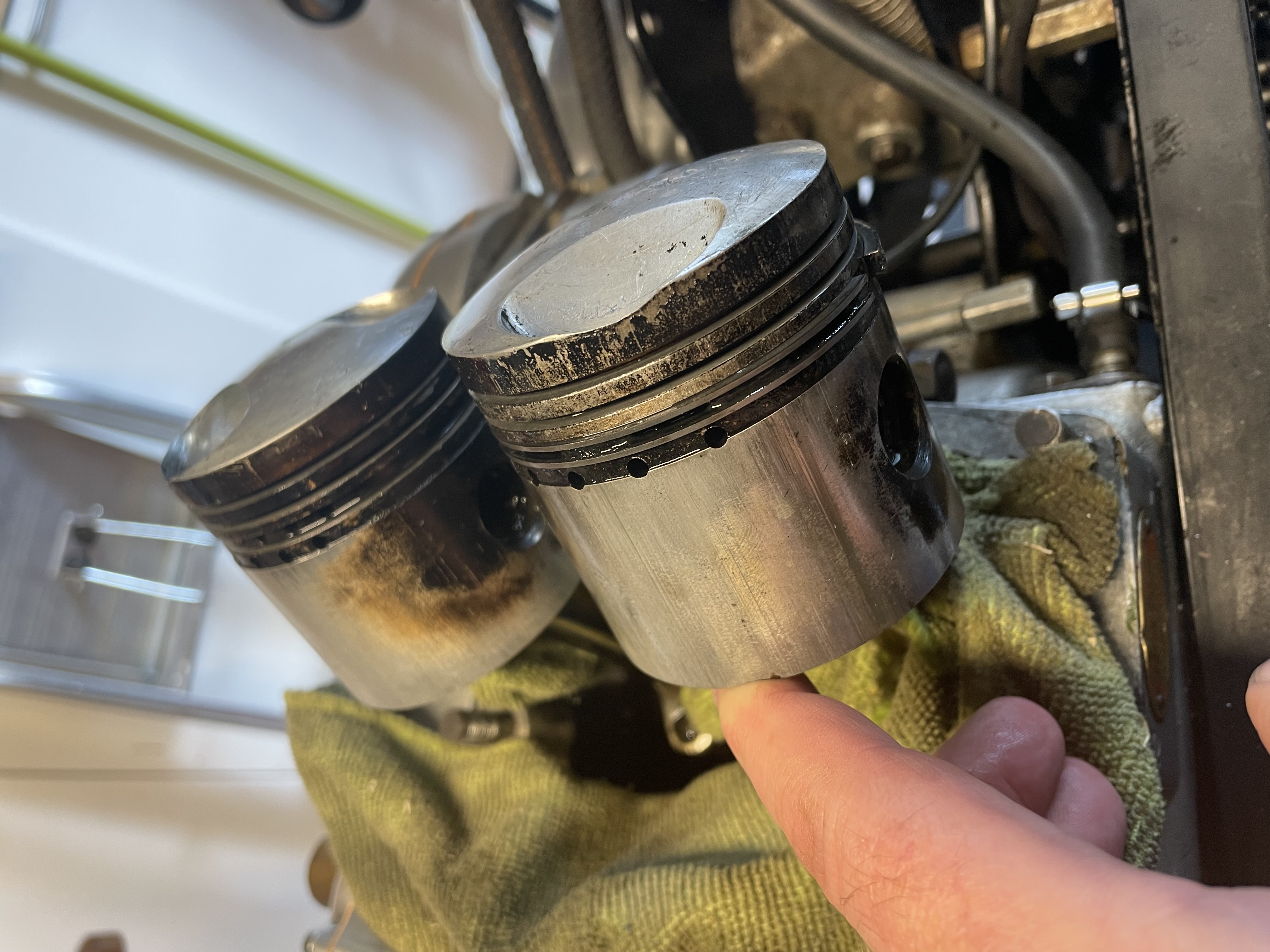

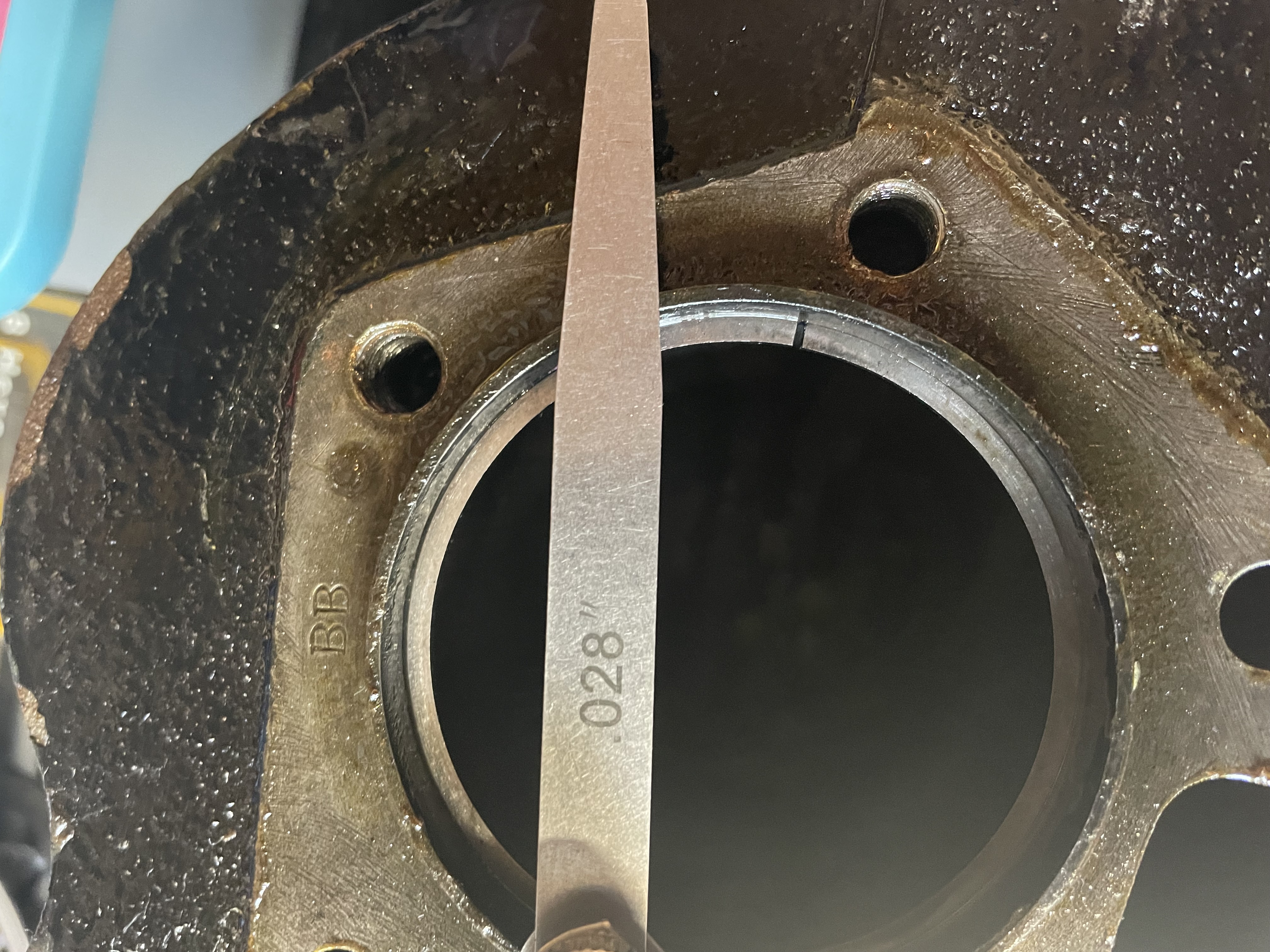

Ok - Cylinder off and can of worms has been well and truly opened...... see pictures.
It seems that the oil test for compression does not lie.
Forgive me for doubting you Service Notes. Truly the font of knowledge.
Back to the worms..... The gap in the piston rings is .026 not the .010 specified and the pistons themselves have seen better days. These were .040 650 SS pistons but in a 99 barrel. The Oil rings simply snapped off when I tried to get them out so I'll need to replace these and probably find new pistons. Like I said - can of expensive worms.
Next stop - assess and measure the bores and see if we can move up to .060 I guess, unless anyone has any bright ideas.....
Fit a decent air filter on…
Fit a decent air filter on rebuild. Those pistons have suffered from ingesting dust and grit.
I am amazed that people run their bikes without any air filters, but hey ho, they must like reboring their engines.

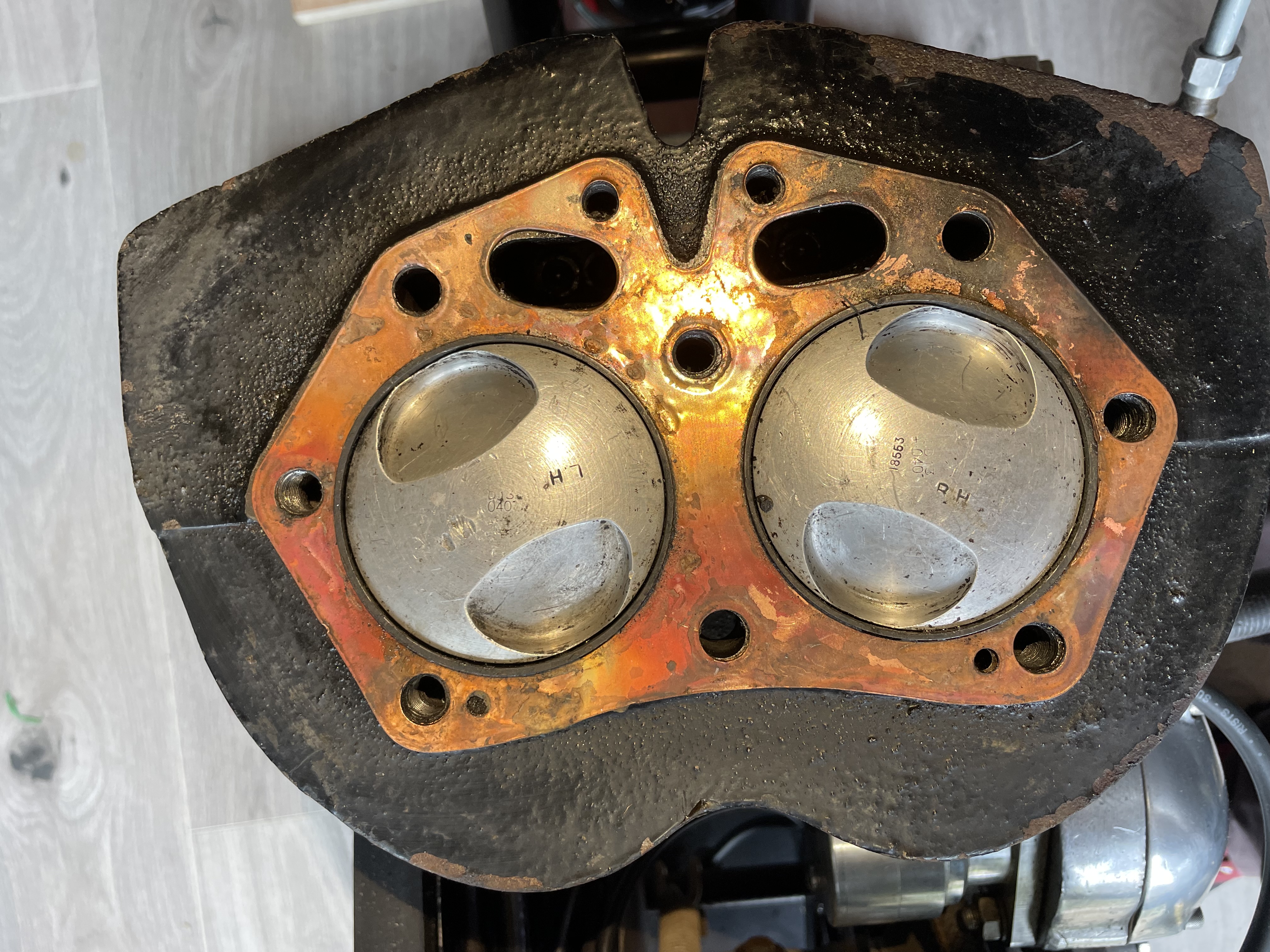

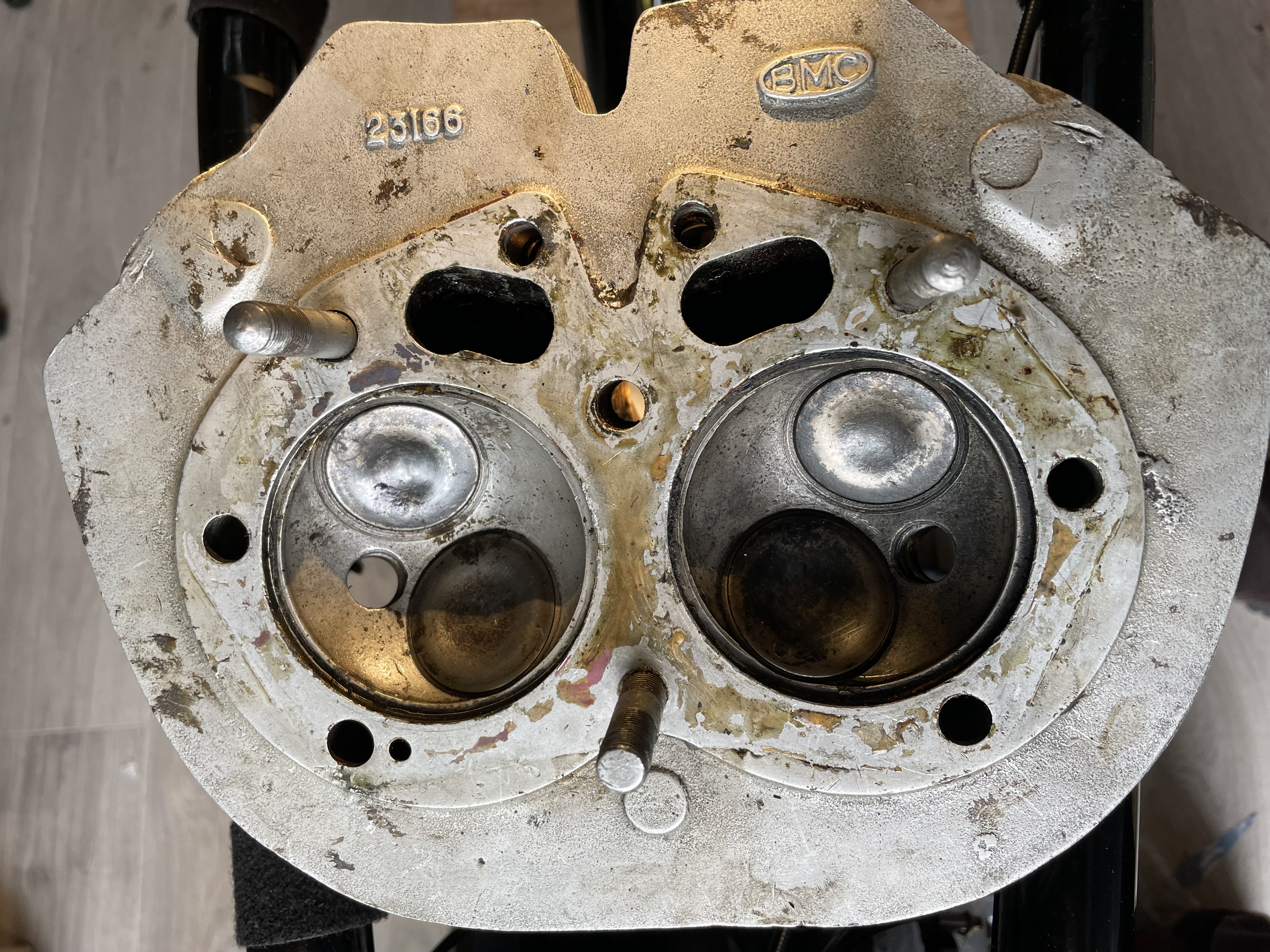

Some photos when the head was off recently. Spigoted head and barrel. That's the old copper and asbestos gasket which was replaced with new copper gasket from Andover.
