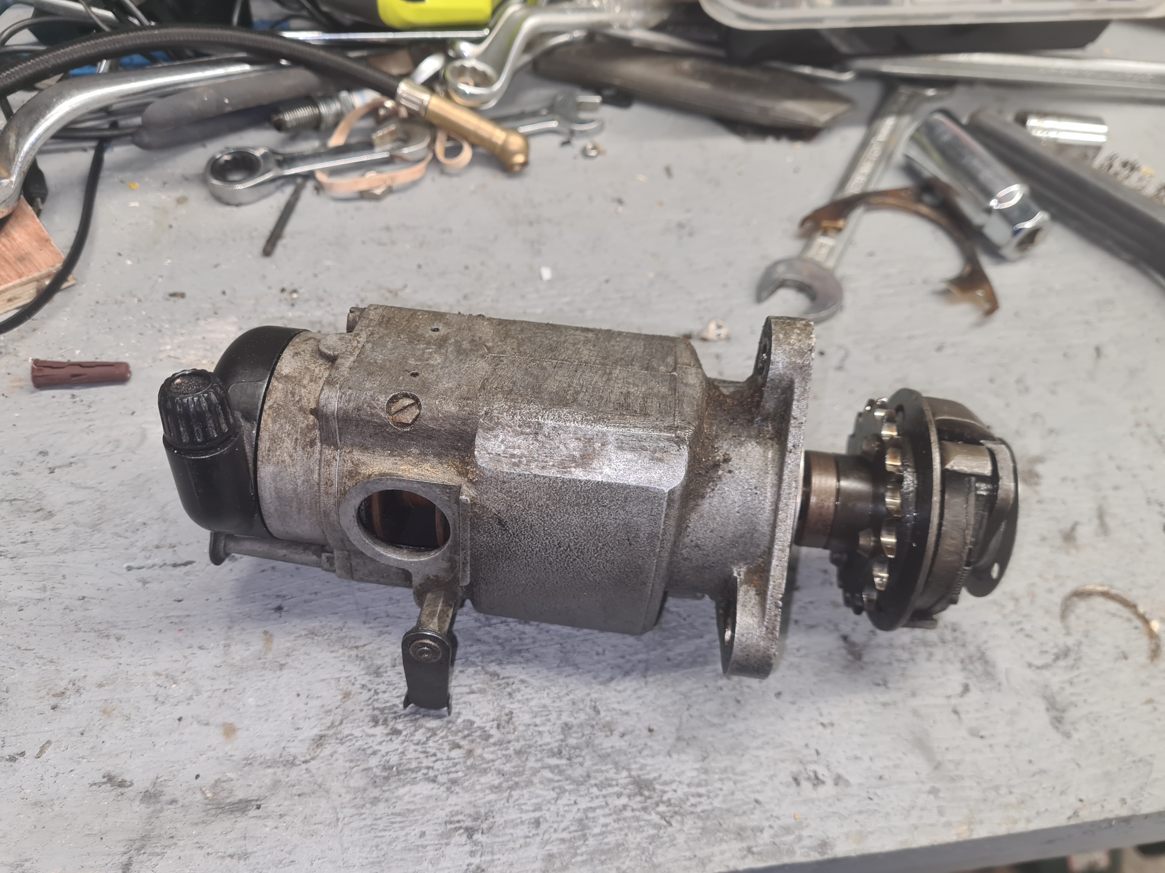

My Mag has no spark so it's now off and on the bench.
can anybody recommend the best place to send it too?

I will double check before it goes off but I am pretty sure its dead. The leads are brand new and have new carbons in the pickups. I removed the small screw on the top and put a fresh carbon in there too and it chewed it up after spinning the mag.

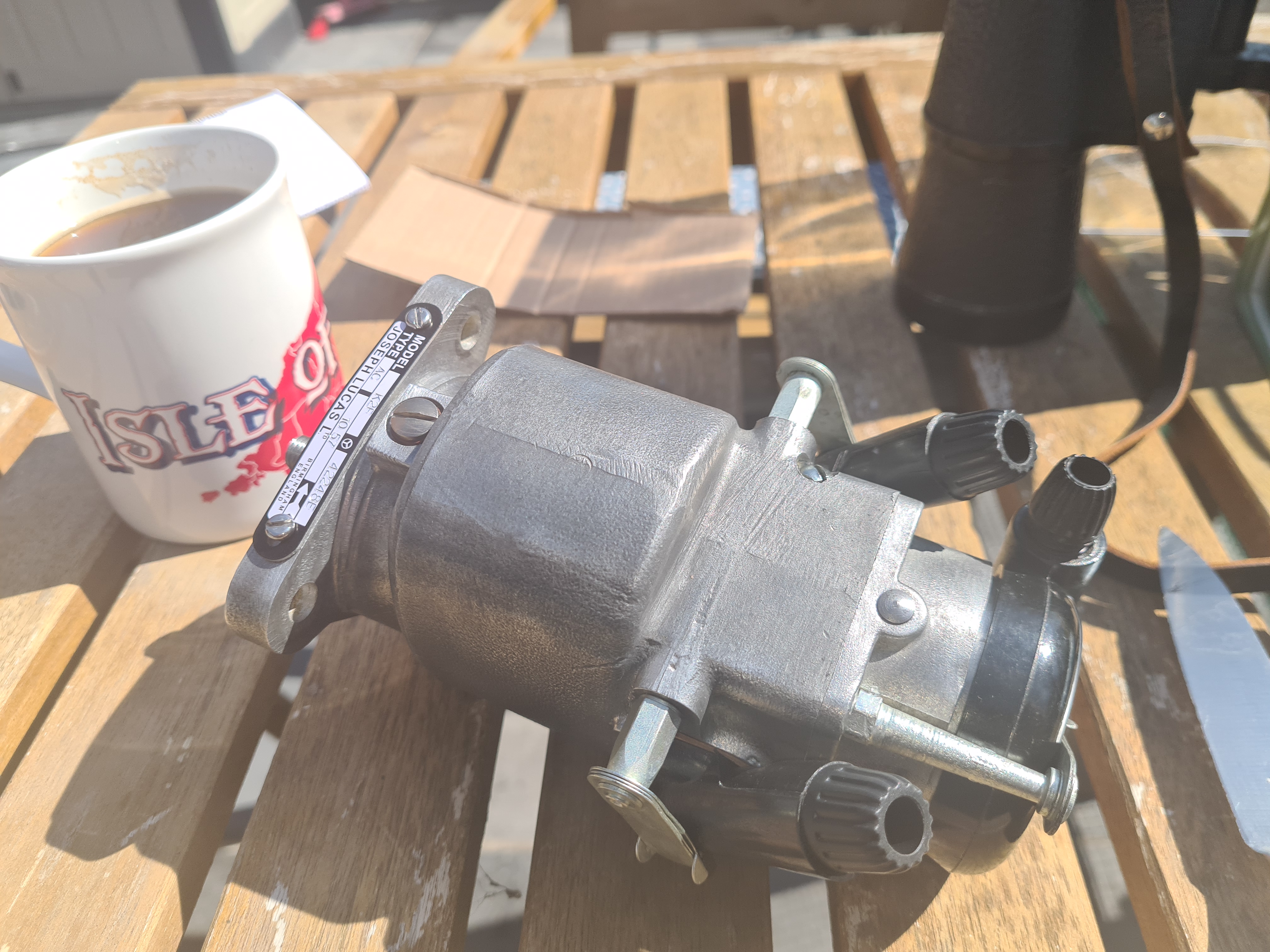

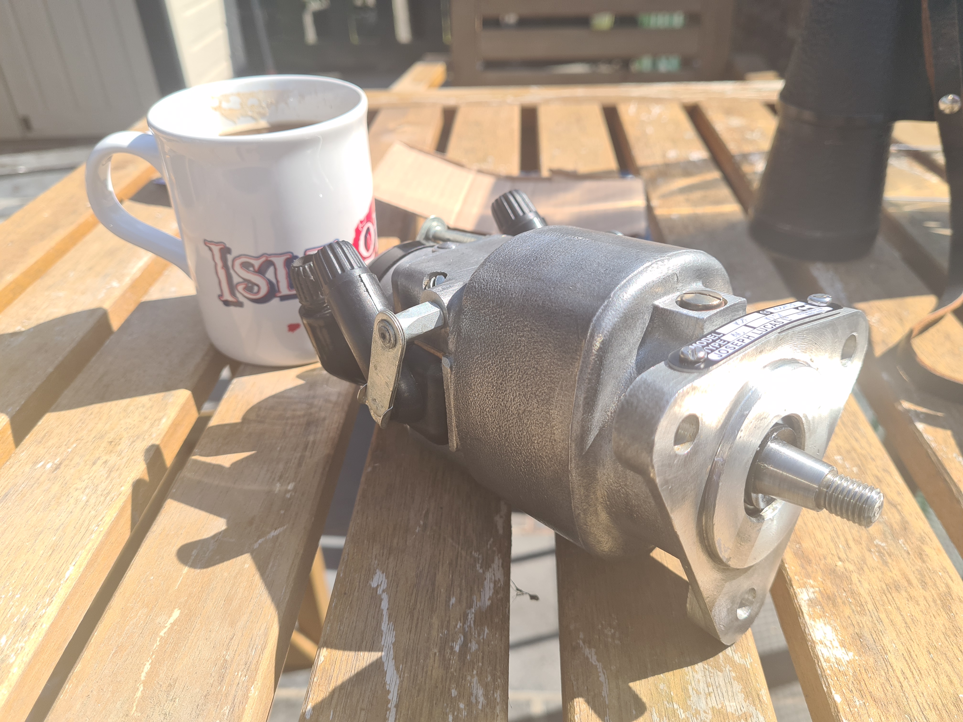

Magneto update.
I sent off my magneto to Peter de Kramer (see above) last Saturday. He received it on Tuesday. He phoned on Wednesday to say it was ready. It arrived yesterday (Thursday), complete with 5 year parts and labour guarantee.

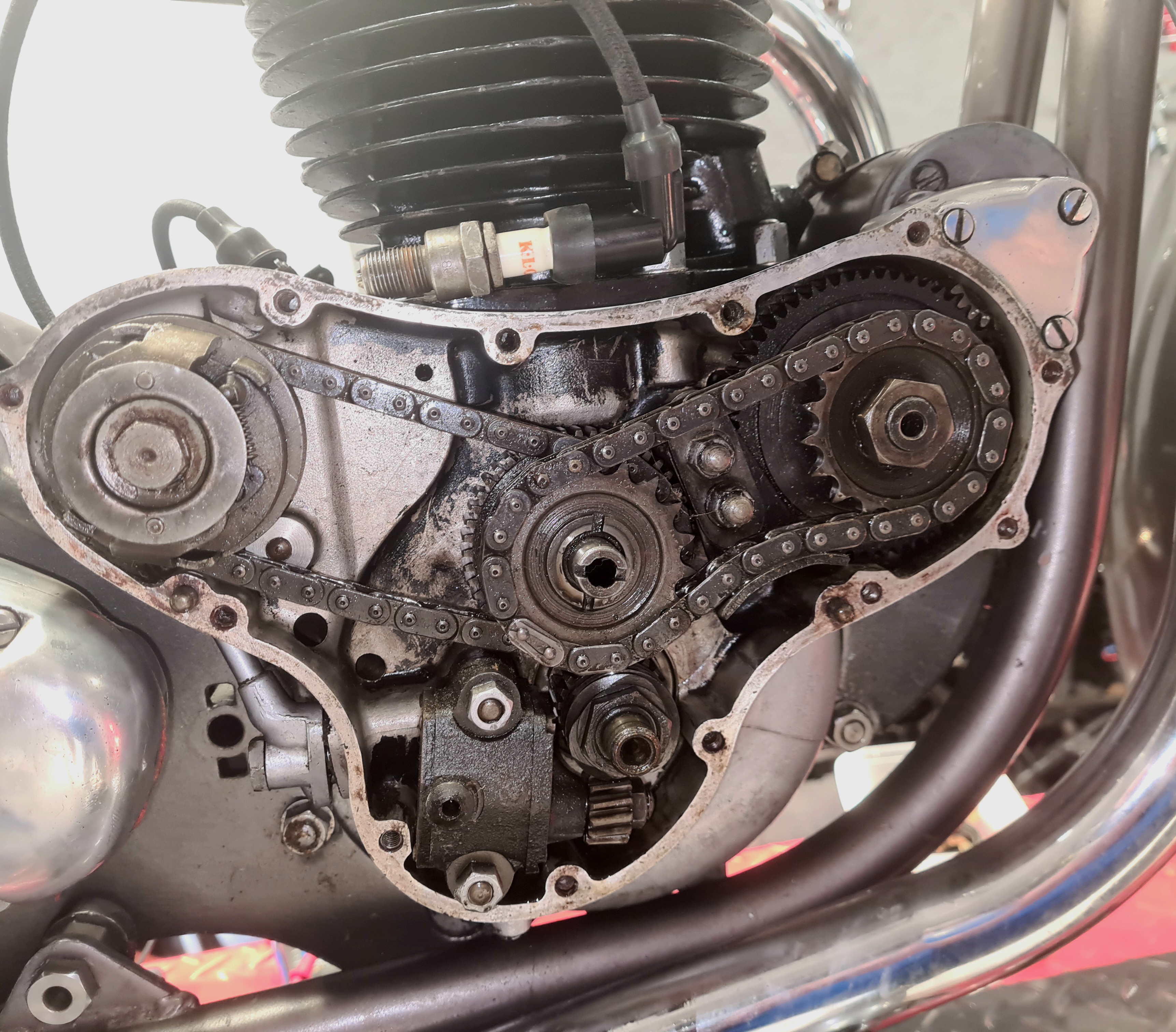

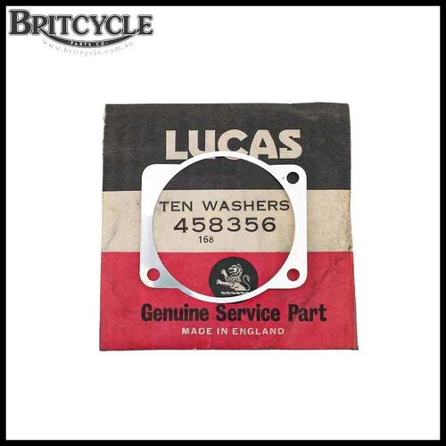

K2F front cover shims
There are 4 off - squarish, holes in 3 of the four corners. They are very thin and twist a lot after removal. Where can I buy replacements in the UK ???
Before you do that check the points are clean and there is a 12-15 thou gap., Remove the pickups and see that the brushes are springing and rough them gently with a very fine file. Have a look down the pickup holes and see that the brass commutator on the slip ring is clean. You can clean it with a cotton bud dipped in white spirit. Check the leads are unbroken and have a good contact into the plug holder and the pickup. Check the plugs are clean and around a 15 thou gap. Hold a plug against the mag body in your left hand and with the other hand flick the advance unit counter- clockwise as hard as you can with your fingers. Do you see a spark ? Or do you hear a crack of a spark ? If it really shows no life then consider further expensive specialist work. Paul at APL in Shaftesbury is excellent but it depends on where you live - there could be some other specialist near to your home. Good luck, howard
