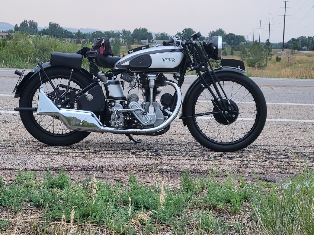

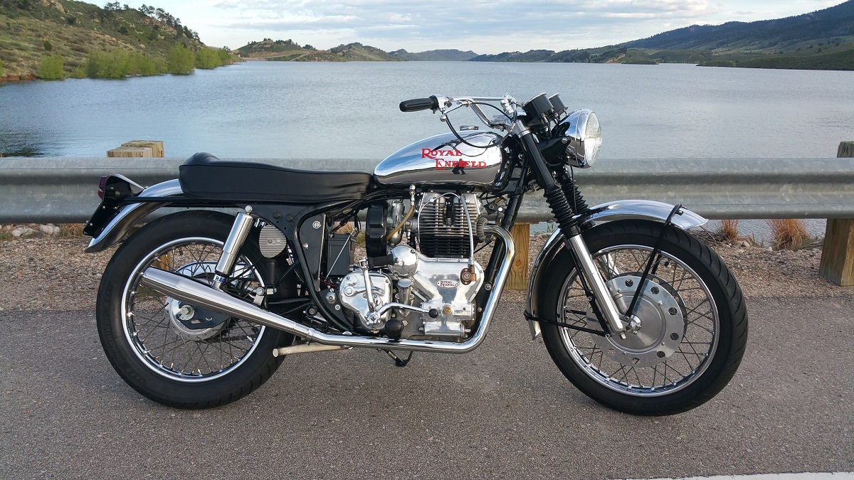

I've posted some pics of the Inter in front of my garage door. The compact side stand is an item from RacingNorton, it bolts securely to the frame tube underneath the primary cover, only shows the end of the stand with easy to access with one's foot to swing it down. First bike I've owned with 3 stands!

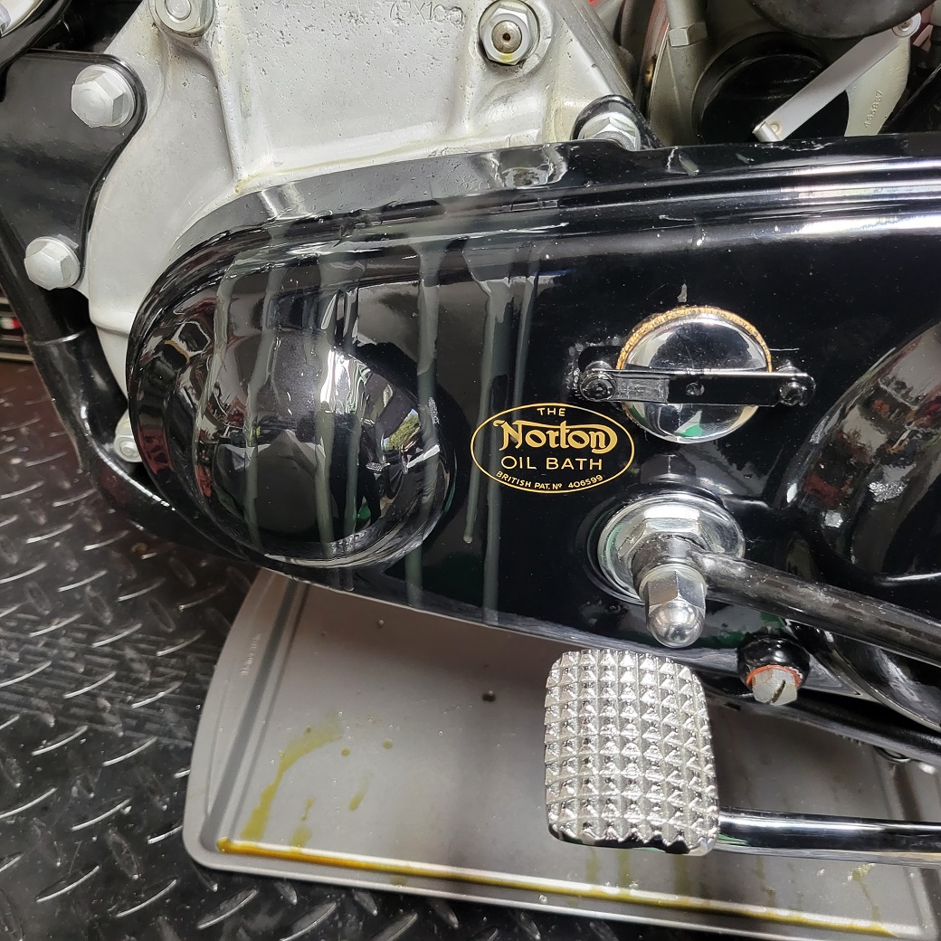

Primary cover oil deposits
Steve, your engine has a breather at around 3 o’clock to the crankshaft. There is a
pipe connected to it aimed at your drive chain… … make sure connection is tight.
Is it coming from there? It’s not aerated oil just looks like a deluge from some where.
Fill level for primary is right when bike is level and bottom run of chain dips into the oil. The crank also has a timed breather that may well have ejected the oil out of your sump into the primary raising the level significantly. Open the fill level small bolt, see what comes out… Maybe it’s over full now.
For your elimination journey, empty it. You can run for a few journeys without issue. When you return open up the drain plug see ifs filled. If you outer cover is clean your in the zone!
Did you drain crank cases before you started? Wash down and dry the machine, dust the suspect areas with talc, drain down the wet sump, start up. Check out the breather, is it blowing oil? Take the inspection cover off the primary. Is it blowing there?
Now the best bit…. It looks stunning, I can imagine the grin on your face as you pop it into third as the sound trails behind you. Those mountains behind your place are going to be calling!!!
The journey has started, it’s like a new girlfriend, need to pay attention to keep it sweet!

...for your reply! Reviewing your comments:
1. The breather pipe connection at 3 o'clock to drive shaft is tight and leads directly to the rear chain. The back side of the inner primary cover is dry. The chain is not overly wet nor does the rear wheel have oil on it. Wiping down the head and cylinder; oil collection negligible. There is no oil dripping from the bottom of the gas tank. I am convincing myself that despite filling the primary case to up to and not past the bottom of the threaded hole below foot rest is still too much oil in the case.
2. You observation of a deluge is correct and adds a new dimension to the pride and joy of Norton's "Oil Bath." Given my observations in #1, not only do I not see where that oil came from i do not comprehend how oil got on the outside front half of case. Needless to say, seeing that oil, I was shocked, but not quite senseless...
3. Yes, the crankcase was empty before I test rode. When you say "Check the breather, is it blowing oil?" do you mean the breather at the 3 o'clock position of the drive shaft?
4. Next start up I will remove the primary inspection cover and look for oil blowing. I'm going to 'see' what i can do to try to get some oil out of the case without removing the outer cover. The two cover halves seal perfectly; I hate to tamper with my seal. Regardless, what i may not discover the source of this leak, I will ride again, perhaps with the
5. YES!!! Those 12 miles were a thrill. Looking forward to more. On yesterday's ride I was sorely tempted to ride into the foothills, but I figured there might be some details needing tended to after the 12 mile ride. And there was. I am looking forward to the next ride, but likely will wait for my registration and license plate to arrive before I venture further.

In #3 I meant the crankshaft breather that vents into the primary...
Wash down and run it till you spot the source. Does it smoke on startup? Have you adjusted the feed to the rear of the piston?? I still recommend draining the primary and run it a while to see if it self fills. If the chain is wet you are OK to continue. (The lube is also for the clutch drum rollers so don't go up in them far off hills till you are filled again)!
Next trip out it will probably be clear...

Does it have a complete belt…
Does it have a complete belt? Maybe the previous owner ran it without oil and put in a discontinuous belt to let air in to help cool it? Some owners allegedly used o-ring chains, or some exotic stainless chain designex for zero lubrication in the food industry! Chain saw oil or simply regular spray lube (it's difficult to spray the whole chain with the cover in place)

The chain is a standard Reynolds.
The p.o. had never started the bike since its build 20 years ago, so much of what i am addressing is what one can encounter when the machine is put into service after the a complete build.
An O-ring chain is a good idea, sucks a little horsepower, but only periodic aerosol lube required, so quite clean compared to running the oil bath. Something i might consider perhaps maybe...
Given i ran the engine on the lift for probably 20+ minutes at varying rpm's, i would think that at least there would have been some sign of a leak... i wish i had not added oil to the primary case before i went for the 12 mile ride, not having oil in the primary would have ruled any oil getting blown out to the outside of the case after my ride....

Lovely Enfield, The oil on the outside of the primary cover is a puzzle . I don't see any way that could come from the primary drive. Blown accross and down from the head more likely. A thought, I used different colour oils in the engine, primary and gearbox. That helped to focus the attention to the real problem. Its quite obvious you are a competant enthusiast , and time is the magic element , just add a little more !!.

...for your kind words. I'm inclined to agree with you about the oil on the primary cover, but i'm holding out probably the false hope that somehow oil defied gravity and came up the outside of the inside cover... I'll go out for another ride and see if there is a repeat performance of the oil deluge onto primary cover and try to keep an eye out for spotting oil dripping onto the primary cover. The right side of the head on the intake side is fairly oily. Both sides and front of the head on the exhaust side are dry, so i don't see how the copious amount of oil on the primary cover came down from the front of the head and the intake side is far enough back that i don't see how oil could have got up front on the primary cover. i did get some of the oil out of the primary. i guess if I've learned anything in my 69 years, it's that anything is possible...

…he knows what he’s doing. The crankcase has a breather 3 o’clock to the crankshaft. You have dealt with that.
Now I may be getting confused: I thought the crankshaft had a feed out to the drive side main bearing that drained into the primary chain case? I can’t find reference to it so I may be confused with another model. Too many engines not enough brains…. Too early to disturb the chain case.

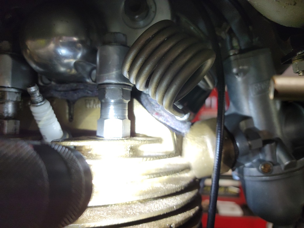

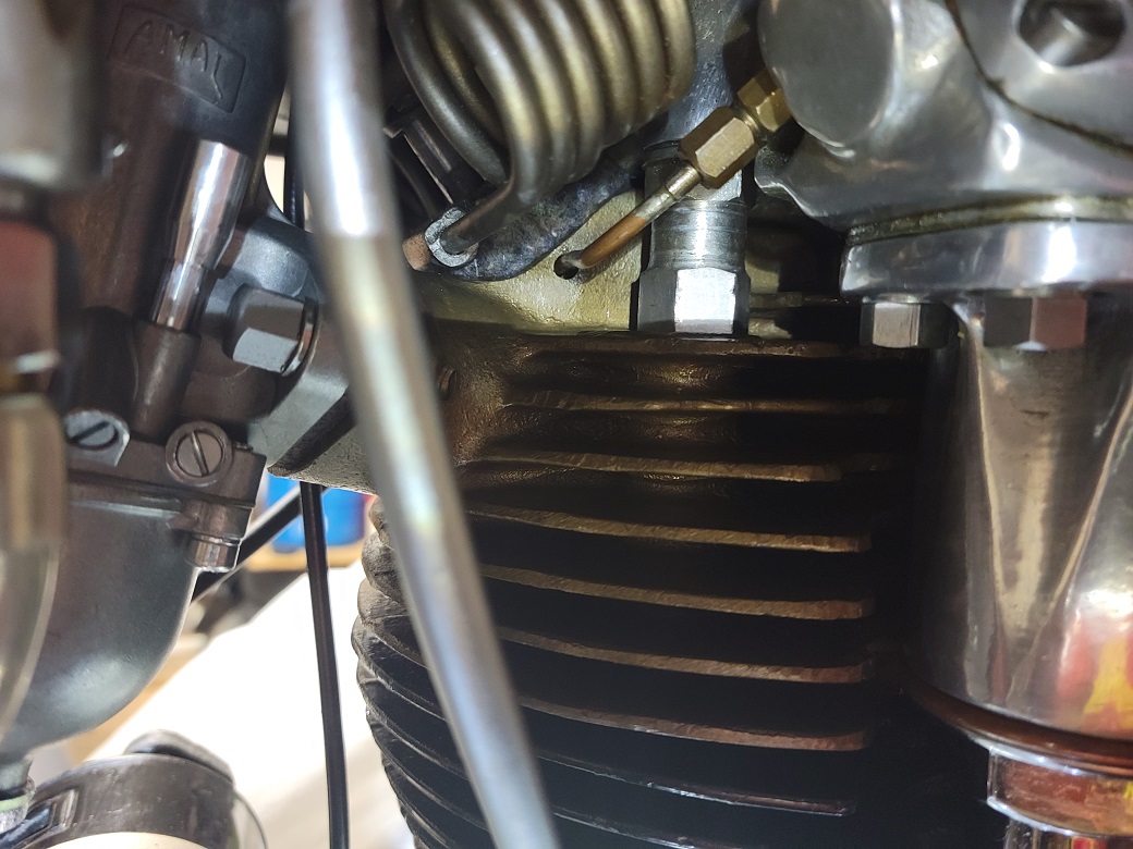

Update on control of oil leaking
Although I've been working a lot since my last post that I logged 12 miles on the International, in the mean time I cut a 4x2 inch pad from some high-absorbent fabric, folded it in half and tucked it under the cam box as you can see in the pictures.
This evening I took the bike out for a 6 mile run, speeds of 50 mph, and upon parking the machine there was no oil on the outer front half of the primary cover. Hopefully these 6 miles was sufficient mileage to rule out that the this high-absorbent fabric halted the oil deluge pictured in my earlier post... (My test rides are limited as I am reluctant to ride much out of my neighborhood area because as yet I have no paperwork for the machine; I am waiting on receiving registration and license plate which is another story of no import to you fine fellows living "across the pond.")
Upon closer inspection, after the 6 miles, it was quite evident that there is obvious oil leakage at the site where the A11/778 "valve guide lubrication pipe" enters the small hole intended to lubricate the valve guide. This leakage travels on both sides of the intake valve area on to cyl.head fins, etc. So, I cut 1/2" wide strip of the high-absorbent fabric and stuffed it around the circumference of the inlet valve stem area; hopefully this strip should help better determine how much oil is coming out the area where the "lubrication pipe" inserts to feed the valve guide and stem.
There appears to be no oil leakage on the exhaust "valve guide lubrication pipe."
As I type this, I am looking at Schoen's book and the factory parts book, but cannot visualize where the end of the "lubrication pipe" would meet up with the valve guide so I can better understand how the end of the pipe fits into what it fits into... (I am assuming there might be a hole in the valve guide that the end of the "lubrication pipe" feeds into...?) (attached is a picture to show this "valve guide lubrication pipe" I am referencing).
So, my questions are these: "What does the end of the "valve guide lubrication pipe" fit in to?" Is it common to experience an oil leak at the site of where these pipes enter the head?
Even after cutting the leather washer to help stem the flow from the Tell Tale, i still have more oil leaking from it than i would like, but the leather washer has fairly significantly slowed the flow.
In closing, the Concentric Premier offers excellent starting and idling characteristics and steady acceleration through all throttle valve openings. The engine pulls strong. The gear box shifts deliberate and positive. Compared to other pre-unit singles I have owned, the kick start gear ratio seems to be such that there is not a whole lot of cranking speed when firmly stepping down full weight on the kick lever. Thank goodness the engine starts on the 1st or 2nd kick. At some point, I am going to measure the compression psi; the amount of compression is very strong. Overall performance is thrilling.
Progress..
OK; the feed pipes are a snug fit into the head, you seems to have a large hole on the inlet side. The pipes are often swaged to a taper to fit. Its reputed that the exhaust feed often blocks off with carbon as the oil burns, but I have not had that experience to date. They do come out for a clean now and then.
Test that the depth and diameter of the hole reaches through the guide to the valve stem, it may only be oversized for a short distance to put an "O" ring into?
QUICK TEST would be to run with the pipes capped off... It will not cause harm on 12 mile run...
For correctional work you can:
Mod the pipe with a soldered sleeve over that will fit into the hole.
Try a mini "O" ring to seal the pipe in position
Make up an aluminium slug to fill the hole and re drill to the correct size. (It may not be [hope] through the valve guide at that larger diameter). If it is; Valve out job).

...for your illuminating reply. Needless to say, the intake pipe is not a snug fit at all. Knowing that the pipes were a taper fit helps alot.
I can silver solder to make the built up area around the circumference of the pipe a solid interference fit.... If i understand correctly, there is first the larger hole in the head followed by a smaller hole in the guide... Am i of the correct understanding? The hole in the head does not look large enough to accommodate an O-ring, but i will more carefully visualize what i am looking at.
I can see clear in to the valve stem, will need to try to visualize if the hole in the guide is smaller. What i do know is that the pipe goes in quite a distance, i am guessing nearly right up to the stem... i suppose if I built up with solder around the circumference of the pipe where it enters the hole in the head that would provide the seal i want...? or does that taper fit into guide hole...? Does one place or the other matter...? I'm too chicken to do any drilling of the head, will implement conservative approaches first...

Valve guide oil feeds
Steve, in my experience the pipes seal into the head casting, not the guide. A small dab of sealant back from the open end of the swaged pipe to seal on to the casting stops them dribbling and leaves them removable to clean through occasionally. An increase in OD with silver solder should do the trick. Just remember to clean out the inside of the pipe after heating.
The hole you have in the cylinder head is not standard; so the fit of the pipe is now bespoke to your engineering skills. If its a parallel hole then a parallel pipe would fit well. I would stop it just short of full depth of the drilling towards the guide so there is a small plenum there, any misalignment between pipe end and guide drilling will be negated.

...for your comments which further clarify what I am addressing. The other day when i was cleaning off the oil from the machine, i decided to smear some Permatex Ultra Grey on the circumference of the pipe where it enters the head in an attempt to see if this might stop the flow of oil on to the outside of the head. I'll be pleasantly surprised if this is a long term solution, but will at least will get to see what the smear job might do... Right now it is rather warm here... the past few days upper 90'sF/35C (tomorrow forecast 101F/38C) so i am reluctant to run a freshly rebuilt engine in this heat... Here is what Permatex ultra Grey is >>> https://www.permatex.com/products/gasketing/ultra-series-gasket-makers/permatex-ultra-grey-rigid-high-torque-rtv-silicone-gasket-maker-2/

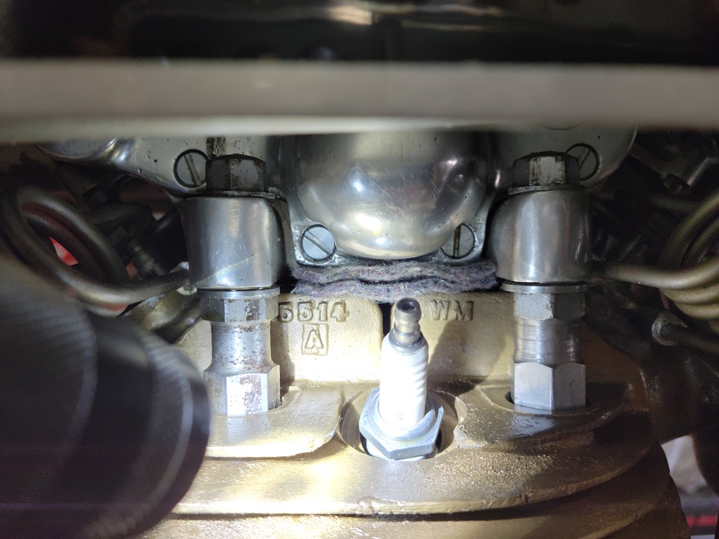

Best thing is to smear the Permatex and leave it to cure whilst the external heat is on. Time for a blast on a big Enfield??
Interesting to see if the hole on the exhaust side is the same size as the inlet feed.
Thanks for Carb tips. I suffer a bit on the overrun, firing in the exhaust occasionally.
With your felt pads and new control on the valve feeds you should be able to see masked sources of oil emission, or…. You may have cured the problem.
if the tell tale is still weeping you can have the one I showed separated in the photos for reworking / experimenting.

My valve guide oil feed…
My valve guide oil feed pipes were fitted by a UK expert. They seem to pass through a hole in a cooling fins, emerge from that and then jam into holes in the head leading to the valve guide. They were then glued in place with black silicone sealant! As you are finding, it's not easy to work out where oil comes from. Racers were happy with accessible valve springs, and didn't worry about leaks. Rocker leaks are usually blamed on the wipers above and below the rockers, but allegedly commonly come from the sides.
I'm afraid I just carry a rag and wipe it down when I stop. With castor oil, although it's much more stable than in the 'Good Old Days' it still lacquers itself where it lands on hot surfaces...especially the exhaust.

...I removed the pipe, it is open. I should have said there is a very slight film of oil around the opening; i am so used to profuse leaking, to me this was nothing in comparison.
However, the oil getting to the exhaust does appear negligible.

The feed tube first goes…
The feed tube first goes through an oversize hole in a fin and then enters a matching size hole in the head. If it has pulled out of the hole on the head, the fault might not be visible. The tubes start from the bottom corners of the cam box. I think they are visible when the cover is removed but I can't remember now. I've read that they can block. I might even try to investigate mine shortly. It's a bit like key hole surgery. I'm using castor oil so it's a bit like the bottom of a cooker in a fast fried food kitchen up there. I suspect the only way to clean it would be with caustic oven cleaner!
My knowlege of camshaft…
My knowlege of camshaft Nortons could be written on a fag paper. Common physics tells me that if you deliver oil to an area thats under any pressure above atmospherics , its going to blow out if it can. So if its not leaking from an open hole then its either not getting any significant flow, or if there is flow its going into an area not pressurised by the engine and there is another easy escape path. ( open valve spring chamber).If its going to a valve guide very very little would be needed anyway . Perhaps with the gay abandon that a cammy Norton throws oil everywhere the little it gets and leaks was not thought a worry.Valves and guides were expected to be replaced on a regular basis in a competition engine. An alien thought to us now.
With you there Robert...
...the feed is normally minimal and is only there to wet the face of the valve stem. Steve seems to have an oiling issue that may be exceptionally bad or just not what is expected. I would have no hesitation in a trail with the feeds caped off to see if they are an issue. It does seem to blow out somewhere witnessed by the pool on top of the primary covers.
My feeling is that he is still experiencing a high delivery pressure to the top end and its bleeding heavily. But methodically and accurately; he is eliminating issues until it will be the cleanest Cammy motor out there.

A solution to Steve's…
A solution to Steve's mysterious oil pool on front of primary chain case! I've just been cleaning up after my wet Sunday ride, and I see splashes on the front of the chain case. The solution is to look up! The oil is falling down vertically from tbe left edge of the recess in the bottom of the fuel tank. Oil escapes from exhaust rocker (left front of course), and some splashes up under the tank. Then, in the shed standing still, the oil falls straight down onto the chain case.
It doesn't happen on the right, because it's only the left side of the tank recess above the rocker.
But it also drops more on the right rear, from the inlet.
Good spot Dave...
... Any source that throws the golden syrup up onto the tank and migrates under Newtons law to the top of the chain case is pretty severe, even by Norton cammy standards...
More felt Steve !!

Attached is a picture of the old fellow napping at roadside's edge.

...oh my gawd do i ever have an oil leak all down the front area of the "Oil Bath" outer primary cover; to be honest, i was rather surprised. I have not looked closely for the source, but i can't imagine it is coming from the cam or either of the valve areas.
The exhaust valve area leak is what i would describe as minor; the intake area has a fair amount but nothing that i find objectionable or at least yet. The head and cylinder fins are anywhere from dry to a film; there is not oil dripping from the fins anywhere.
Before i went for the ride, I filled the primary case until oil quit running out of the threaded plug below the foot rest. Perhaps this is too much...?
This is the only International I've ever been associated with; surely this leak is not the norm for the "Oil Bath" primary case... As i have never had the inner primary cover off, I cannot visualize the hole the inner cover has for the drive shaft to pass through; so wondering if this could be where oil is leaking through...? Would seem perhaps at least somewhat doubtful, as the outside of crankcase appears dry... Or is the oil coming from another source...? Attached is a picture of the primary; I am looking forward to hearing your thoughts as to the source of this leak; surely there is a way to stem the tide...
The few times i've had it running for 2-3 minutes and a couple other times for no longer than 10 minutes with fan blowing on engine i've not witnessed oil on the cover... But then i did not have oil in the case.
So perhaps oil in the case should be at a level barely touching or just below the chain's underside as it moves along with the clutch sprocket...?
