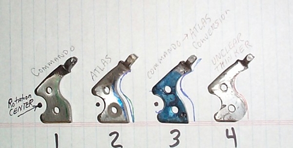

I am currently rebuilding a late 1966 Atlas, the clutch lever takes considerable amount of pressure to use, considerably more than my other bikes which include a 1967 650SS, 1957 ES2 [both of which have a similar clutch] or my 1969 Fastback. The Atlas has a brand new drum [RGM] 7/8 lever pivot, I have purchased new springs [no difference], my cable is new and routed the same as my 650SS, I am now looking at the gearbox end and note the activating arm is different between Dommy 04-0029 and Commando 06-0715, has anybody tried a Commando arm or haver any other suggestions?
Not tried the Commando type as I'm told that the Commando clutch need more travel and less force. Hence the different different lever. So the 06-0715 will make the Atlas clutch even harder to operate. If you have a lever with what RGM calls a fulcrum distance of 7/8 you can skip the rest of my post. Handlebar levers come with different pivot centre to cable nipple centre distance. A longer distance makes the clutch harder to operate. I suggest that you measure it on your on your bikes. As discussed in a recent thread, the laydown gearbox has less travel than the AMC box making it problematic to use a Commando clutch. I've also noticed that there is a number of different clutch springs. I have a similar problem with the Manx, which has the original handlebar with welded on levers. Probably made for the laydown box. With a TTI gearbox which has quite long clutch travel, the clutch is hard to operate. Very tiring after a couple of laps.
Reprofiling the gearbox lever helps. there is a detail showing the area to be eased. There are some rogue clutch springs being sold (too thick/stiff) and it takes a micrometer to identify the bad ones . I have cheated a little and drilled a hole thro the oil tank support and gearbox plates  to give a better run for the cable, This being on a deluxe so I can perpitrate such horrors under the panels!!. Just one of many. Dare not let anyone see the spaghetti wiring and breather plumbing.

In your post you mention that; “Reprofiling the gearbox lever helps. there is a detail showing the area to be eased”.
Do you have any info on exactly what needs to be done to the gearbox lever to ‘reprofile’ it?
That's more or less it,  A bit of work with a file and oilstone to make the action more gradual

Thanks guys for your assistance, I have reprofiled the activating arm and tidied up the rollers, I will re assemble check the cable and hope for the best otherwise it will be remove the primary cover and recheck springs & cups [again].
