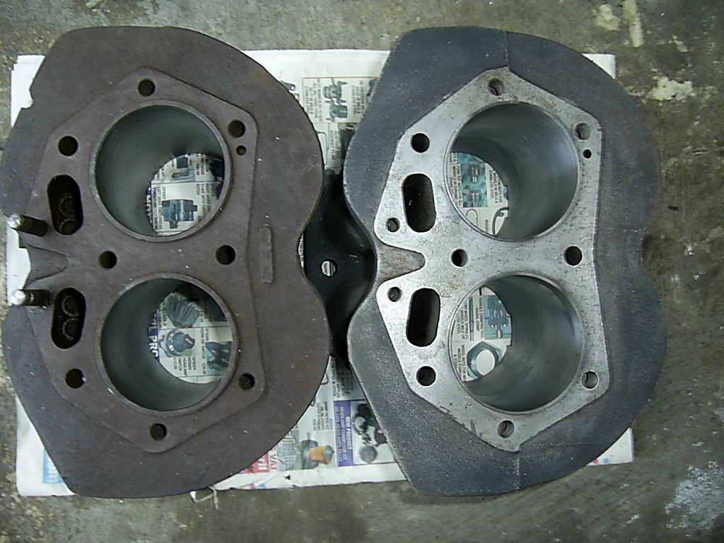

Checkout the attached photo of 88 & 99 barrels together. Both are on plus 30 thou. I'll let you decide which is the 88 barrel.

The 88 and 99 cylinders might look the same on top, but I have a set of alternator Model 99 cylinders that have more material on the bottom where the sleeves go down into the crankcases, and just like 650cc cylinders they have the heavier reliefs where the base bolts need clearance to screw on. I do not have a generator Model 99 cylinder to see what it looks like.
The late Model 88 cylinders for alternator bikes, even the one on the 1962 88ss I have, has no improvements over early generator cylinders in thickness anywhere that I can see.
So we need someone to compare the bottom of generator 88 and 99 cylinders so we can see if the 600cc bikes always had reinforcements, or if they started off with weaker cylinders than the later Model 99 had.
Of course the 650cc cylinder had the re-shaped fins on it's front side, but other than that it does not appear any stronger than the alternator 99 cylinder I have. Bracebridge Street kept separate part#s for the 99 and 650, later after AMC shut down the Norton works, the 1964 parts book lists the same cylinder part# for both 650cc and Model 99.
So in the case of the alternator cylinders anyway, I can say that a 500cc cylinder would be weaker than a 600cc cylinder when bored out to 68mm.
