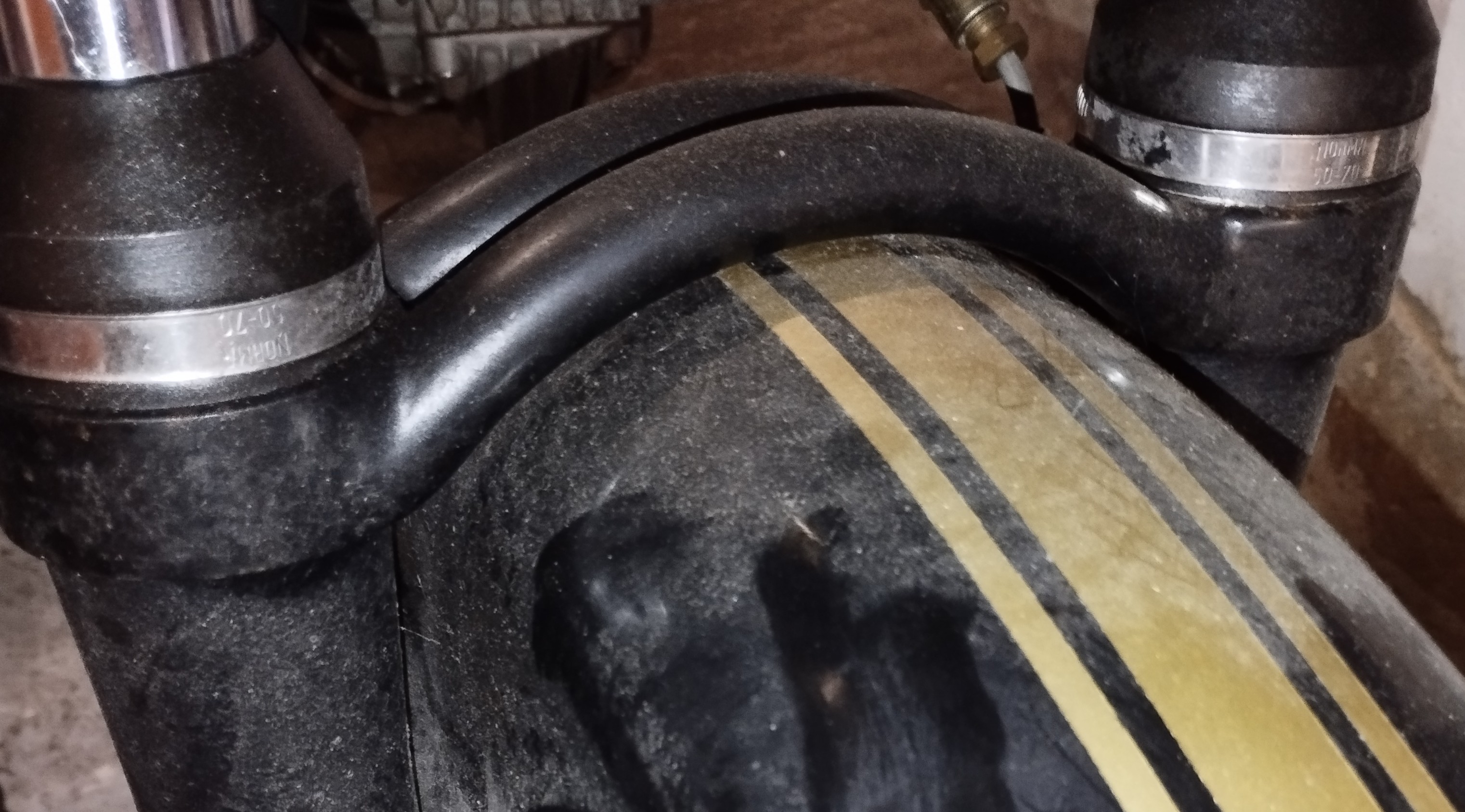

Just seen this and thought I would chime in.
Hyde fork braces are brilliant but not available these days. I have had one on my 750 for many years and it makes heavy braking with a single disc and enjoyable thing.
Fastec currently off two kinds neither of which are much use. I have tried both. Even the deep kind which requires a lot of mudguard reforming - and it looks naff.
But they have been very keen to produce one. I've have been working with them to perfect the shape of their bolt on kind (pictured above) and the first is nearing production. I also leant them my Hyde fork brace and I believe they are going to produce on along these lines.
The Hyde fork brace requires removal of the forks to fit and it can take quite a few goes to find the sweet point where everything is nicely aligned. The Fastec kind should be a straight forward bolt on but will never look quite as sexy!

Hi After fitting a RGM…
Hi After fitting a RGM brake upgrade kit my bike braked really well however it pulled slightly to one side so I started looking for a fork brace , Norman Hyde ones are almost impossible to find even second hand and RGM no longer make one. Though it appears from what I have read it was not ver good . so I tried the link above but it no longer works so I used Google image search and it came up with the same Brace at the British Fork Brace Company. I contacted them and yes they have made them even though not an option on there Web page, mainly due to the many differences in Commando front end mudguards , so they sent me 3 x Technical drawings for ones they had made in the past and I made a template and picked the correct one. It is now fitted and the bike no longer pulls to one side , they were a pleasure to deal with and I recommend them . Pictures below
