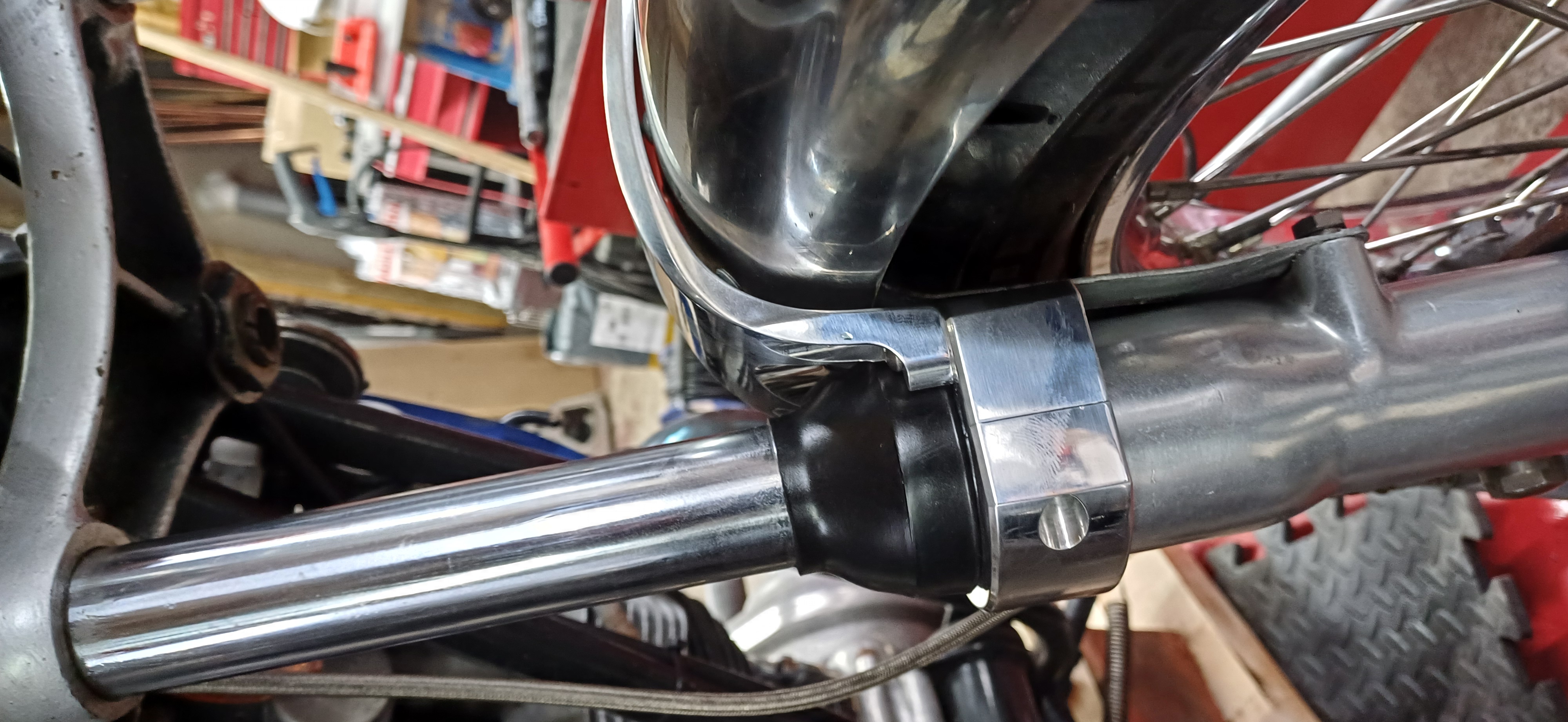

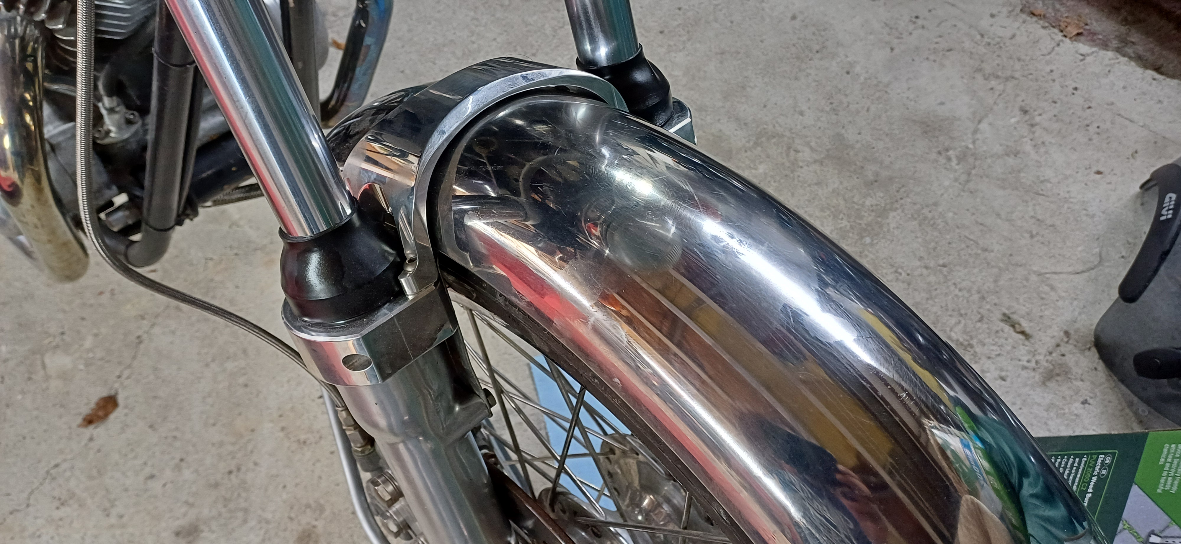

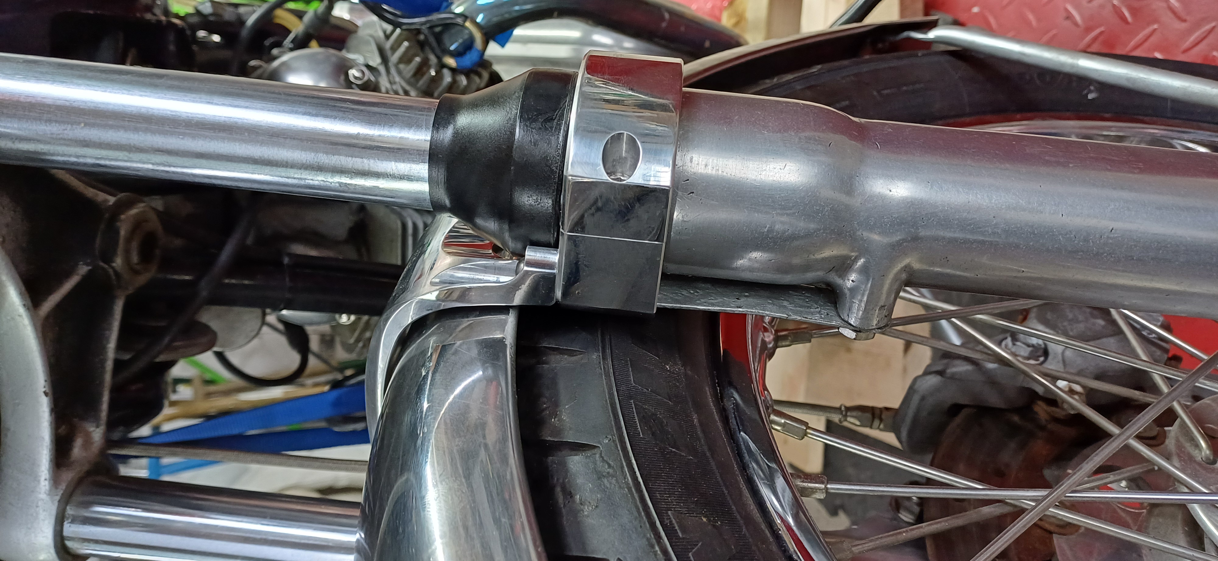

Hi  After fitting a RGM brake upgrade kit my bike braked really well however it pulled slightly to one side so I started looking for a fork brace , Norman Hyde ones are almost impossible to find even second hand and RGM no longer make one. Though it appears from what I have read it was not ver good . so I tried the link above but it no longer works so I used Google image search and it  came up with the same Brace at the British Fork Brace Company. I contacted them and yes they have made them even though not an option on there Web page, mainly due to the many differences in Commando front end mudguards , so they sent me 3 x Technical drawings for ones they had made in the past and I made a template and picked the correct one.  It is now fitted and the bike no longer pulls to one side , they were a pleasure to deal with and I recommend them . Pictures below
https://www.thebritishforkbracecompany.com/?syclid=edb94eec-b1f3-4f3f-a032-e231c2cf8433Fitted
John
That British fork brace looks good, but without a mudguard do you thing there's room for a 21" front wheel?
