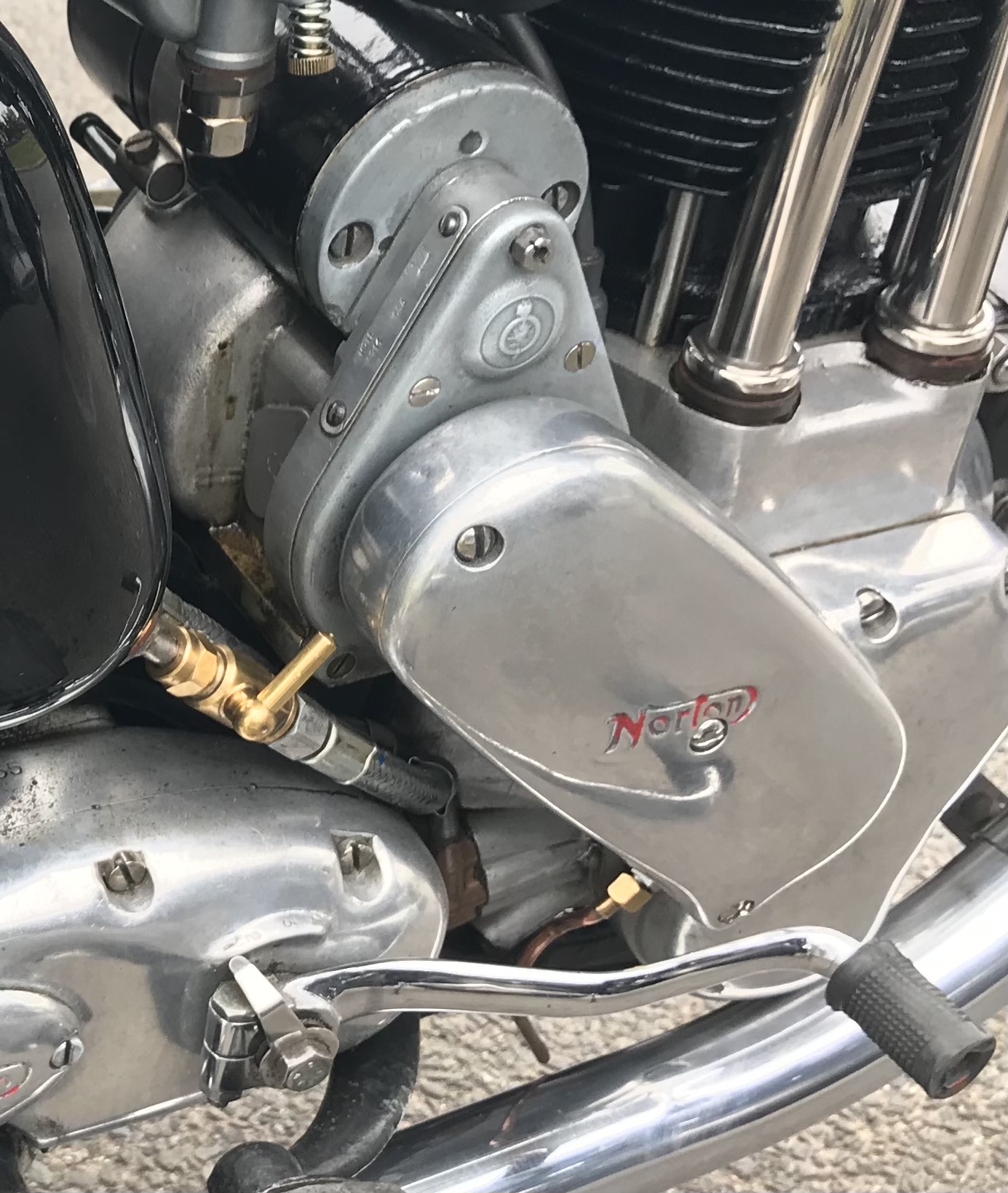

I'll go for the Kingpin version for my Mk3 Commando which emptied the whole oil tank over lockdown, a fair amount of which then migrated to the primary chain case and onto the floor (I have a belt drive so the chain case is permanently open at the bottom).  Does anyone have a photograph of their installation on a Commando and type of fitting used, please.
