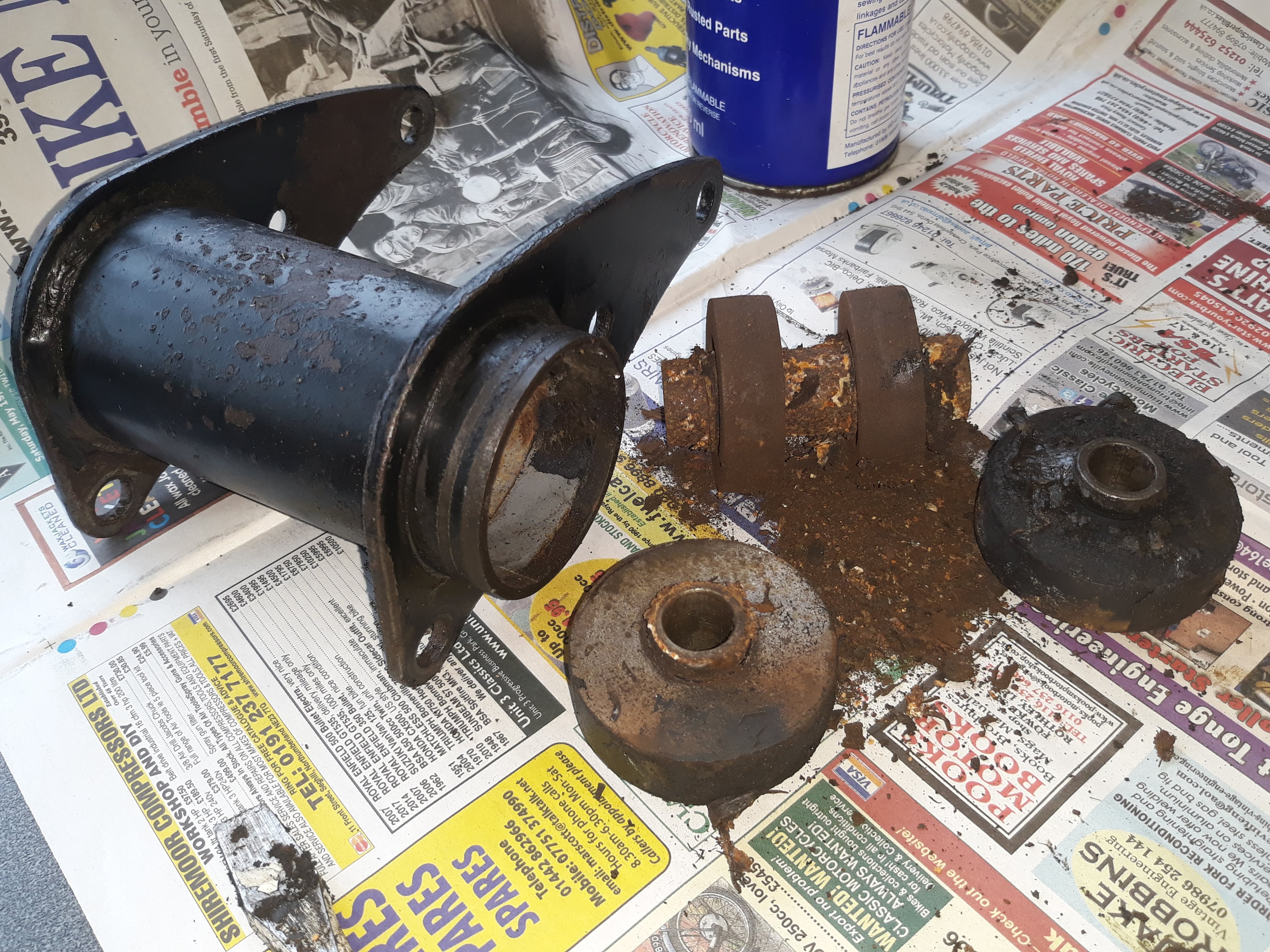

Mine looked like this when taken apart
Isolastic mounts
