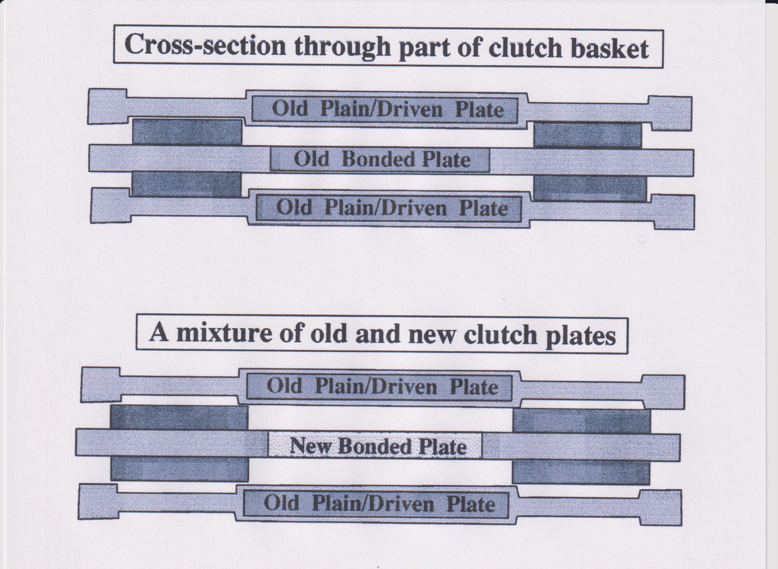

A BIG mistake, often made by owners, is to pull all of the plates out of the clutch basket and give them a cleaning. Then they mix them all up before replacing back in the basket. This will almost certainly lead to the clutch slipping while respective driver and driven plates bed back in with each other.  This applies to both Commando and AMC clutches and will also happen if old and new plates are mixed.  See Dominator clutch diagram for explanation.
