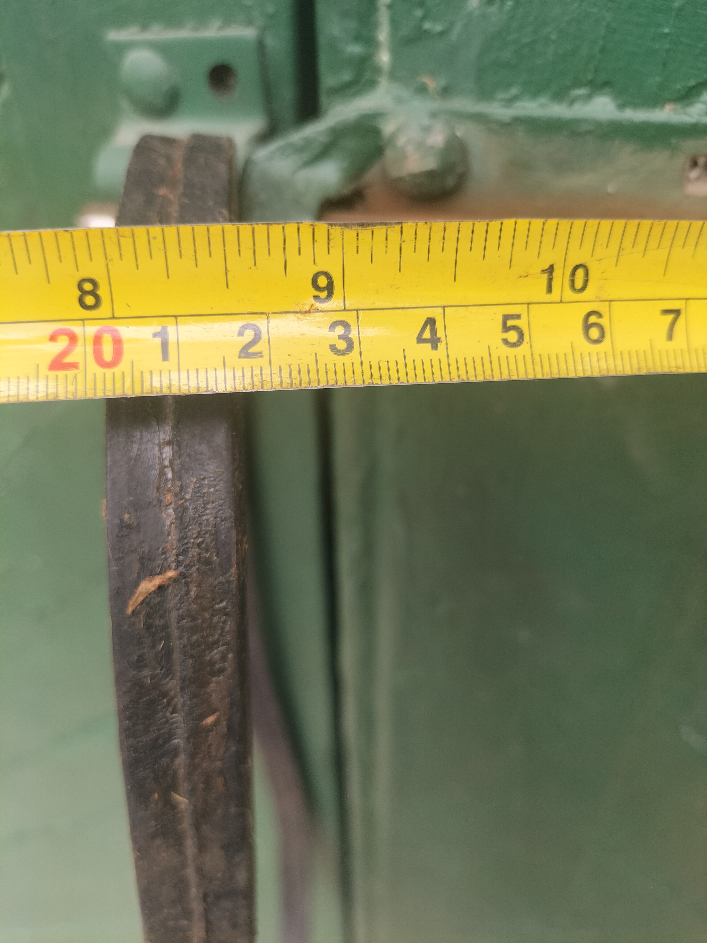

I am nearing the end of restoring a '47 Inter model 30. The only rubber seals for the primary case that I seem to be able to find are the ones supplied by the club, RGM and Andover Norton, measuring approximately 9mm thick and 24 mm wide. There is absolutely no way that the outer primary case will fit with these seals. I need something thinner and narrower. Can anyone point me in the direction of where to find a suitable seal?

Thanks for your input Jonathan. The mating faces of both inner & outer case - joddle, as you call it, only measure 7/8" across - so a bit narrower than the rubber. Also none of the three rubber seals that I have is radiused. Cross section is rectangular. They aren't that old and don't seem too hard, but are definitely reluctant to compress. I can only get the nut on by two threads and only by using a plain flat washer - not the proper one.

... it is probably stock "rubber". The chamfer is important to get the fit in the "joddle" of the cover. I think my approach would be to cut the rubber, lay it out on a bench and sand the edge to the profile of the cover. It needs to be pretty consistent profile, (disk sander and a distance piece to control the shape would help). Once complete, superglue the ends back together.

The early models had a narrower width seal than the slimline models. The width is 16mm with a 1 in 20 taper from one edge to the other.
I have used this seal on my plunger framed bikes (Model 7 and ES2) and also on my WD bikes and the outer chaincase fits easily and the nut tightens to show about 2 threads on the spacer.
Howard, I have just done a trial assembly on my 1949 Inter with similar results.
