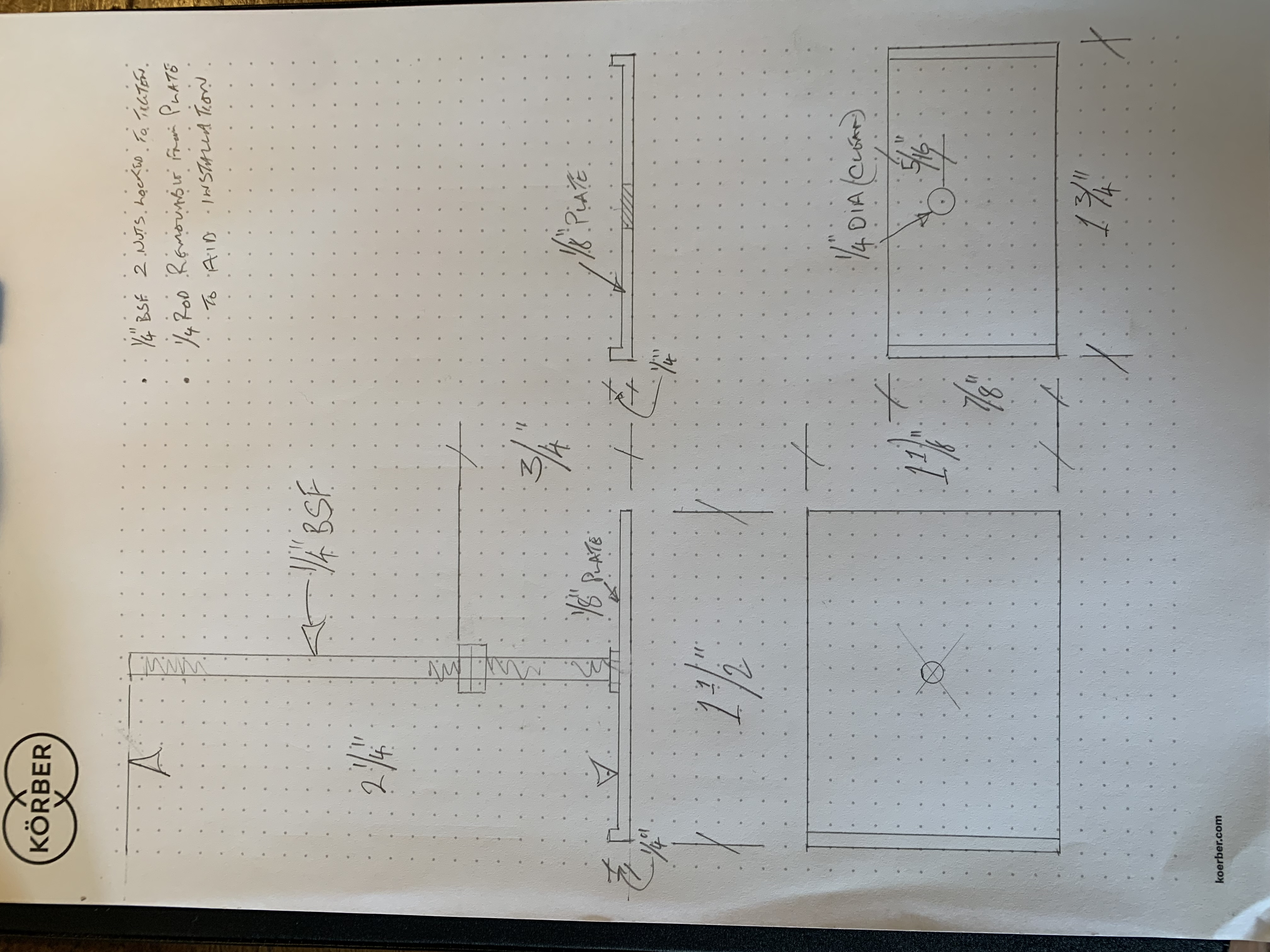

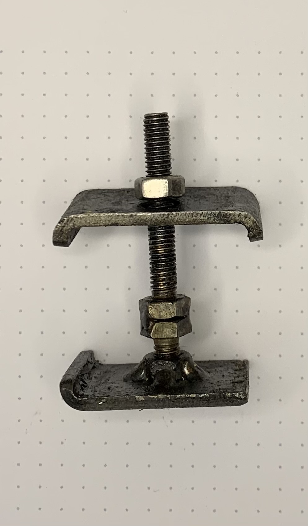

As I know it Fred. You will have to look for similars from other machines. I assume the valve guide has got the provision to hold the seal in place? With regard to the spring tongs, don't see them too often and quite pricey.  For the non professional a simple pair of plates with a bolt through the centre to pull the ends of the spring together is sufficient for home use.  I will supply you with details if your up for making some.

I've used this during my 20 years of cammy ownership. Works fine as you can adjust its fit rather than the tongs. I have access to tongs but  feel they are better suited to track side  replacement.  I can sketch up and provide dimensions if you need.

Here you are Fred. If you are in the UK I could post them to you.
