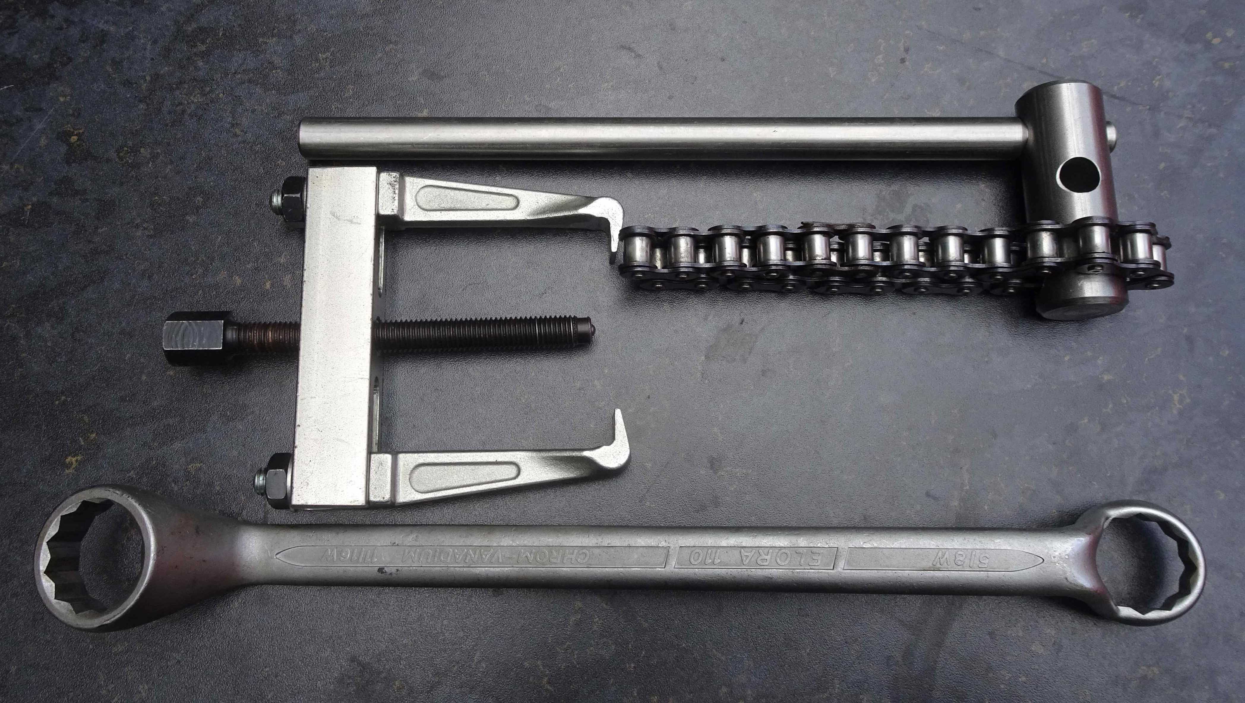

I use a home made chain wrench to hold the sprocket, and a large ring spanner. Like John no tab washer. No torque wrench either.
Chain wrench
... made of a bit of scrap alloy or mild steel with the edges rounded off. Like this:
sorag
Obviously this is for tightening - the same can be used for slackening but with the sprag pointing the other way. A much kinder way to ttreat your Norton rather than wedging things in the spokes.....

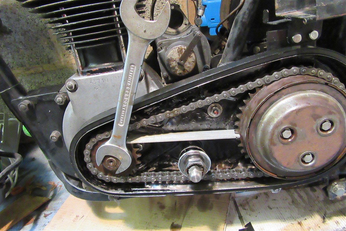

Hi Howard,
         to save any adverse strain on any part of the bike I tap the sprocket onto the main-shaft using an suitable size tube and hammer, remembering not to use excessive force. I then use a smear of Loctite on the threads and tighten the nut against compression with-out the chain with a ring spanner and then use a heavy hammer to clout the spanner several times to shock it tight. This may seem a little crude, but is no different to using a pneumatic hammer gun as used (to excess ?) on car wheel nuts. Electric versions of these are available and should be powerful enough for 80 ft/lbs. If the nut was to come loose I don't think a lock tab would be strong enough to stop it.
Thanks very much to all four of you for your insightful responses.  I like that none of them rely on the primary chain and/or final drive to hold the sprocket as I wanted to avoid putting any undue stress on chains.
The gearbox sprocket nut and the oil pump worm are left-hand.
