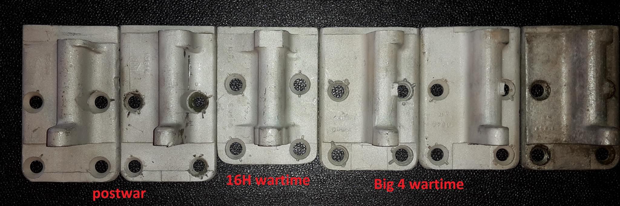

There is a magneto platform on the NOC Shop (see C2/117) in the Electrical section.  Or C2/117A has the mag mounting screw as well.
To lock the magneto in position when the chain is tensioned there is a lock bolt under the drive end, which tightens onto the engine plate.  This is a fine thread, 26TPI cycle if I remember correctly, and can easily be stripped in the aluminium base.  I converted mine to a fine metric thread so that I could use an Allen screw (domed head) for this locking bolt as it is so much easier to tighten.
