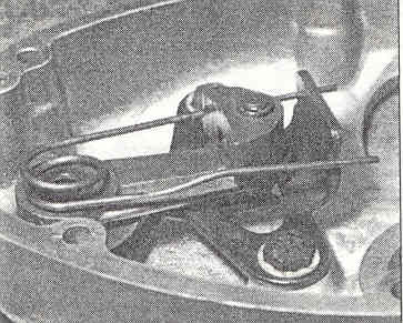

Gear changes heading one way but not the other are often a sign of one of the two selector springs needing changing.
They both sit on top of each other inside the gearbox by the Gearbox Selector Quadrant.
The thin selector arm can go weak, distort or may have been incorrectly fitted.
The chunkier Return Spring is prone to cracking or even breaking apart.
My money would go on the latter.
Return Spring
