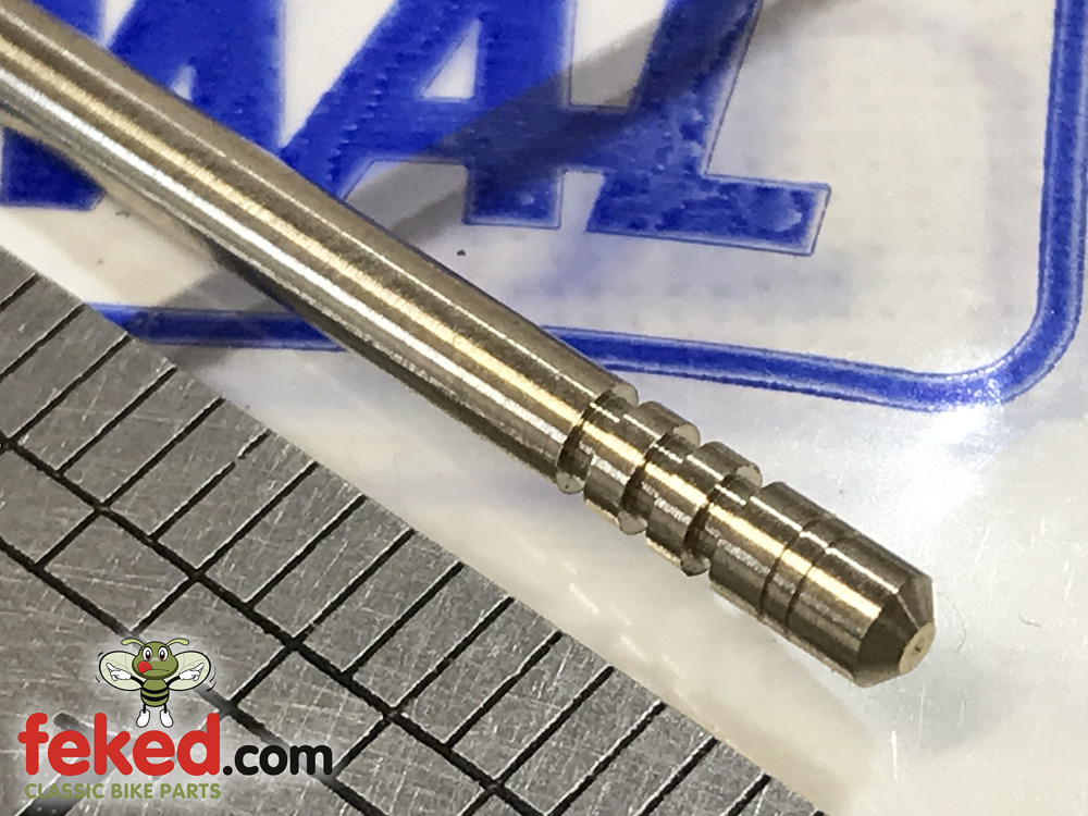

On closer inspection I see that the carb is fitted with a stepped spray-tube and a 4-ring needle, which would single it out as being meant for a 850 Commando rather than a replacement for the old  Monoblocs on my 750 Atlas.
There are opposing opinions as to the advantages of the stepped spray-tube. Some say it improves low-end performance on any machine, others knock it out and replace with a flat-top as a matter of course.
Should I fit the carb and give it a try, or convert to standard 4-stroke with a new spray-tube and 2-ring needle?
The actual rings in the needle is NOT crucial, that is purely for adjustment. What is crucial is the taper on the needle, this will be signified by the number of the needle.
With regard to the spray tube I also am listening to see what/how it affects things?
AHA! Now I am informed, When the mention of rings I assumed (wrongly) this was the circlip rings! But the taper is the crucial bit in all this and of course if you get the right 'paper work' you will be able to see the taper with relation to the 'rings'. Thanks Michael.
