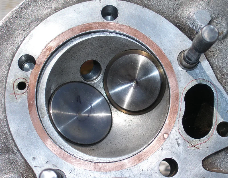

sounds an odd choice for head gaskets as it doesn't mention heat resistance (but does say thermosetting). I always fit head gaskets with a very thin coat of Wellseal. I used this on my Commando with well annealed solid copper head gasket and it was fine.
https://www.youtube.com/watch?v=TUnQg2TNWHQ&t= but I was going to try and make some 0.003" copper head gasket rings as JSmotorsport sell
Using copper wire as a head gasket (2015)
