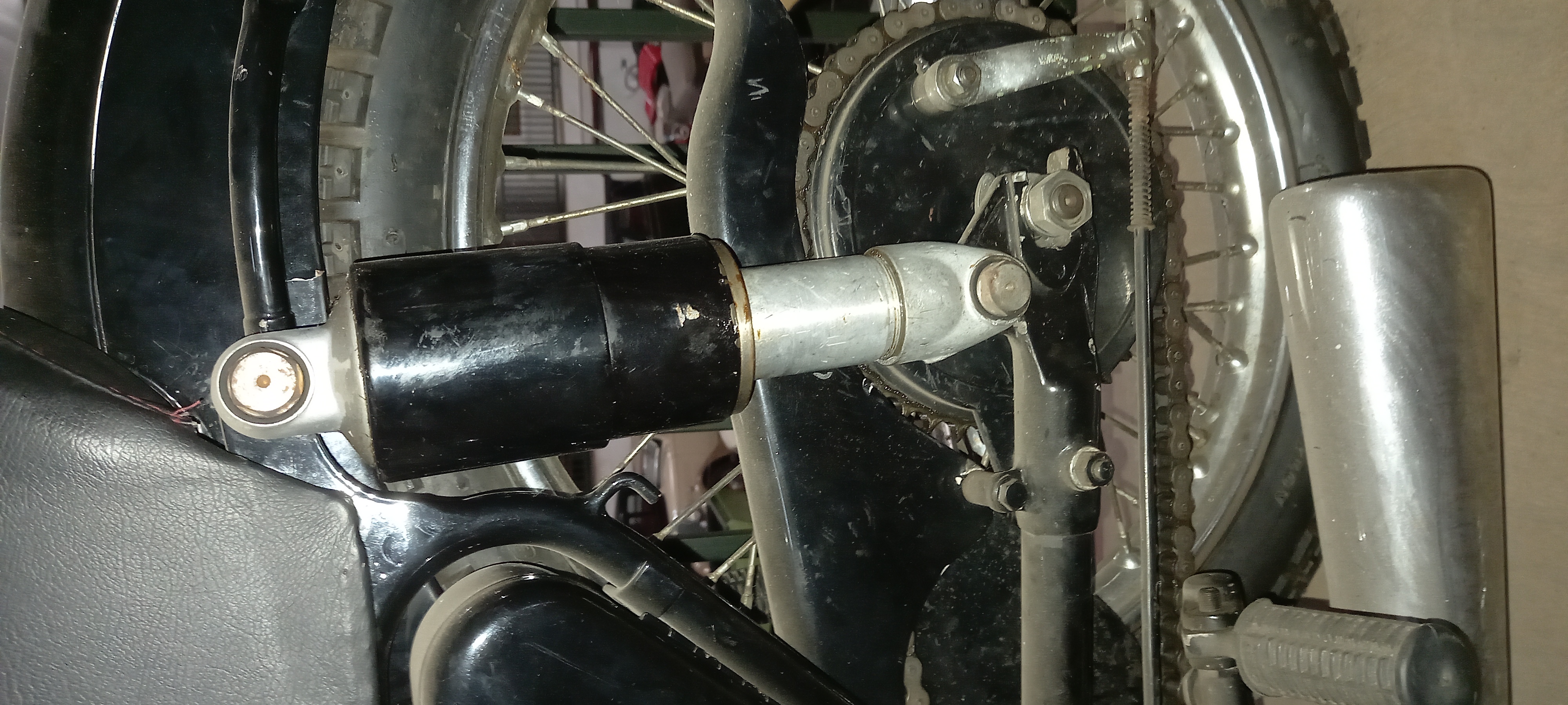

A Dominator I am rebuilding came with rear shocks shown in the picture. At 70mm diameter they are too wide and foul the mudguard.
Dimensions are 11" x 2-3/4" shroud diameter.
Does anyone know what they come from?

I don't know if it's lens distortion on the photo but they look a bit like jampots from AJS and Matchless models from around 1956.
... jampots as well but those have a clevis lower mounting.

These 2-3/4" items that came with the rebuild bits are too wide, they foul the mudguard.
I've been told they aren't Jampots, see photo of a Jampot attached.

You don't mention which model year you have, but pre-1956 models had Armstrong rear shocks, which were a little larger in diameter than the later Girlings. They tended to have a chrome lower spring cover with a knurled ring, which yours do not have; but not all did.

I have just measured a set of Armstrongs I have; not off a Norton; and the top shrouds are 2 1/2" diameter, so 1/4" shy of yours, which makes all the difference, obviously.
My guess is they are not off a British bike, possible off a European manufacturer, so you could have your work cut out identifying them.
