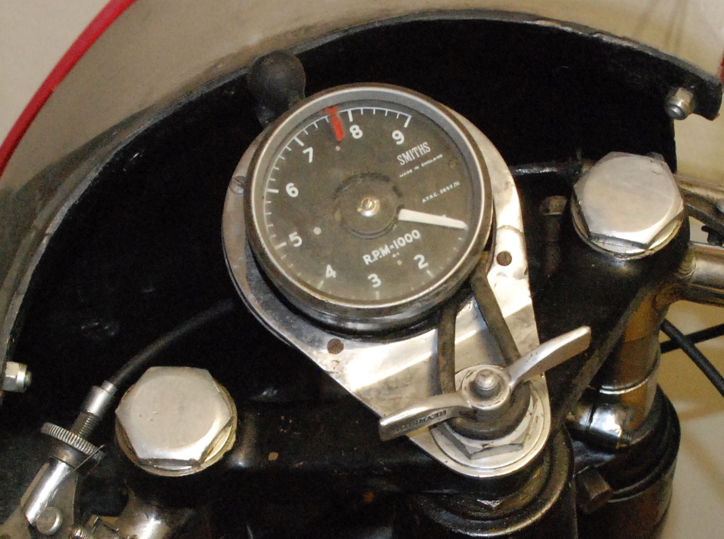

-59 Manx rev counter
Hello again Bob - I got a really good copy of the ATRC from Andy Molnar for my Manx, with mount and cable and they suit Smiths spec stuff .   They are excellent reproductions and new movements so it's worth a punt. Let me know if you need an image or two.  Regards, Howard

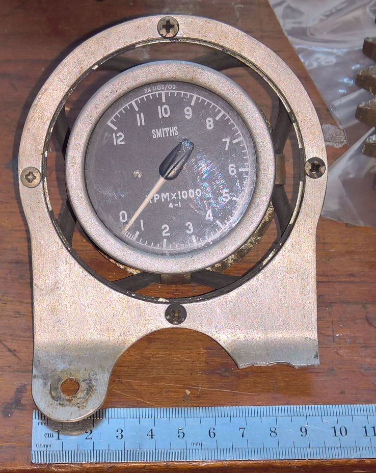

12,000 RPM ! No idea what it would have been fitted to. Came with a box of Commando parts from a sidecar crew.

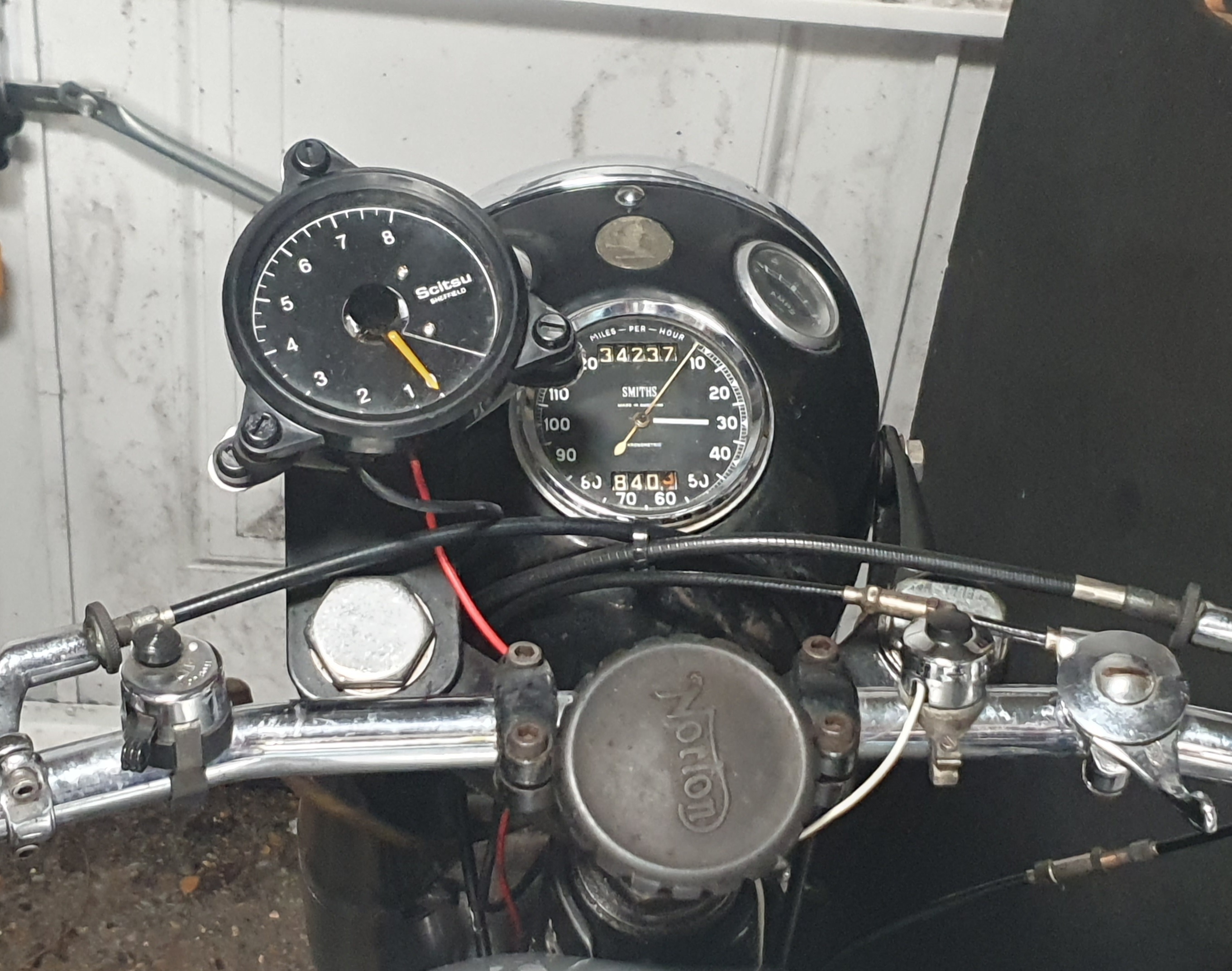

I have a Skitsu on the Dommie.  This had a single trigger per rev from a wire wound a few turns round one plug lead, for lost spark electronic ignition.  When I returned to magneto, I extended the wire round the other lead.

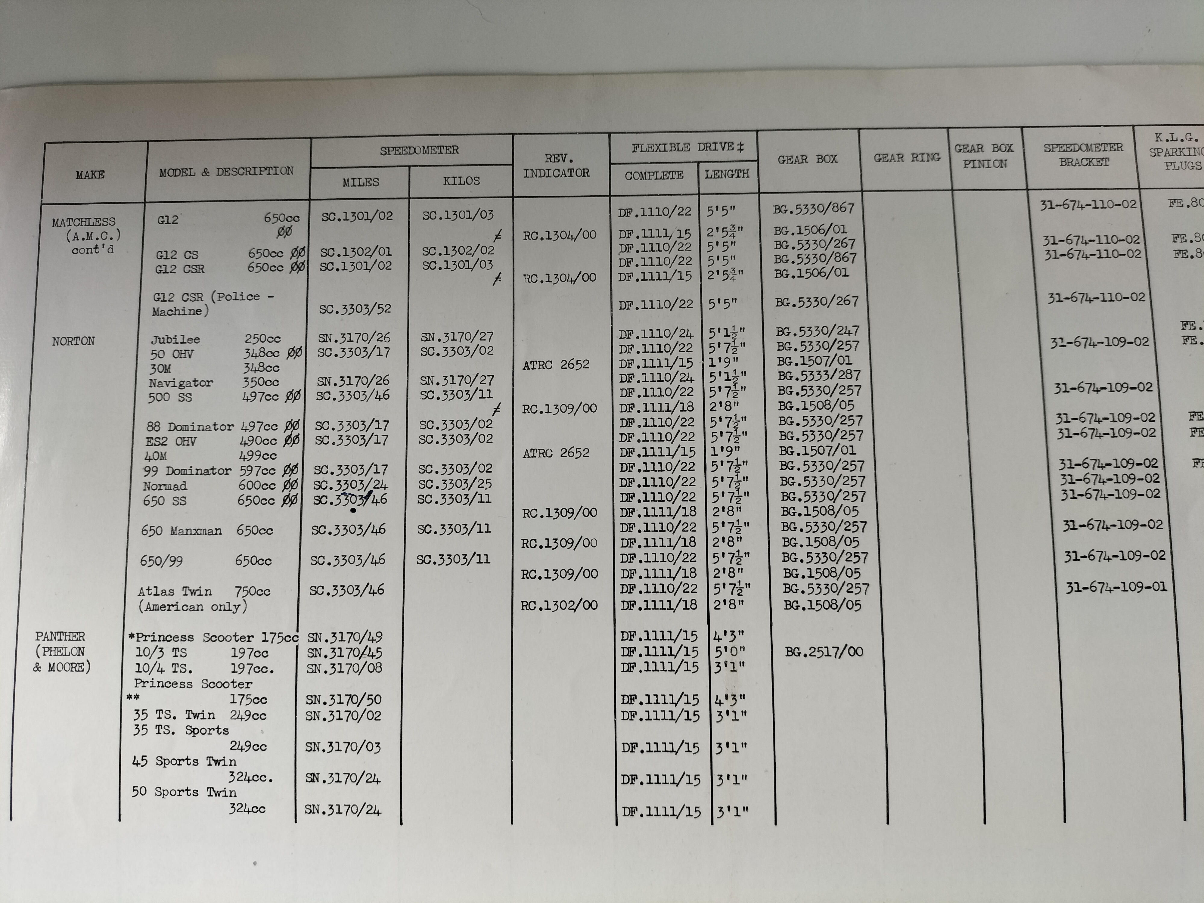

Today stumbled on a nice chronometric tacho lying in the workshop. Marked RC1309/00. Seems I had tested it and a note says it's quite accurate and 2:1 ratio. Anybody knows if it is for a Dommie?
Yes 1309/00 is correct for a 1963 Dommi.
Gearbox is listed as BG.1508/05
See attached photo from 1963 Smith's catalogue.
Thankyou for posting that Mikael, its very helpfull.  My 1963 SS  has been fitted with later Magnetic   instruments  which I will attempt to swap for the correct items . I am interested in finding out when the 150 speedo came into use.

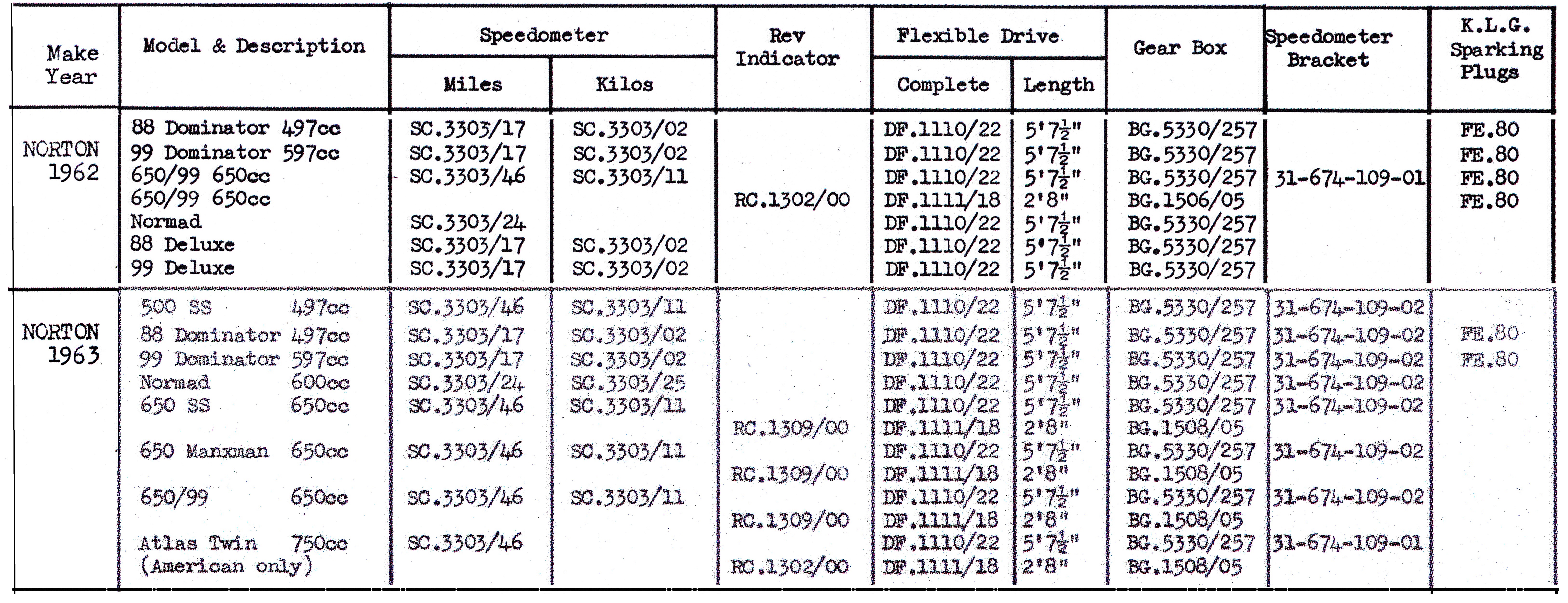

According to Smiths motorcycle fitment catalogue for 1962, the rev counter listed for 650 is   RC.1302/00
(40M  and 30M are listed as ATRC.2652)
Gearbox for 650 was BC.1506/05.  Cable length 2'8"

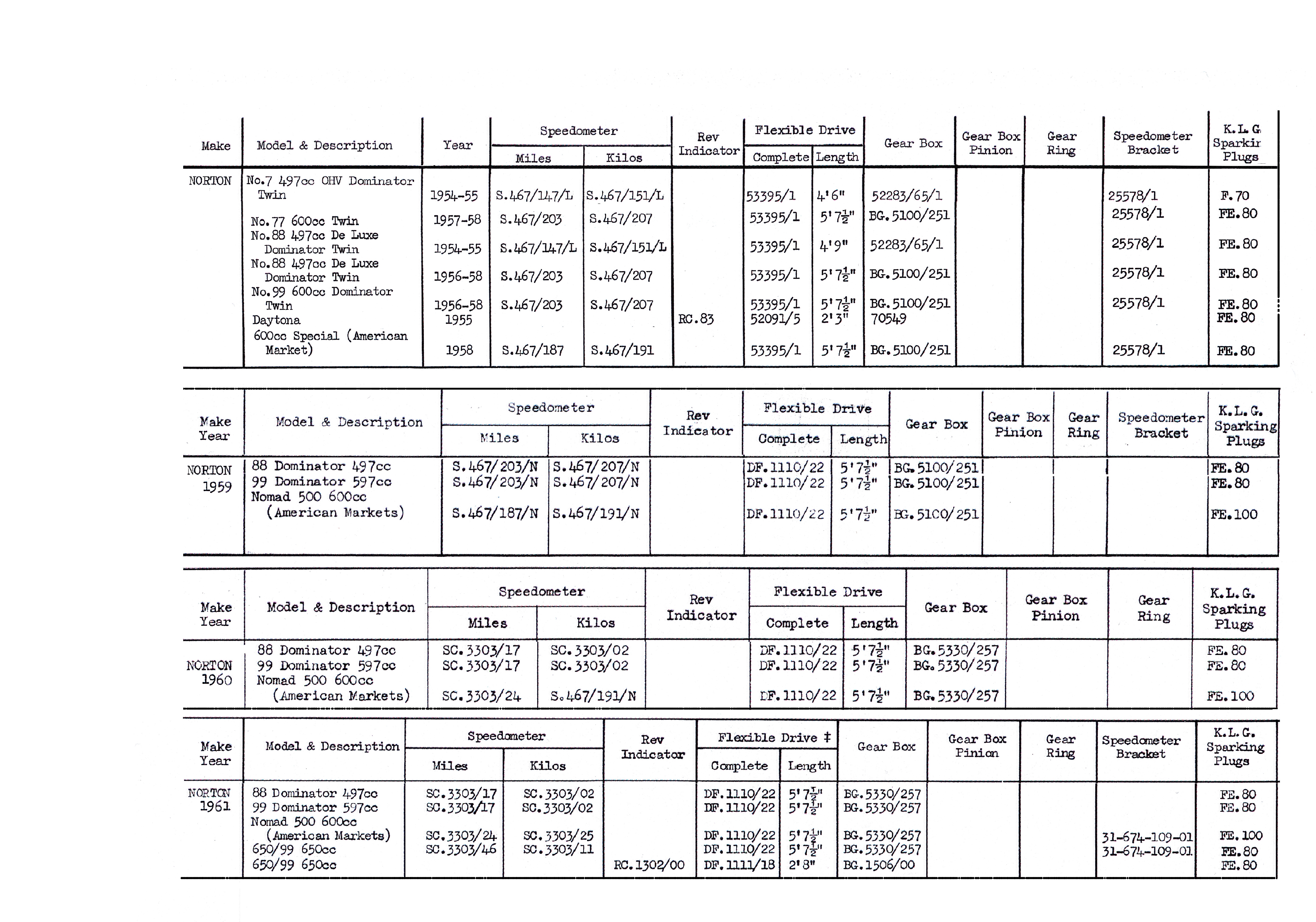

As below was destined for the DSNs but the question of copyright arose.
clocks
In reply to by philip_hannam1
Brilliant ,all we need now is a way to improve the clarity and blow it up so the old fossils can read it !.  Actually the page zoom on my PC  gives a good result at 250% , shame the info ends in the early 1960's.
