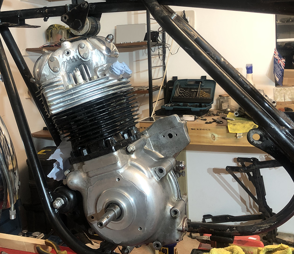

I am restoring my 1971 Commando 750

The bike has no engine number and its first registration for my V5 says first reg 1990 It does have the compliance plate still attached.
Does anybody know why it does not have an engine number.
The engine has been out of the bike because the pistons are 20tho over.
Could it have been a replacement engine. Who knows because it has no history for almost 20years prior to 1990.

If you have an engine with no number I would guess that the most likely reason is a replacement crankcase. Usually needed due to a con rod breaking and taking one or both halves of the crankcase with it.
New replacement crankcases were supplied unstamped. Usually the dealers stamped them if it was warranty work, but private owner probably didn't bother.
Are the cases the 1971 type with camshaft breather ? Lots have been rebuilt with later cases.

I think you might be right the cases look like 1972 versions. replaced from 1971 1972 cases replacementbike

Crankcase looks more recent than 1972. Maybe 73 or 74.
My 72 still has the cover on the back of the timing side where the points used to be fitted. I think this was done away with in 73.
I’m sure the more knowledgeable would know!
That is a late 72 or a 73, it still has the 72 breather outlet on the rear with blanking plate and the cover over the old points is now part of the casting which is a mid 72 mod, 73 looks the same. It will also not have the large sump and filter, just the drain with magnet so no protection for the return side of the pump from the engine blow up remains. 74 was 850 only and the large sump and filter returned to the 73 850 too but not to the 750 unless it was a 750 short stroke which used 850 cases.

Stephen, it does indeed look as if you've got an engine that has been rebuilt with the last 750 pattern case. They're the strongest type but as has been mentioned, they lack the sump strainer....Have you made sure that the oil return pick-up has been modified ? With the breather moved to the timing cover, these engines can 'wet sump' in the true sense of the term (i.e. not when standing but by failing to scavenge at high revs). With the original breather fitment, it has been suggested that oil was pumped up the breather back to the tank which just about worked for moderate road use.
My preference is not to stamp replacement case...It never looks 'right' and can cause more questions than the milled surface of new cases, added to which, historically it's confusing the issue as the number you have is presumably one that belongs on the front curved surface of a timed breather engine.

The cases have not been split yet. They are down at my local machine shop.
i am pretty sure it has not had the oil scavenge upgrade. I can tell you for sure it wet sumps very quickly while in storage.
i think it would be a good idea to get this machined when the cases are split.
Is there anything else I should check while the engine is fully apart
cheers
Nothing springs to mind beyond the usual mechanical checks...I assume that whoever repositioned the breather ensured that the timing chest can communicate properly with the crankcase.
..and whilst it's not internal, on these engines especially I would fit a late-type cartridge oil filter while everything is apart.
Fix to the lack of sump filter issue in 750 72 and 73 cases, it needs a vertical mill and lathe.
https://www.accessnorton.com/NortonCommando/72-crankcase-mod-to-add-sump-filter.31727/
