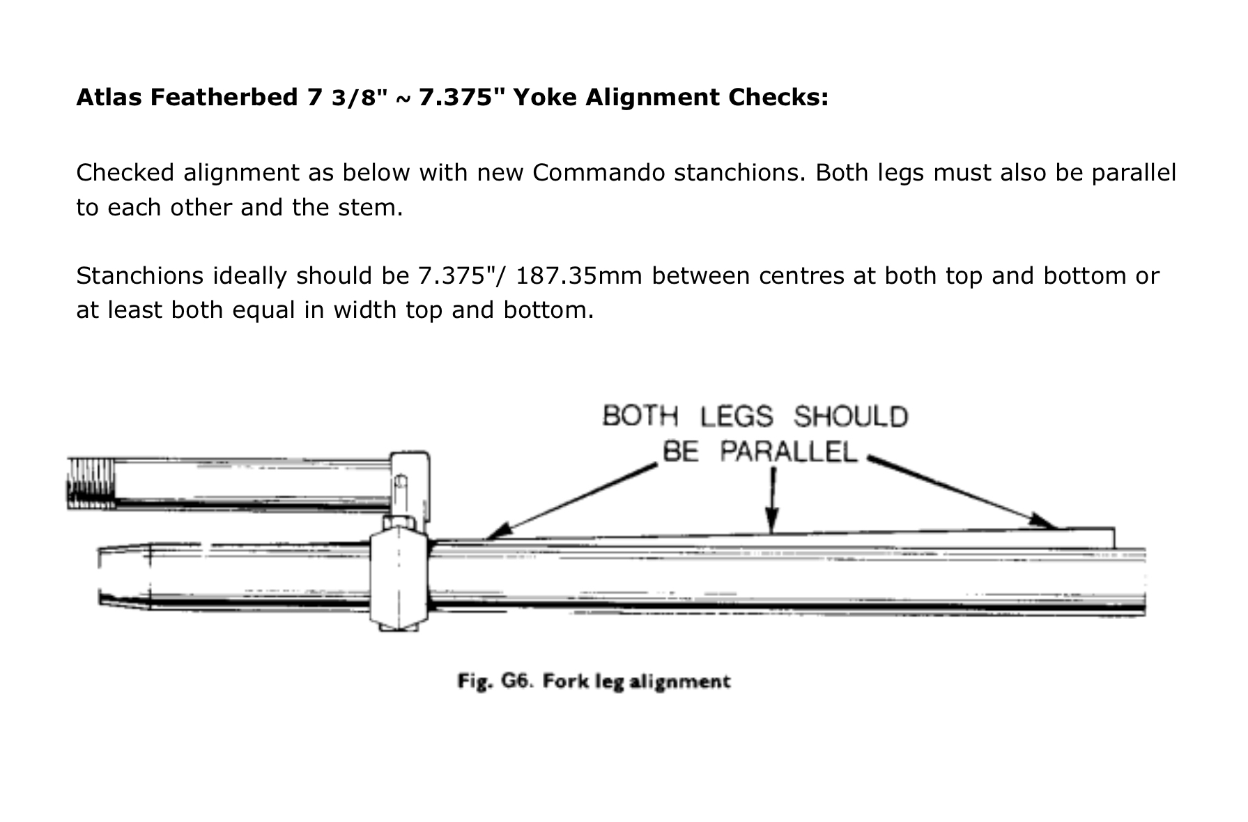

If the forks are off the bike the diagram below is a simple guide which I found somewhere (my notes and dimensions added)
New Commando stanchions were used to check my 73/8" Atlas yokes . Amazingly both were spot on.
