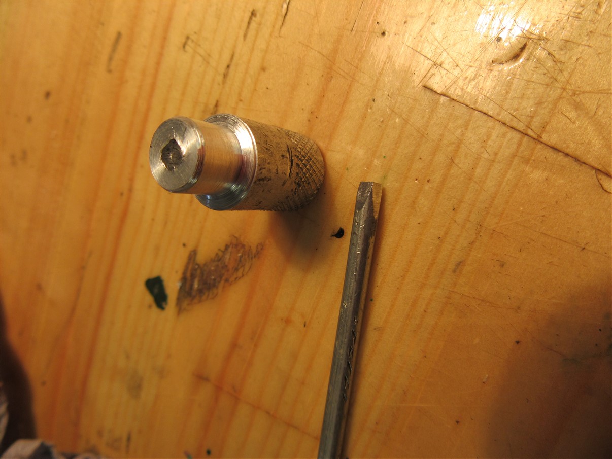

Hi does anyone happen to know what size tool is required to adjust the tappet? Is it 5/16

0.44 " ( 11.3 ) mm
That's 3/16" BSW or 1/4" BSF
... for a Triumph twin which uses a similar method. A short length of 1/2" diameter alloy rod drilled centrally (about 6mm IIRC) then a tapered square section drift hammered into it. Then knurled to make it look posh.
Actually just realised it was for a Honda but the same applies.
Here it is:
tappet tool
Assume it simply needs something to hold it still while the nut locks it up right?
Didn't the rear shocks adjuster spanner had a square hole?
The factory produced in their tool kits, two different special spanners to adjust the tappets on their Norton twins. Russel Motors may still have, these spanners. Even the later Commando's had them. I have found a few of these at auto-jumbles.
