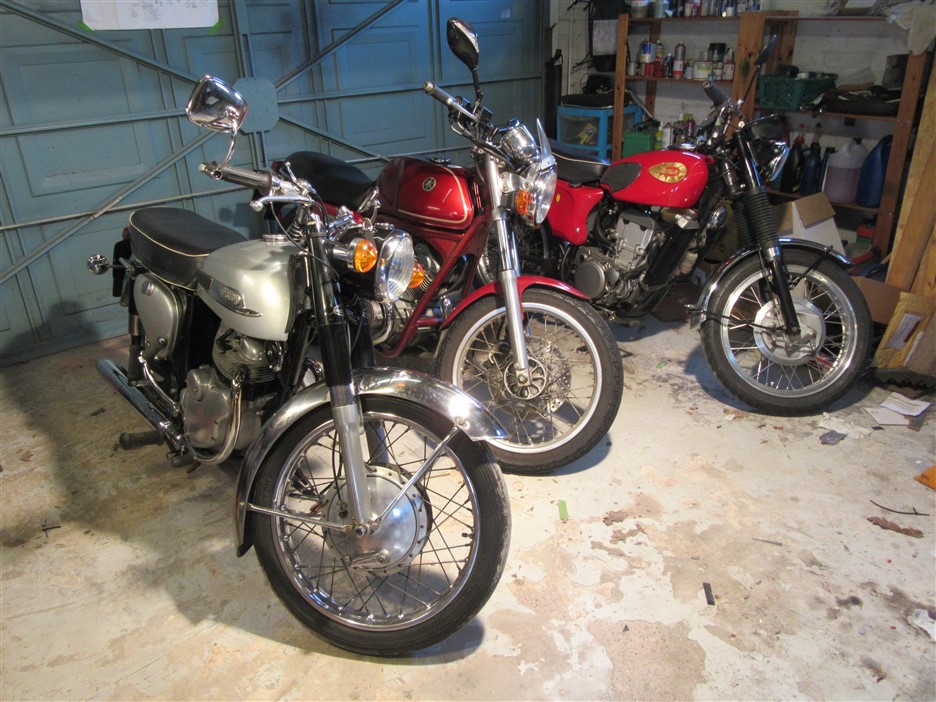

On the meantime here are my 3 bikes while all present and correct.
3 bikes
... it's fitted with an ex-CCM Suzuki DRZ400 engine by a previous owner. A nice engineering job with even gearchange and rear brake on the proper sides although I needed to change the former to one up four down to work in correct (ie Norton) pattern. It also needed a lot of minor but important tweaking. I've only ridden it once - couldn't get on with the Triumph gearchange pattern - but it went very well.

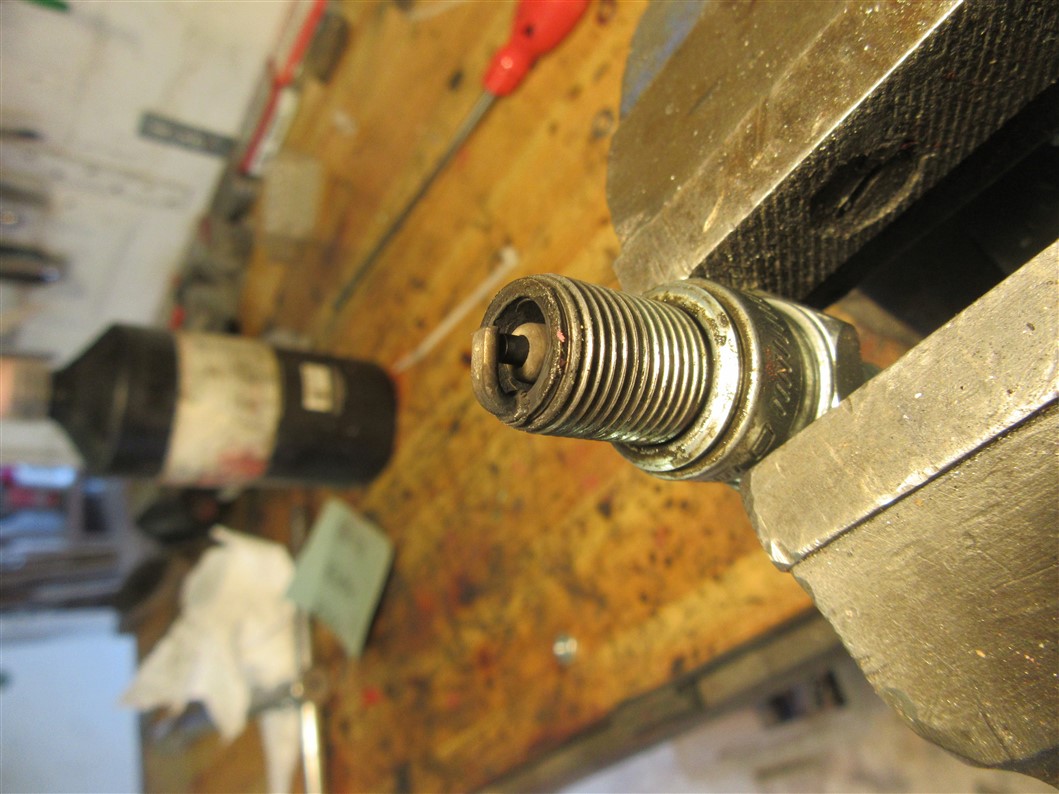

... shows a nice colour although interestingly not wet at all. I'm still wondering whether there's enough voltage to trigger the Boyer properly although this may be leading me along the primrose path. I'm also tempted to try a couple of NGK (B6ES?) plugs or maybe even posh platinum ones. There do seem to be plenty of sparks at the plug when spun over.
plug
