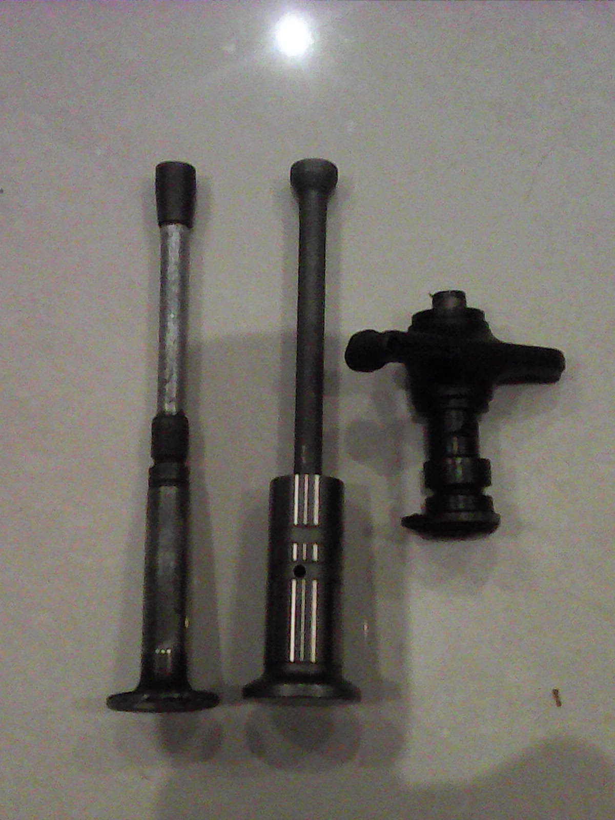

VW Beetle Type 1 cam followers
19mm  shaft 28mm head may work. They fit snuggly in the pushrod tunnels of the cast iron cylinder barrels that are 3/4" (19.05mm) diameter. Requires tappet bush (part no A40 20751) to be omitted and push rods to be made 20mm longer than originally fitted to lightweights. It is easier for push rods to be made that size than to  manufacture cam followers. Millions of  VW cam followers have been tried and tested, and are cheap (approx £10 each). Needs  an engine to bench test the arrangement to give confidence to lightweight owners for their use.
GRAHAM
Hi Graham,
The general shape looks the right idea. Manufactured in Germany I'm surprised they used an OD of 3/4 ins.
How would the oil to the top half of the lightweight engine drain down if there were no slots in the side of the tappet bushes? I think that's the only way oil drains from the rocker and head area.
I love the idea of using a car engine part as it's bound to be a lot cheaper and quicker than manufacturing a 'special'.

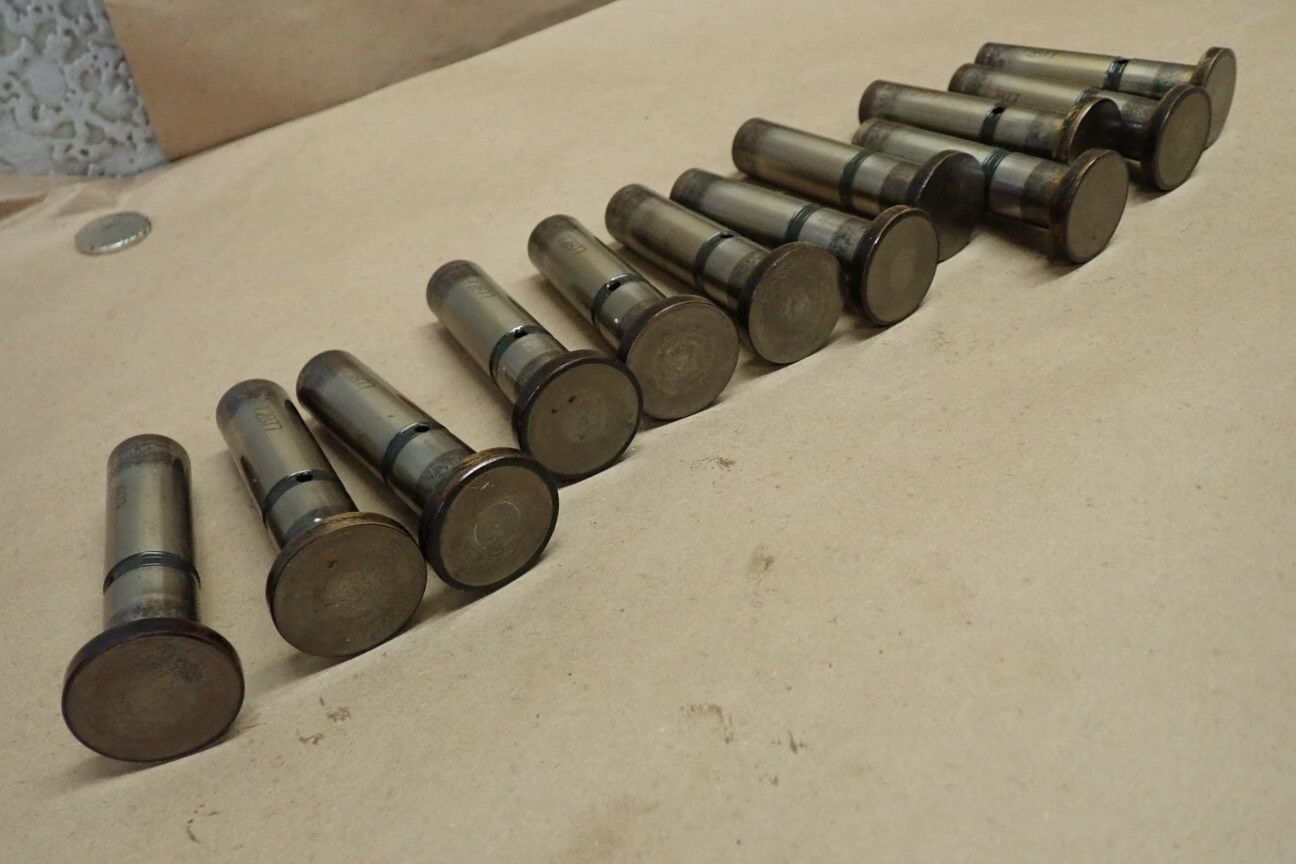

Here's a picture of a set from an Avro Lycoming engine on Ebay at the moment. Sadly I don't have the dimensions but they look the same concept as Norton Lightweight.
