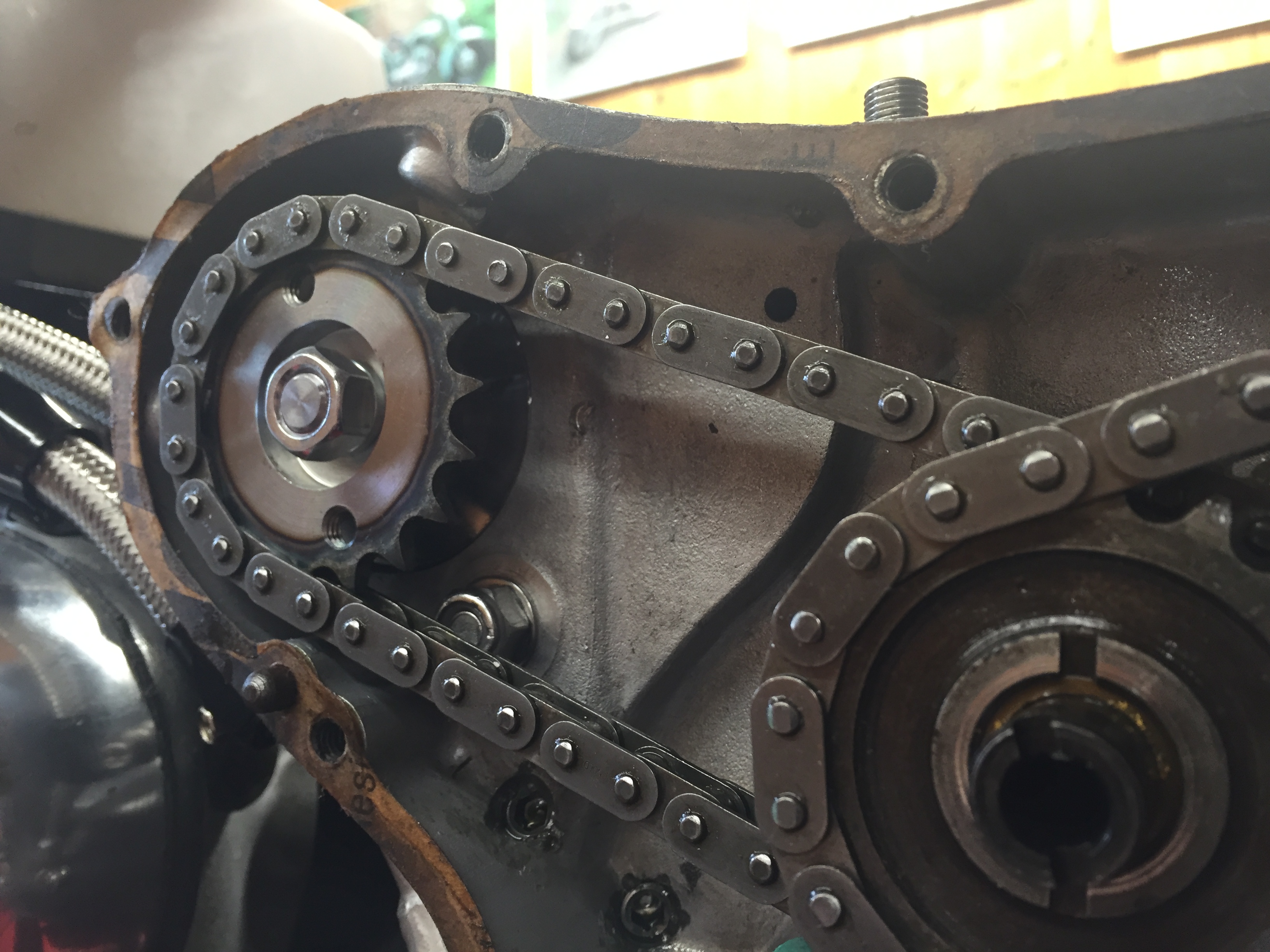

I'm currently in the process of converting my 1963 dominator 650ss to tri-spark ignition... What 18t sprocket did you use on the unit and from where did you get it?
Many Thanks
