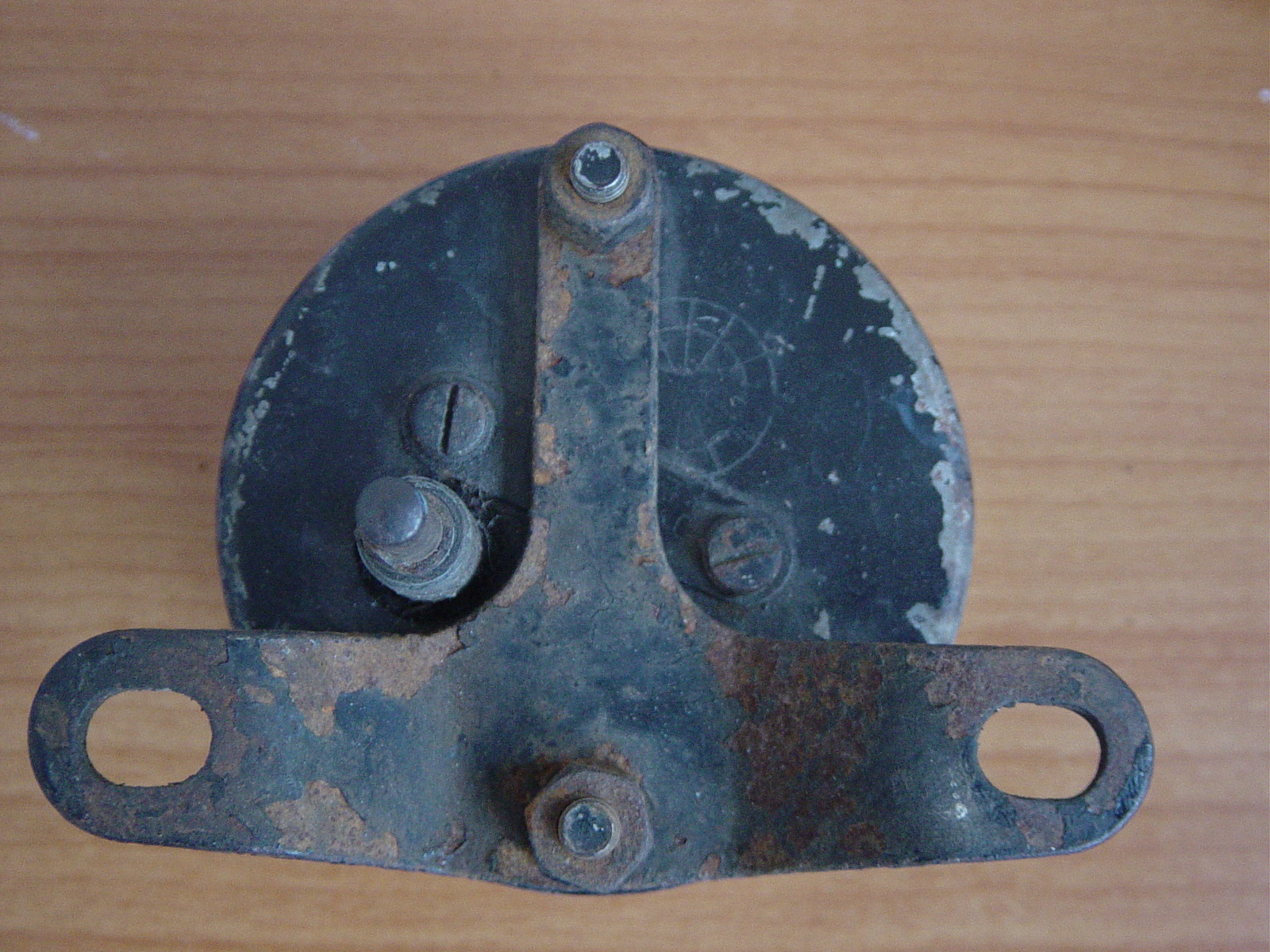

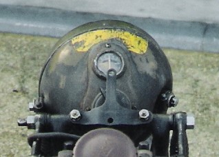

Where fitted on pre-war and also very early-war WD Nortons, the central bracket was used (assuming no panel tank of course). I've seen it suggested that the offset bracket was introduced on the WD Nortons to allow a map case to be attached there, but period photographs of this use are so rare that I suspect it may simply have been to allow a straight drive cable run with no risk of chafing on the fork spring.
John's is absolutely the correct original bracket. If looking for one, take care as there are Matchless equivalents which look interchangeable but aren't.

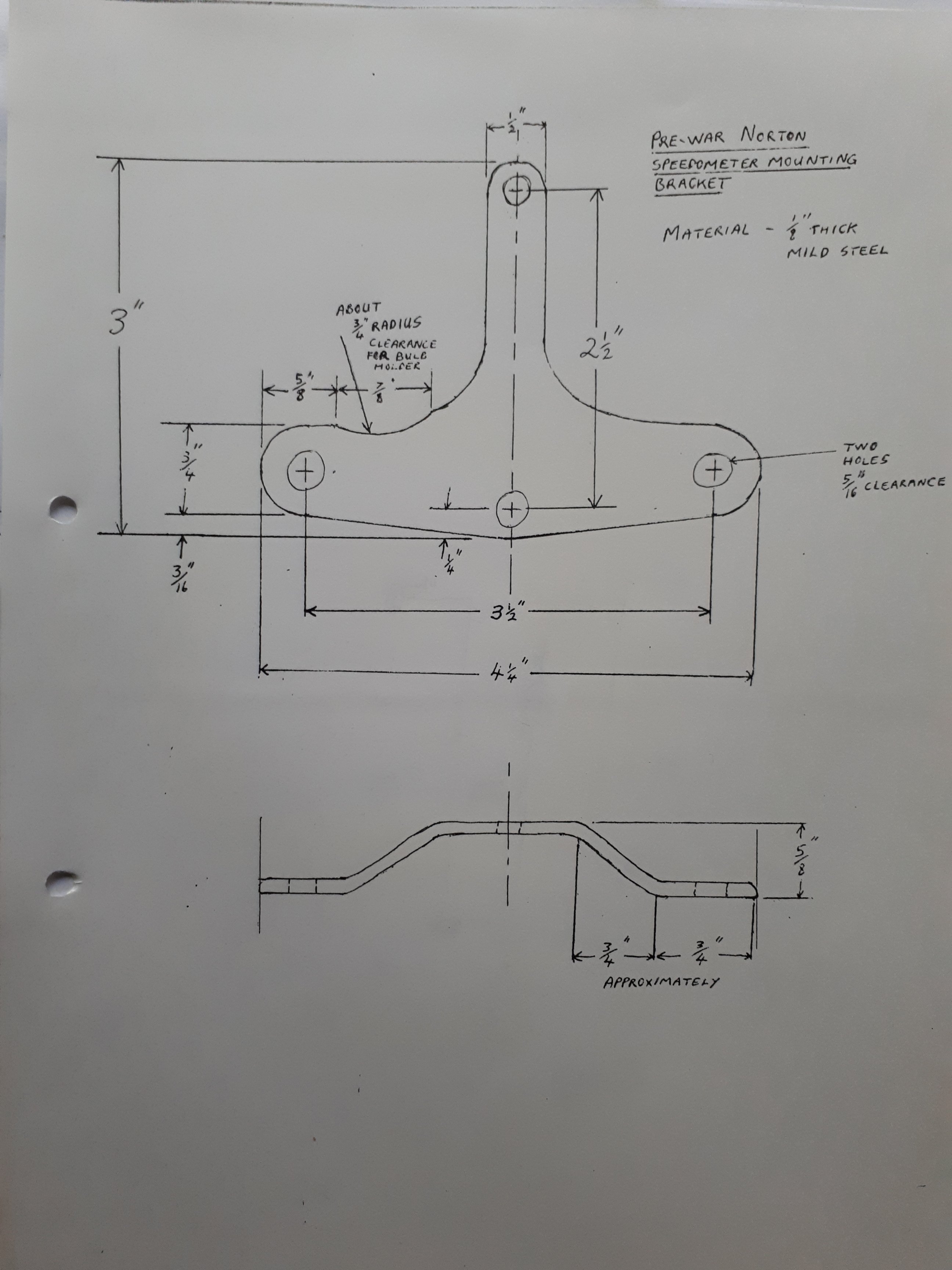

Thanks Richard, all very useful info, I've seen lots of brackets online that seem to have the mounting holes slightly too close together, I'm thinking the best plan is going to be making one myself.
     Many thanks, Stuart

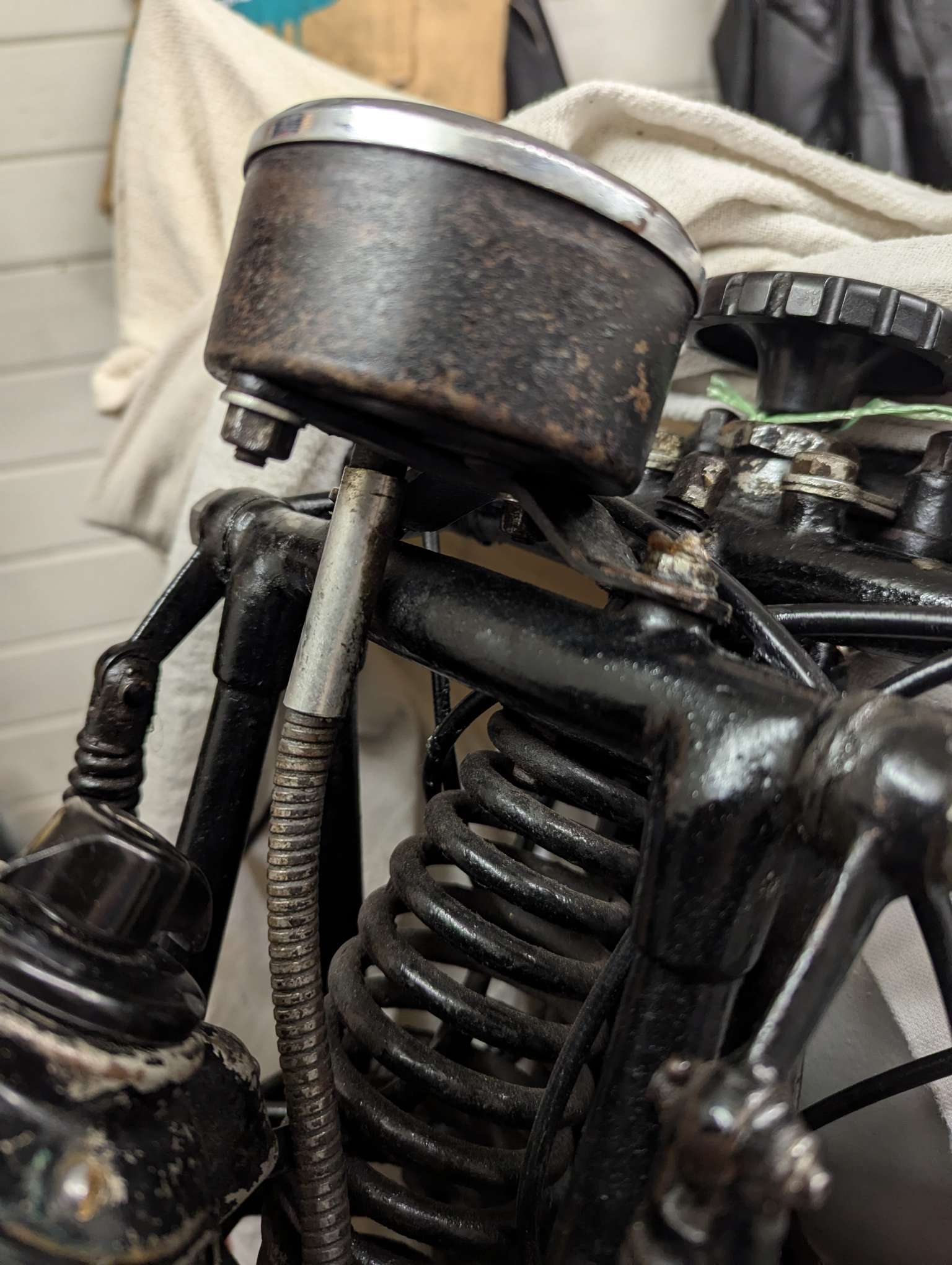

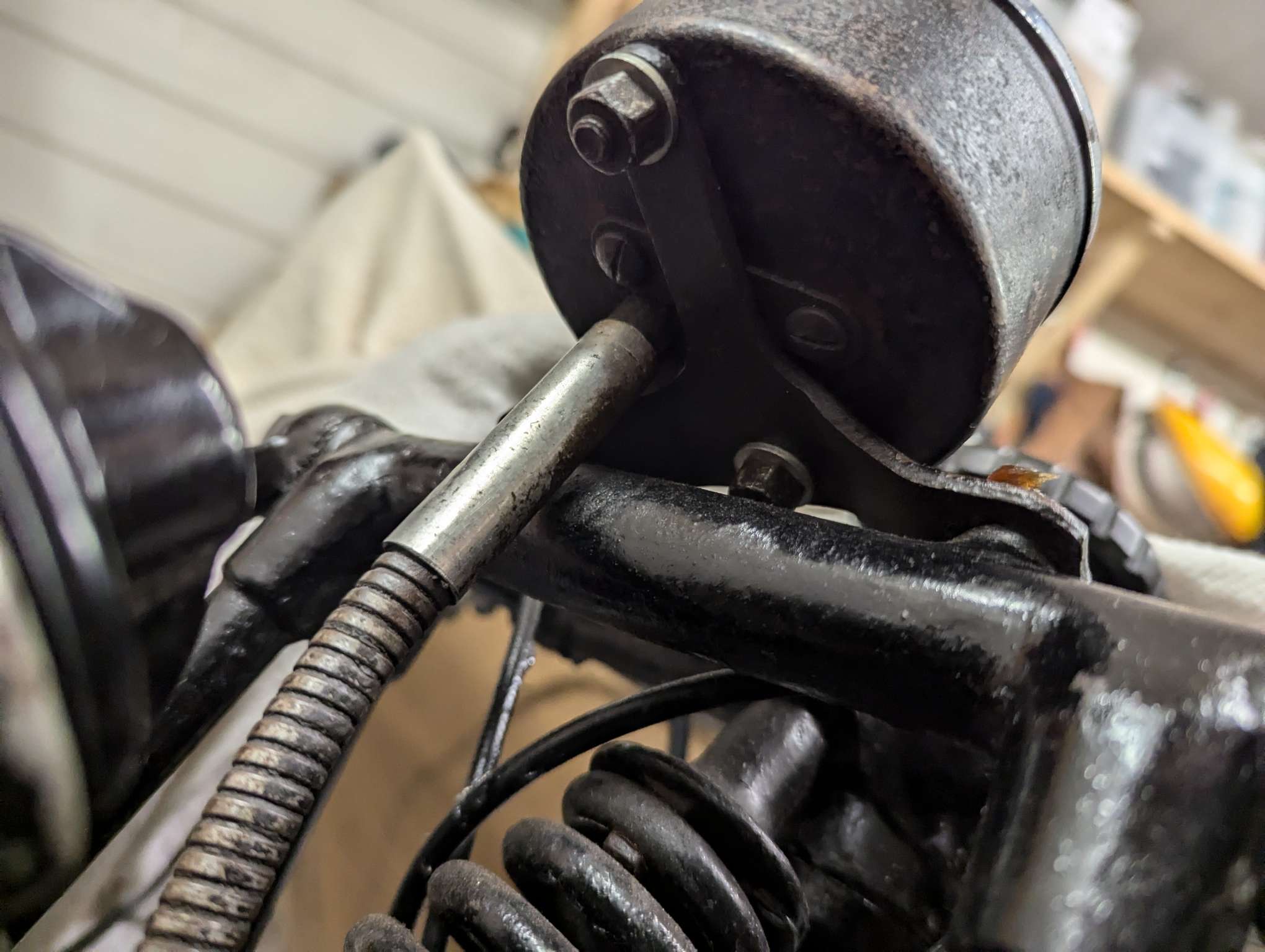

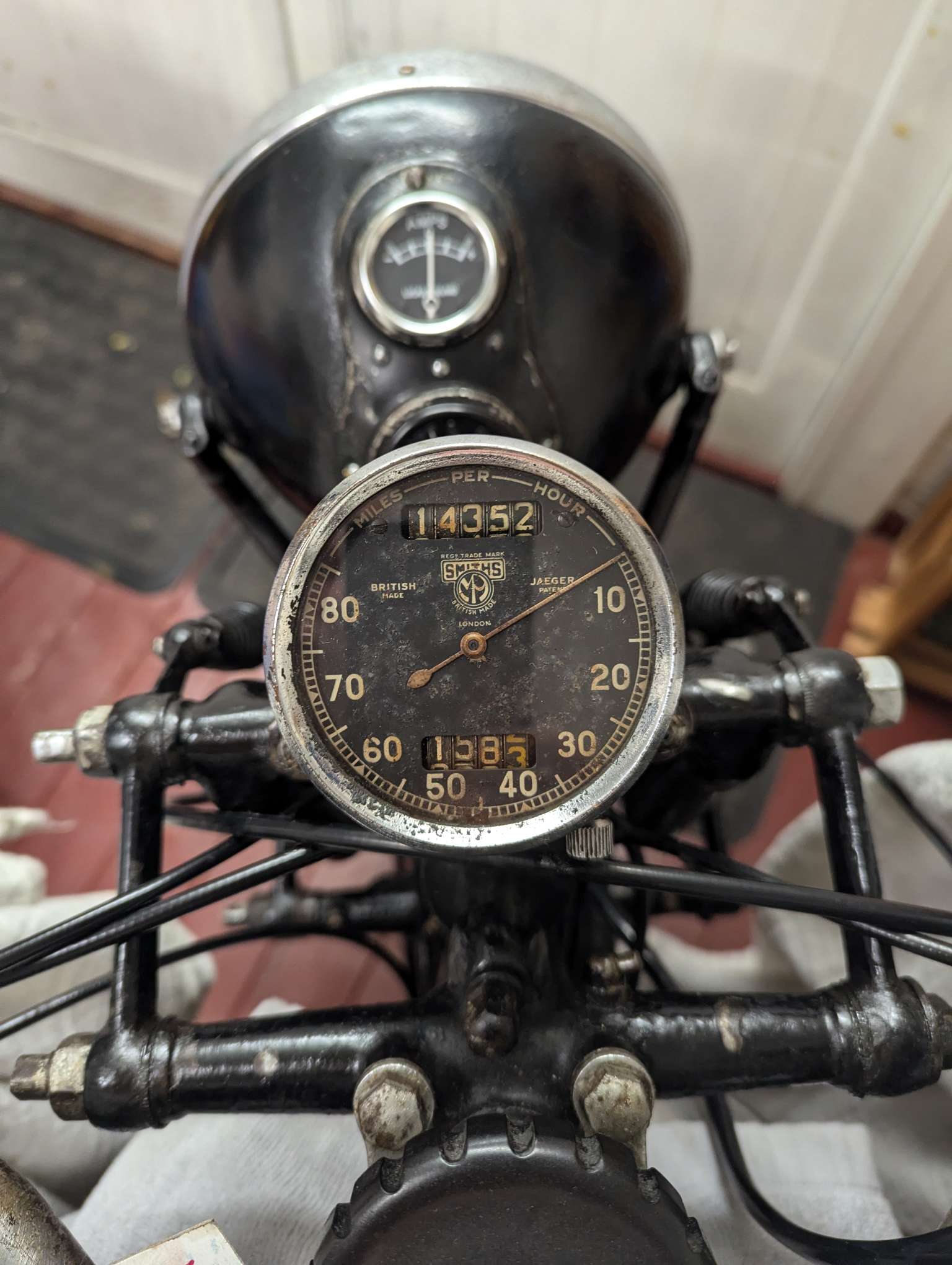

Thanks Jon, I've filed that with my Norton file, I think I'm sorted now, I've ordered a bracket from Kingpin Components who assure me it will fit  and spent this afternoon machining up the special bolts with grease nipples needed to fit it. Big thanks to everyone for their replies and suggestions.
