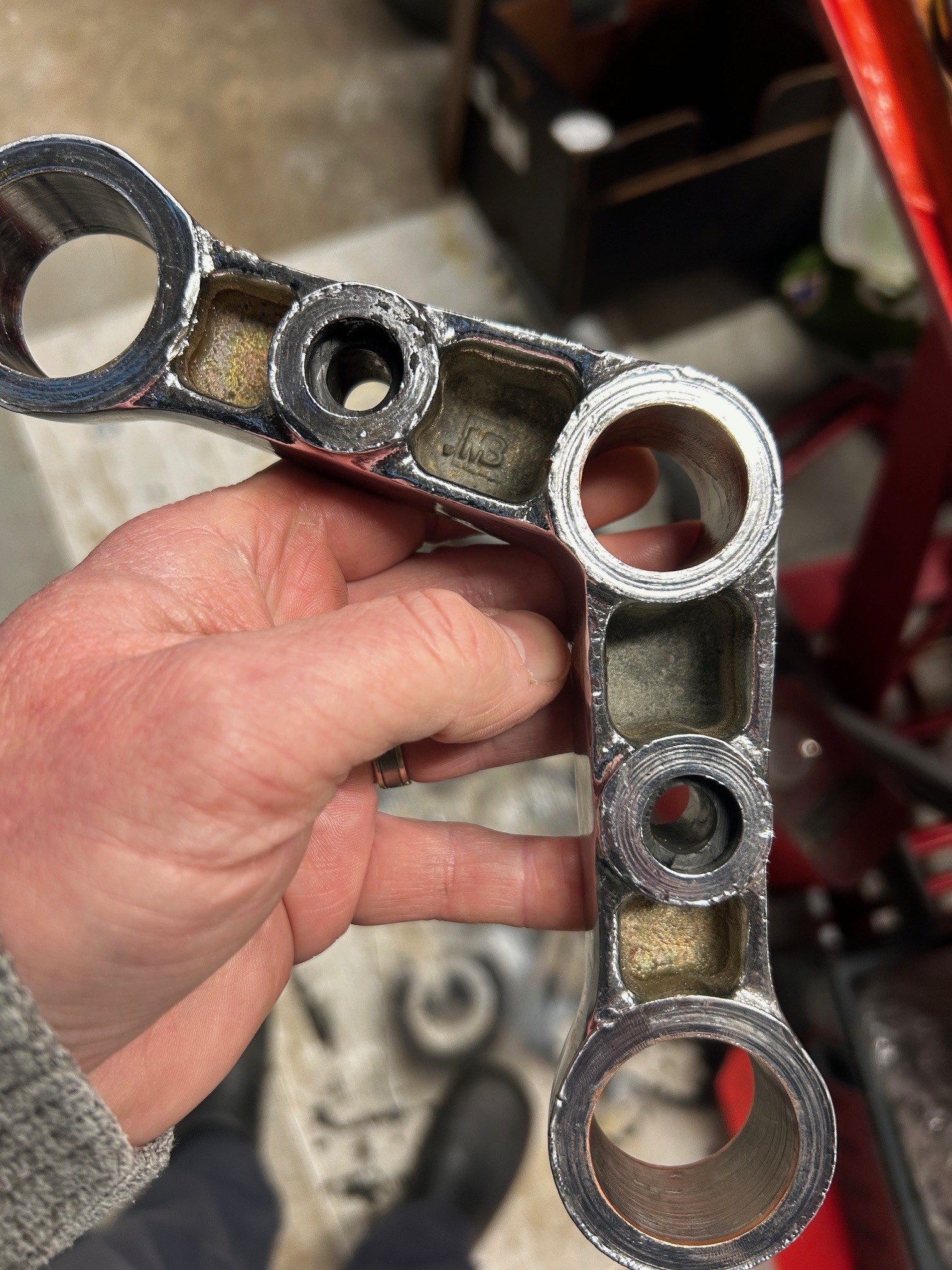

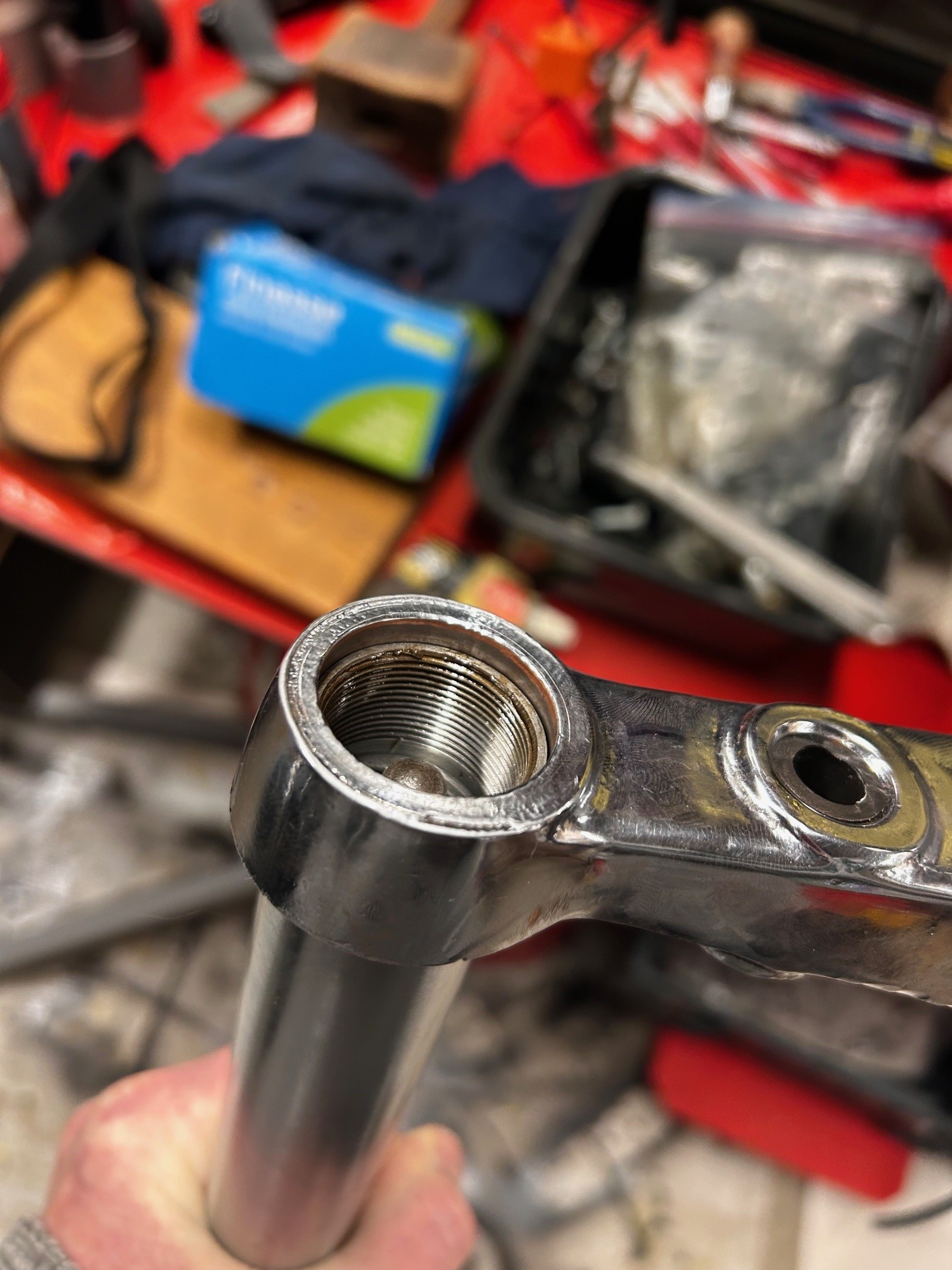

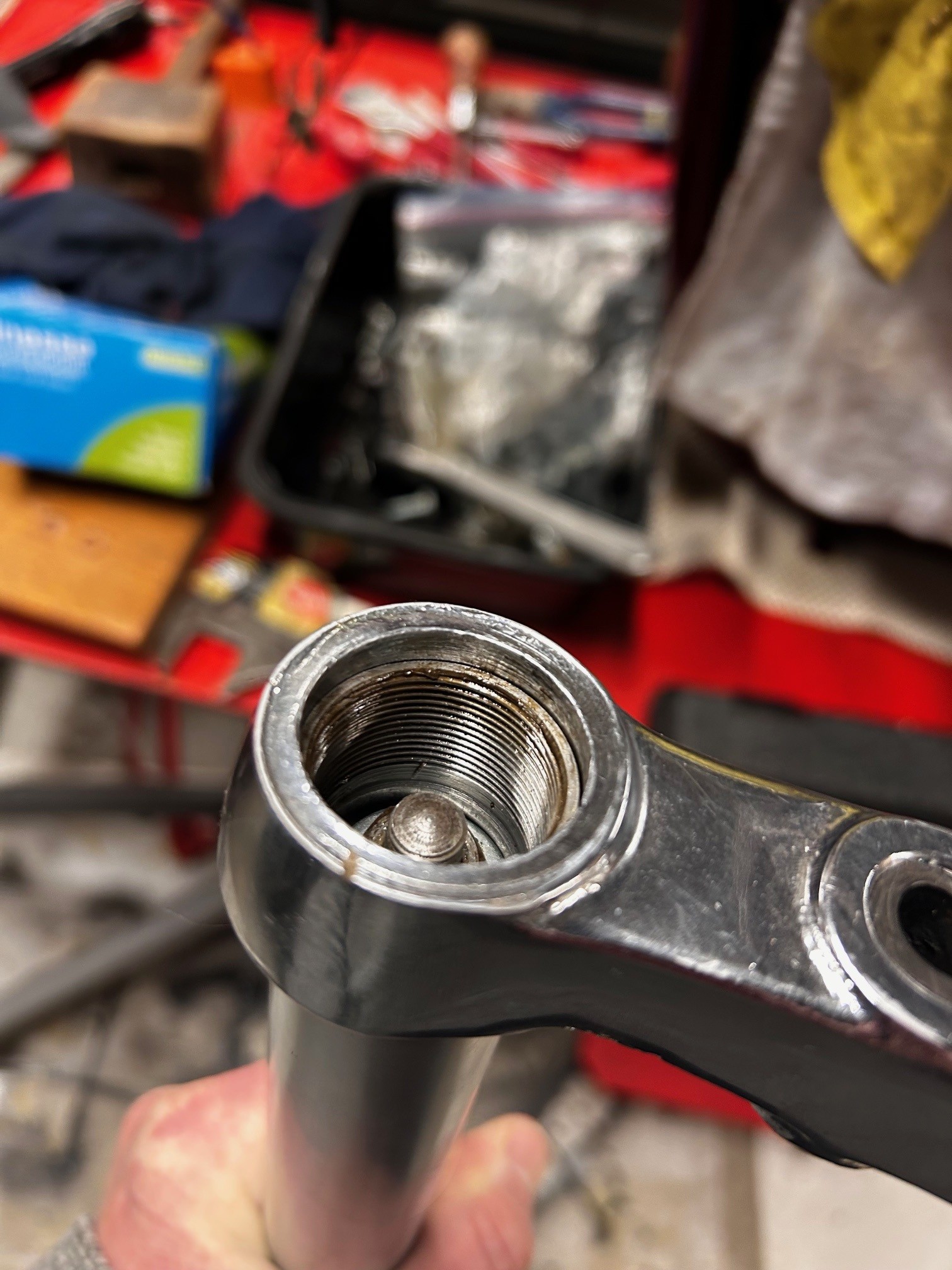

1) as you can see from the photos, the top of the forks sit a few millimetres down in the top yokes. Is  this normal or should they sit flush? If the latter than I can only assume that the chroming on the yokes has reduced the internal dimensions and I need to get them blasted and refinished, or machined .. thoughts and advices please?

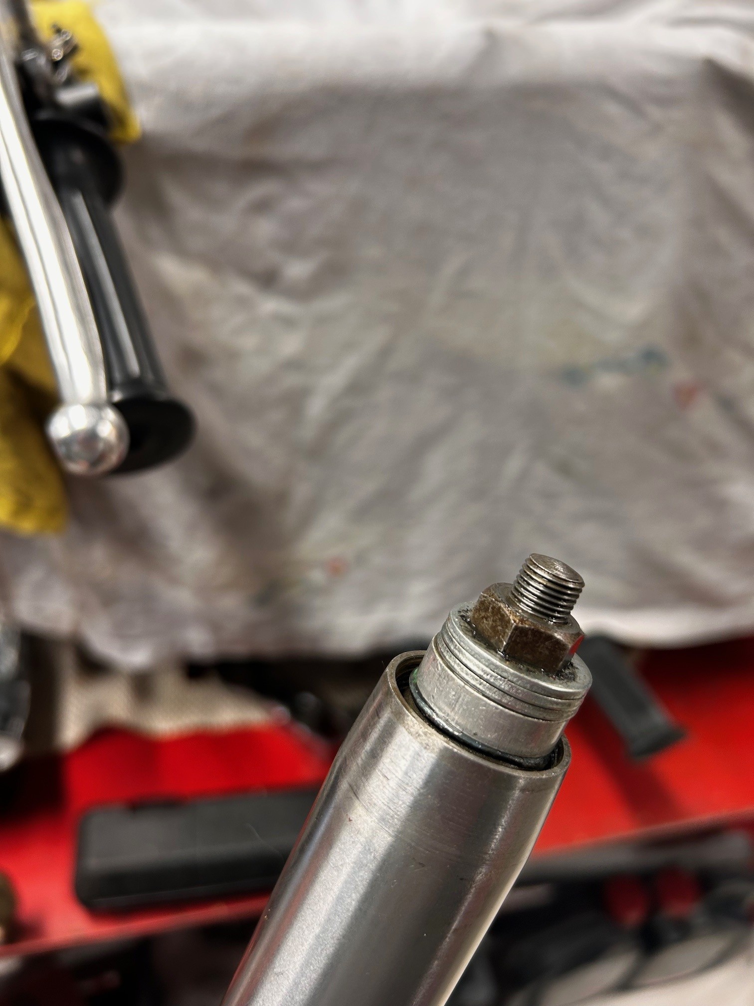

2) how proud should the top threads be on the fork internals ? Currently I have 7 threads showing, on one and 4 on the other.. ( thanks to the previous builder.NOT!) so yes I appreciate they need to match up.. but how many threads showing would anyone advise please?

... they're normally slightly recessed as you show. If the y were flush / proud the nuts wouldn't be able to tighten them into the taper.
As regards the damper threads, can't answer other than that they should be equal - assuming of course that fork internals are the same side to side. I seem to remember tightening them till there was no free play ie the clearance on top of the spring was taken up.

You might want to adjust the position of the nut on the damper rod to facilitate fitting the axle when the forks are at full extension ,axle holes should line up ! ,but usually dont . try putting the axle through  to check .One leg is always longer and makes it hard to refit wheel and axle. May need some washers on the rod or even an extra washer under top nut?.

Tim - I would not fit those extra steel washers between the collar and the top nut as depicted in your image fork3.jpg.  This restricts the damper movement somewhat and can cause the whole weight of the bike resting on the small nuts at the base of the two damper rods.  This will occur riding over potholes and using the centre stand.  There are no washers at this junction.  Good luck, howard
