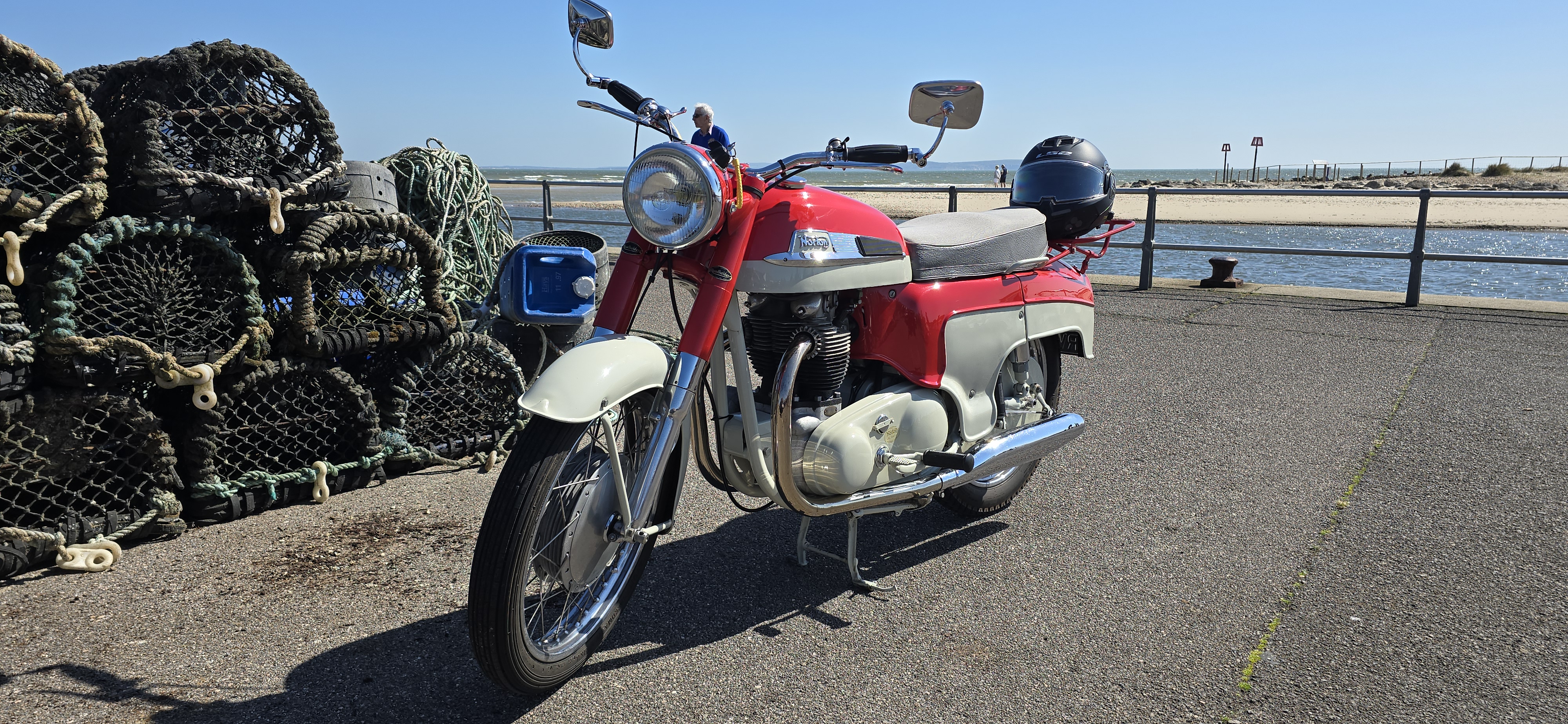

Went for a ride with DGR today, did 60miles to mudeford and the bike rode perfectly. Smooth, no issues, stopped and started 2 or 3 times OK, happy me.
Left mudeford to do the 16 odd miles home. That was a different story...
Coughed and spluttered. Totally different. Whether on a small throttle or opening her up she wasnt happy.
Nothing obviously loose. Nipped up the exhaust collar a smidge when I got home but even then the right cylinder feels like it's misfiring. Certainly rougher than the left.
Could a plug or lead have gone bad? I've changed both recently and its been running fine.

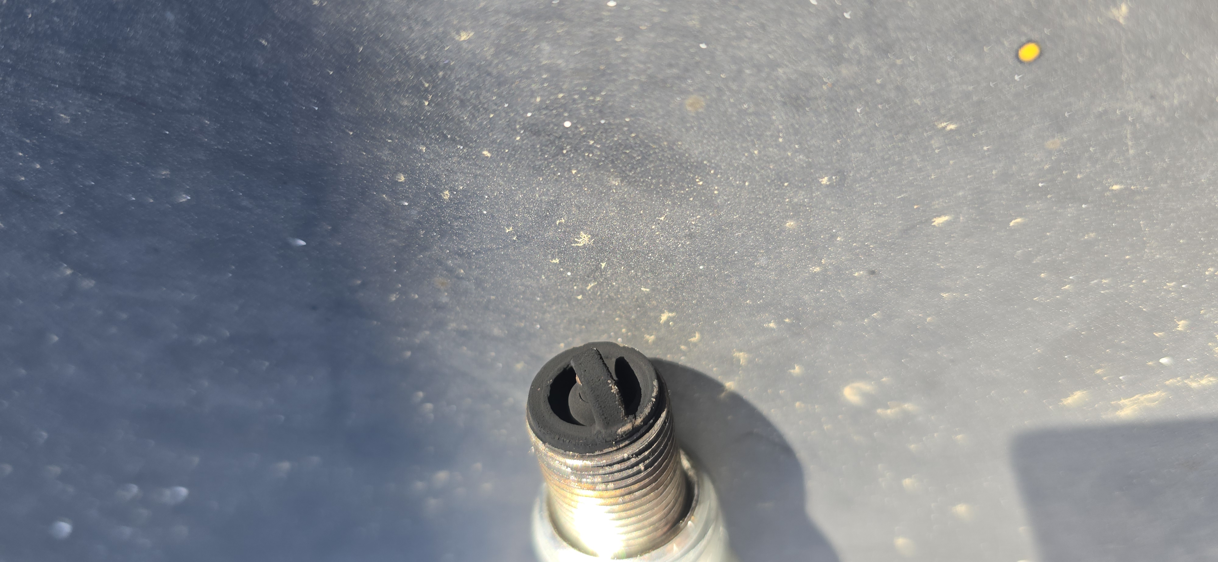

Change the plugs. Are the…
New plugs 3 or 4 weeks ago…
New plugs 3 or 4 weeks ago (the old ones were sooty) and it's 12v with boyer eleccy ignition.
Does look sooty.....
Does look sooty.....and just to add it's not using any oil or suffering wet sumping.

Hi Paul ,That plug is…
Hi Paul ,That plug is showing rich ( not oil) . Set the pilot when properly warmed up . I use a colourtune plug . Needle jet is a main suspect too. Are you running an N5 plug? . I prefer these or a KLG equivalent (old school but with a properly glazed pink insulator) . Not at all keen on wasted spark system which has one plug at a disadvantage with polarity . My 99 DL is very reliable on the old Dissy and points helped with an old school points assist EI unit from Boyer or Pazon. If out riding (usually the Atlas!) a sooty plug is made working by a bit of string and a soak in the petrol tank!.

Change the plugs. Are the old ones sooty or oily?
