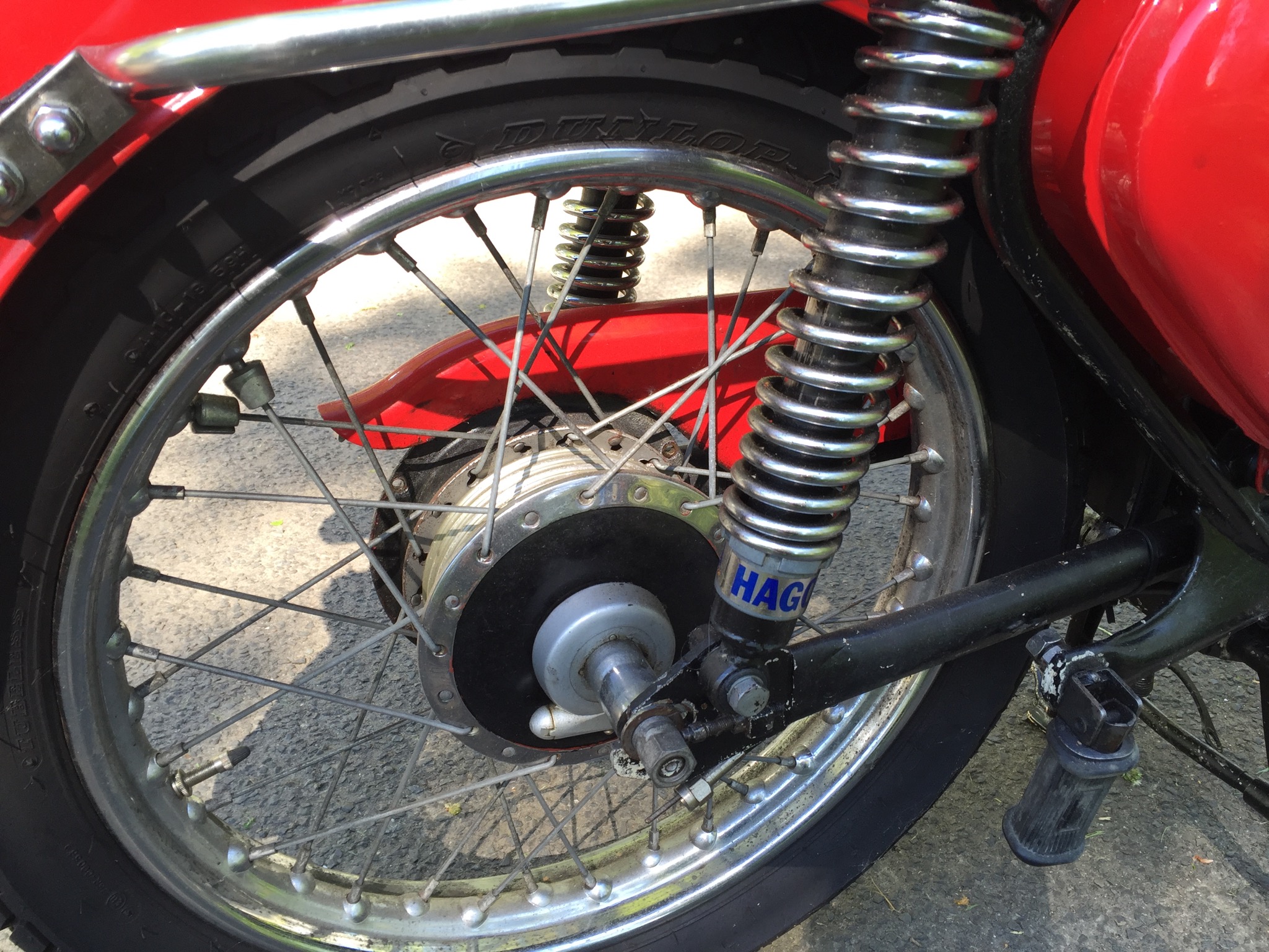

My Navi came with Hagon shocks.
Hagon shocks

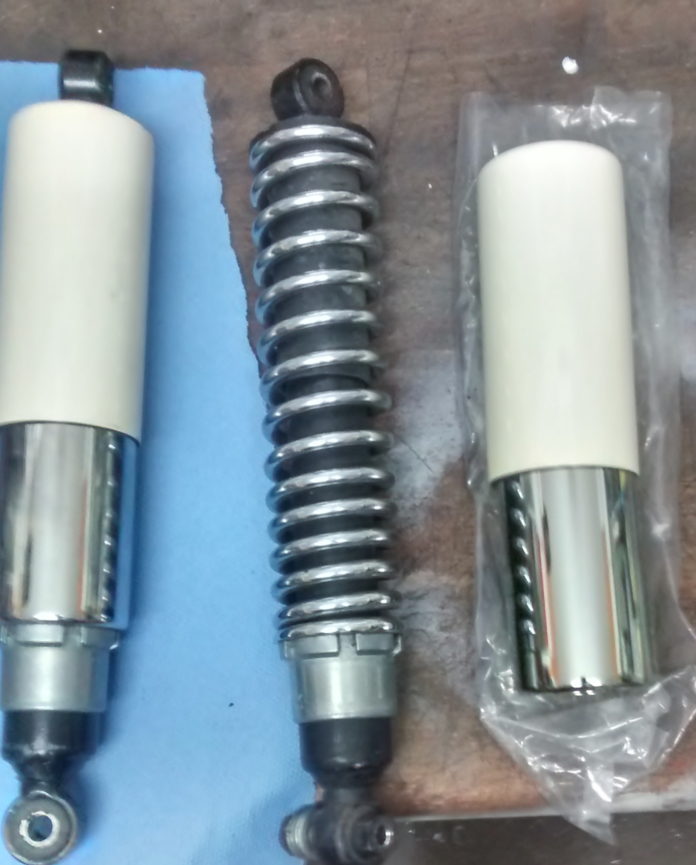

I bought some upper and lower shrouds from the NOC shop, painted them and mounted them.
I also used spacers for the upper shock mount.
shrouded shocks

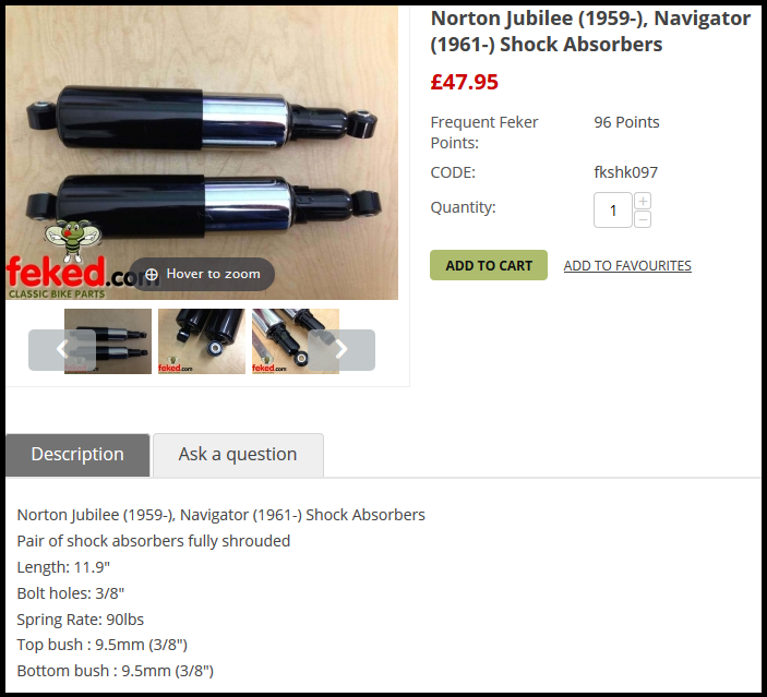

The best shock absorber available at present is from Feked.com.
https://www.feked.com/norton-jubilee-1959-navigator-1961-shock-absorbers.html
They list a set without shrouds for the Electra - but they are incorrect. 1) No shrouds & 2) the bottom bush is 5/16" (both top & bottom should be 3/8")
The overall length is near as dammit - should be 300mm (As Al says) which is about 11.8" and these are 11.9" - but the bushes should have a wider metal insert. They are shown flush with the top & bottom loop of the sgock absorber body - but should actually be 1" wide. Just pack them out with washers as Peter & Ulrich mention above. See attached picture.
