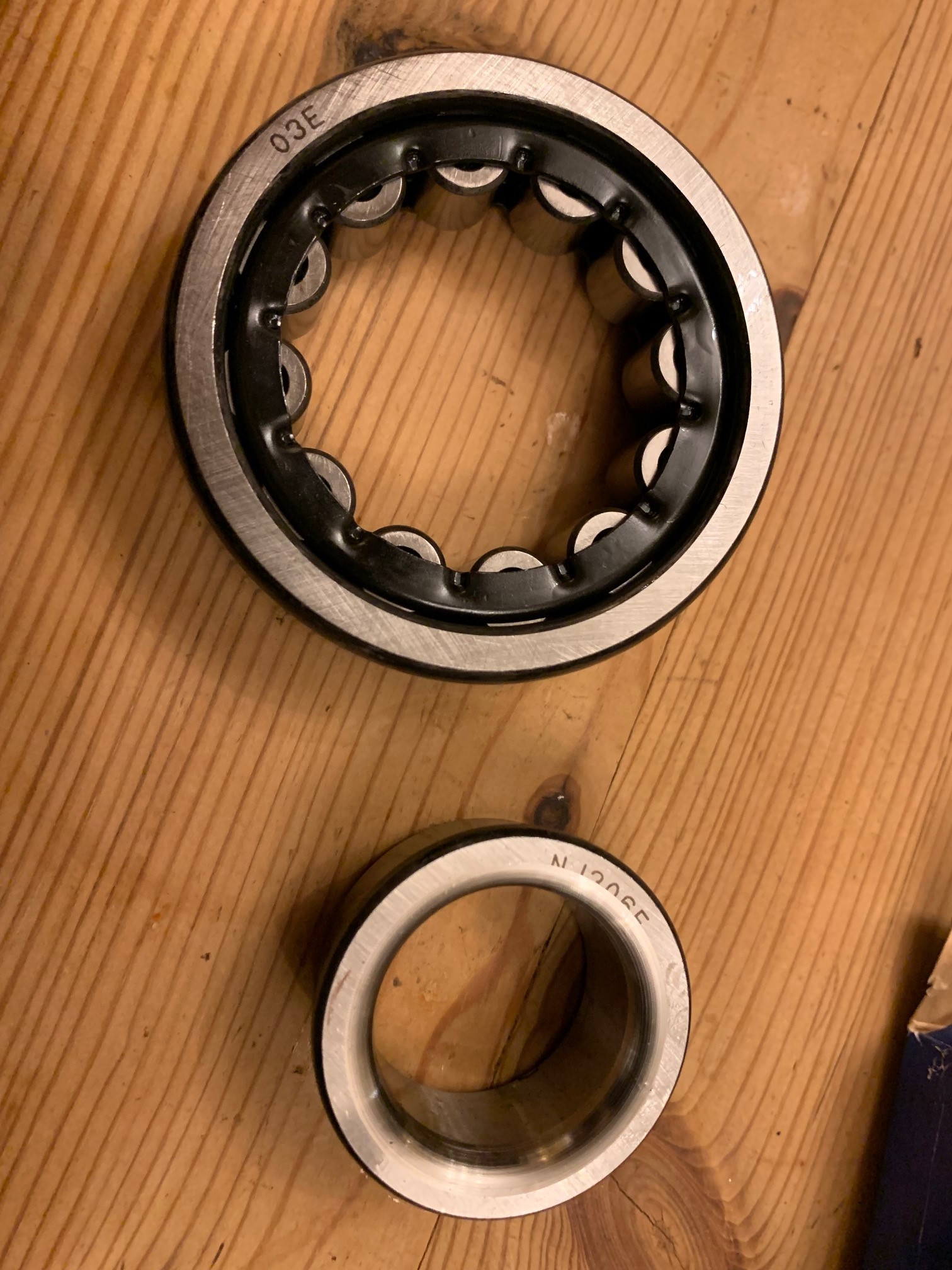

My Navigator engine rebuild saga continues with the question of whether to use the new Roller / Drive Side Main Bearings Part No: 20726 supplied by Norvil which, although the correct size and with the correct larger radius ground to fit the crank are a very different design to the originals as shown in the attached photos.
You will see that instead of an outer shell that presses in to the drive side crankcase the whole roller bearing presses in to the crankcase and the inner race which presses on the crankshaft is removable. The cage for the rollers is also just pressed together instead of being riveted which seems far less robust / lower quality.
Has anyone used these drive side main bearings from Norvil and can provide feeback over quality and any issues in fitting them? The club shop is out of stock at the moment but the picture of the bearing they use as an illustration is the same as my original bearings. Do they have a better source and are they going to restock?
Am I worrying over much? My instinct is to return them and try and source some NOS bearings - sadly when I phoned today Les at Russell Motorcycles is off work at the moment for a couple of weeks so I don't know if they have any in stock. Any suggestions of where to source some?

I fitted a set of those loose inner race bearings to my 650 and was horrified by the amount of pitting plus a bad score mark evident on the rollers when I checked the bottom end 1,000 miles later. Possibly this is why C3 or 3 dot clearance is specified for them to help cope with the rubbish that the oil system carries around. I then fitted an external oil filter to my bike.
I know that fitting a cartridge oil filter to a Lightweight is not that easy but this would go some way to help sifting the muck out of the oil.
Is it possible to drill the outer race to fabricate an oil drain?

Agree with above. Unless you…
Agree with above. Unless you can find a way of fitting a drain hole in the outer of the bearing & its seating to allow oil (& any foreign matter) to drain away, I would avoid this 'U' shaped outer bearing.
If clear of swarf & well lubed, I'm sure this is a capable bearing. Maybe its intended to work horizontally on a vertical shaft?

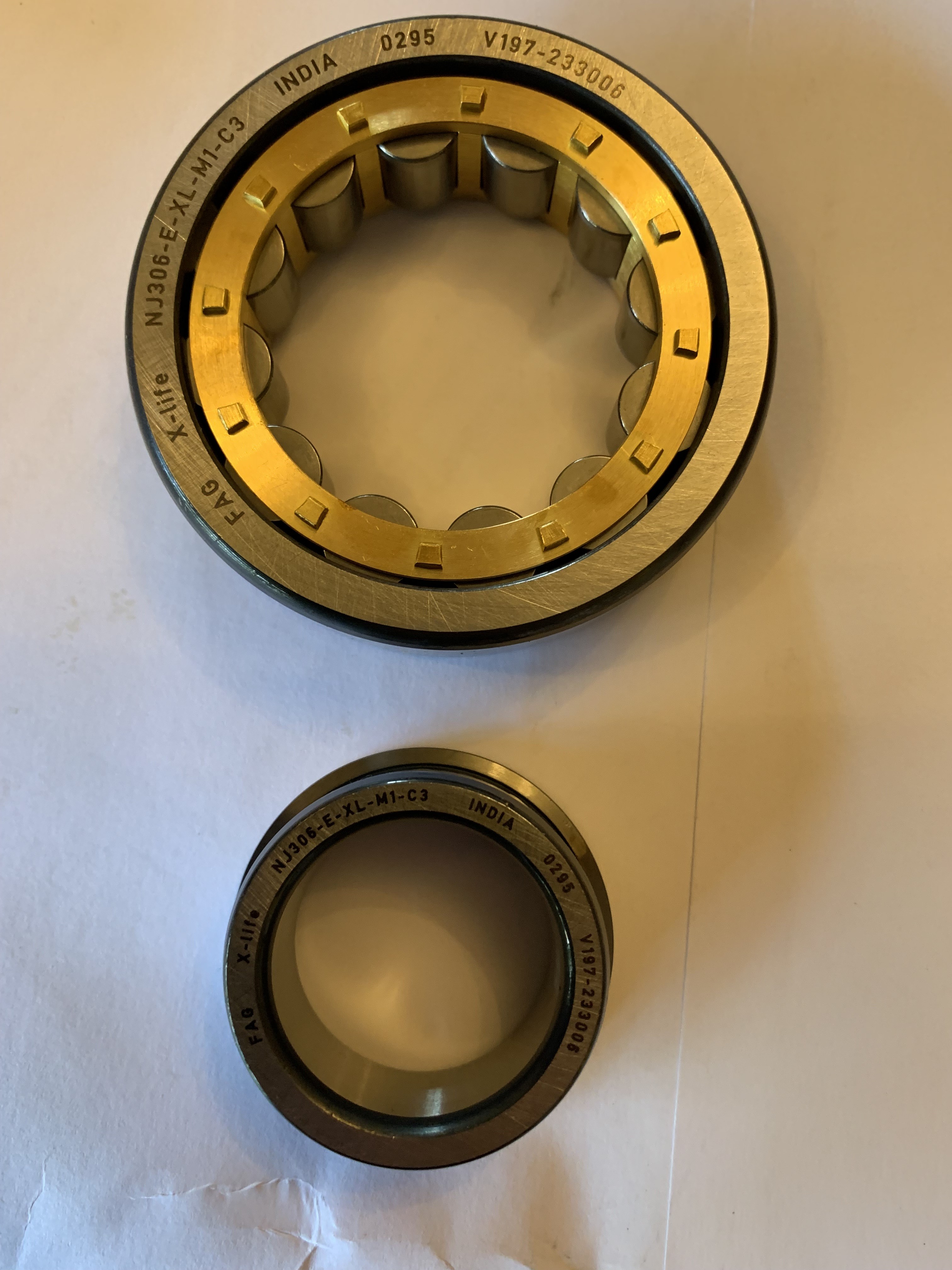

When I rebuilt my Jubilee in 1994 I fitted FAG roller bearings, as in the Commando. I just had them machined to match the radius on the crankshaft and that was it. They’re still there, never going to wear out. As the original ball bearings in the lightweights were the same size as in the Dominators, you’d think they’d be bullet proof, but they’re not for a couple of reasons. I figured that main bearings tough enough for a Commando 850 should last for ever though and it looks as if they are going to. Mine came from Norvil then, I don’t see any reason not to use them.

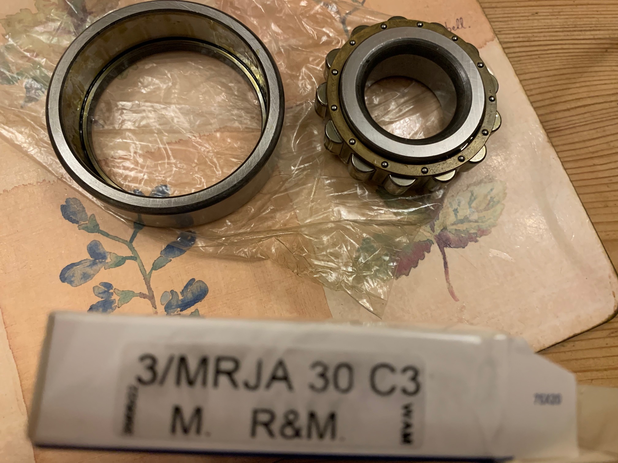

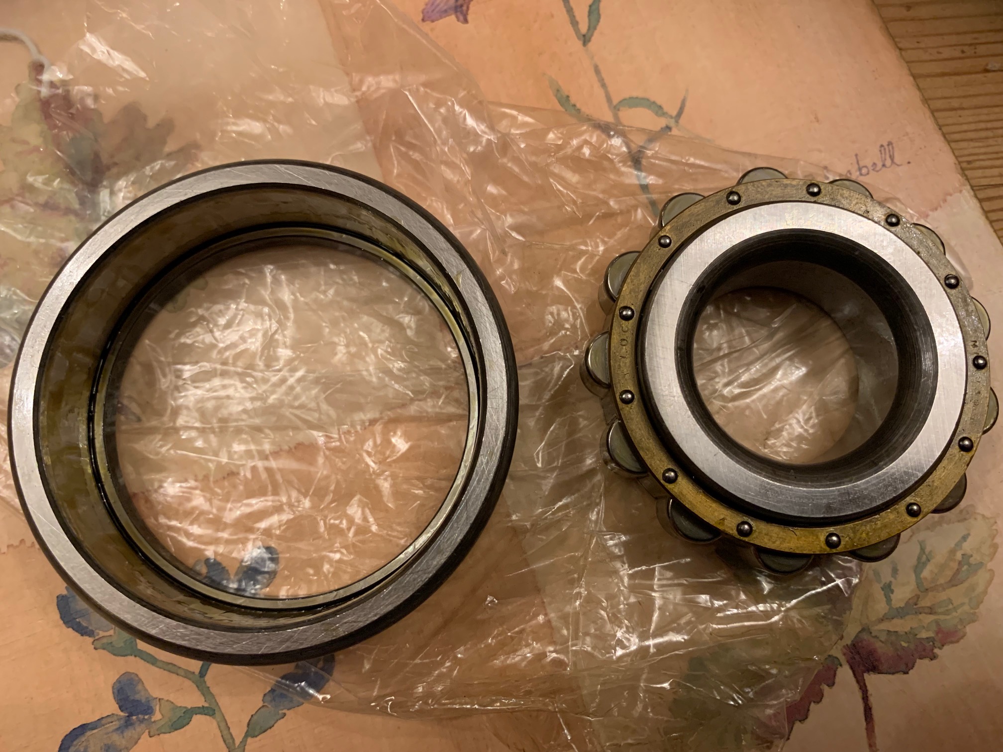

Well, it has taken me three months and cost me a small fortune but I have at last managed to source the correct drive side main bearing bearing (Norton part no: 20726 and Ransom bearing no: 3MRJA30M) for my Navigator engine rebuild!
As previously posted the bearings Norvil and Andover offered undoubtedly fit but are of a very different design to the original and the NOC shop are out of stock. My only other source of original Mains I could think of was Russell Motors in London but Les has been off work with a shoulder injury for the last few months. When he did come back he searched his stores but sadly has none left in stock.
A wider search of Ransom bearing suppliers finally came up with success with Orinoco Bearings in Leeds (tel 01132631913 or orinocobearings@gmail.com or bearinginfo@gmail.com ). I spoke to a really helpful and knowledgable chap called Graham Naughton who did a search on the Ransom part number and confirmed the good news they have a limited number still in stock (they also have the timing side bearing but these are available through Norvil at a very reasonable price so I have purchased on from them).
The bad news is they are priced at £130 each!!! After agonising for some weeks I finally decided that having already invested a small fortune in time and money sourcing rare original spares to produce the best engine that I can I couldn't spoil a ship for a ha'pth of tar and ordered one. I have attached a couple of photos to show the excellent quality of the bearings which are to the original design.
After all that I can now start the engine rebuild......I hope the information helps others in the same position. Onwards and upwards!!!
