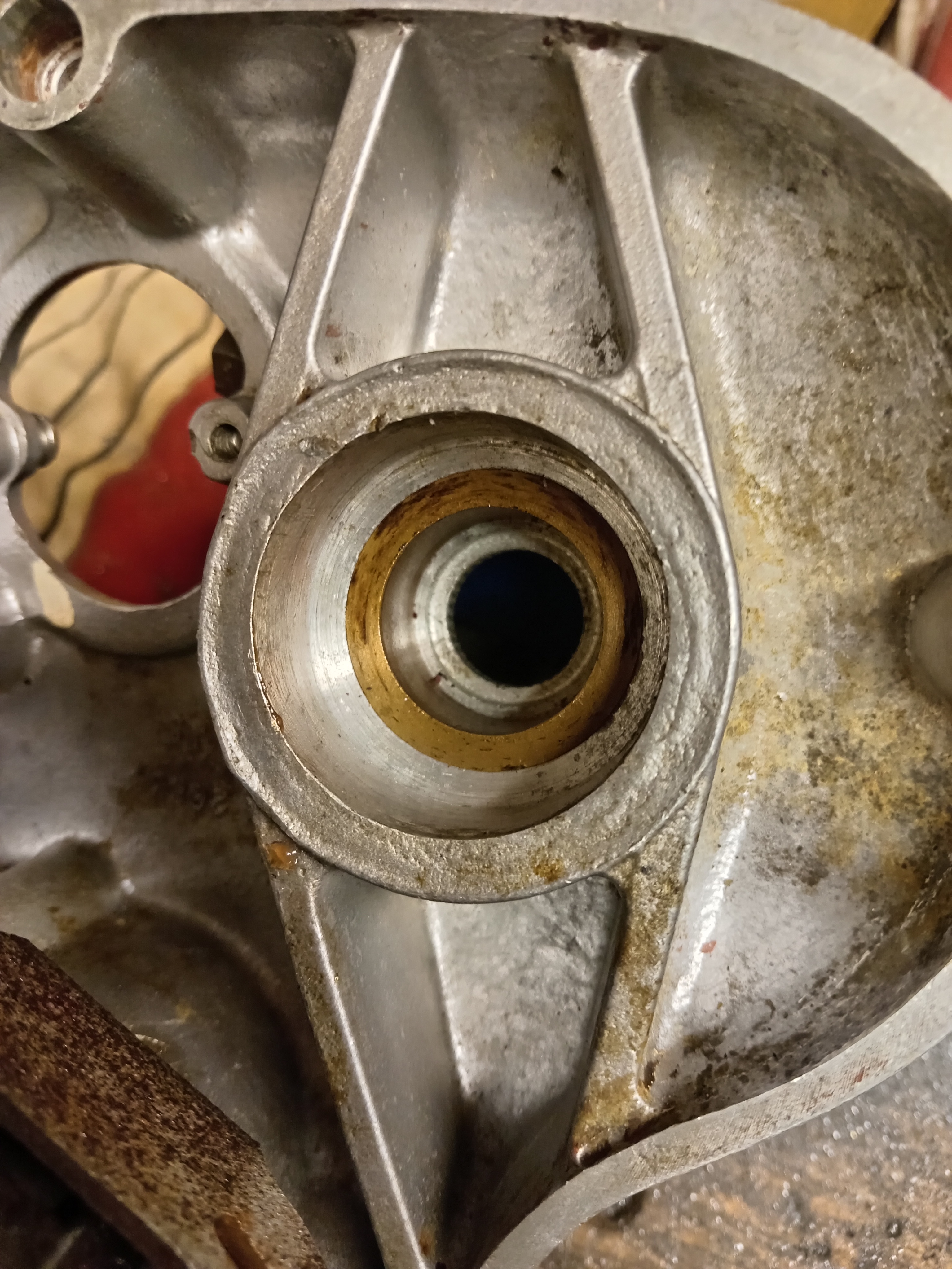

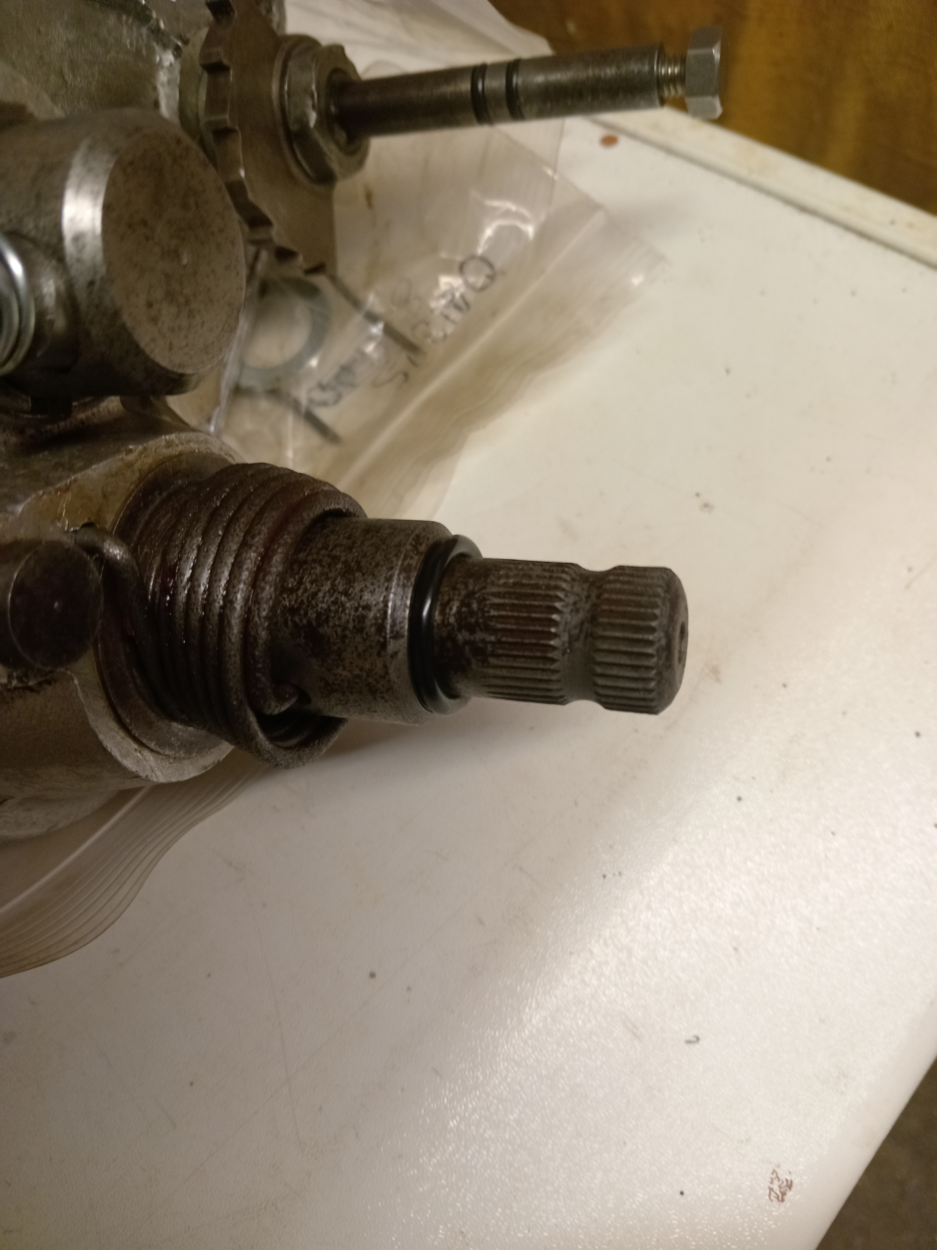

Hi. My Navigator gearbox had all the usual leaks when I purchased the bike. I have now cured all the leaks except the kick starter shaft. I replaced the original o ring set up with a square section seal, but it's still leaking badly. Are there any recommendations as to stop this leak.  Thank you

Can you tell us whether this is the early lightweight gearbox or the late lightweight gearbox?
Inspection/fill cover screws on the horizontal or the vertical?
