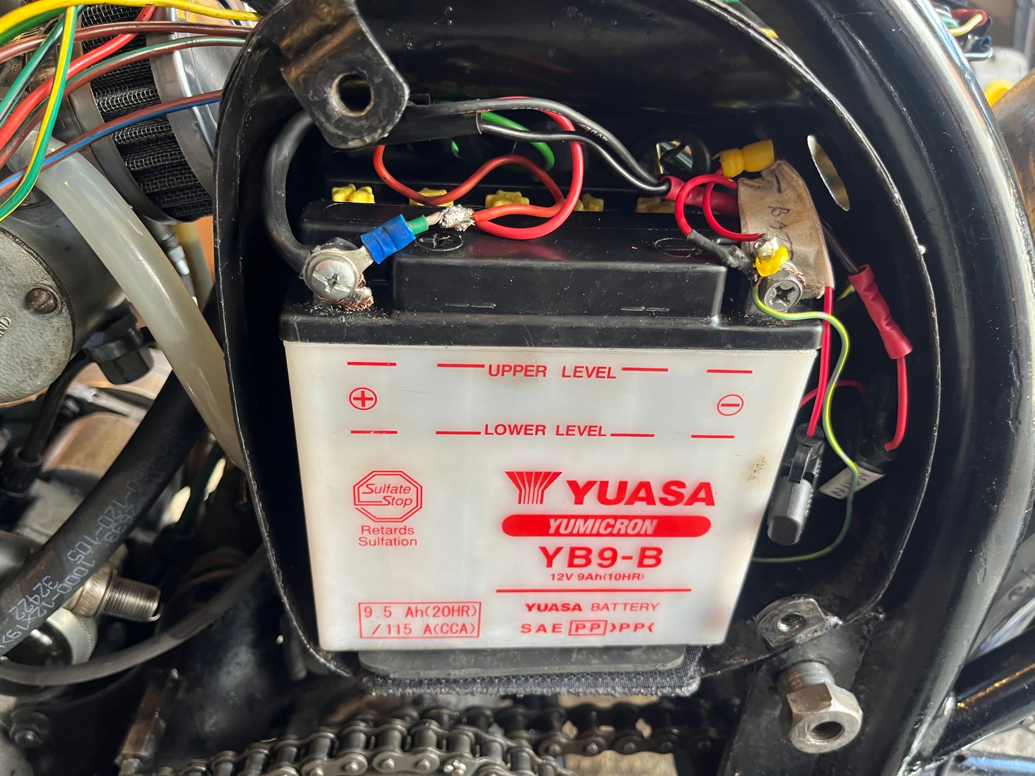

Well, so far I'm pretty pleased with the Thorspark I fitted.
The bike has a brand new battery and I've ensured that there are plenty of earth connections to the engine and frame.

The new battery that you have fitted is a good move, so too the earthing arrangements.
I have an Optimate connected to my battery at all times whilst in my garage which takes good care of it. Due to my low milage per year previous batteries would deteriorate rapidly for me to have to buy another one before I would venture out especially with the electronic ignition dependent on it.

A new or good condition battery and copious double wire earth leads are necessary with these units and the automatic advance retard and centre spindle have to be in servicable condition, also, the cam ring they supply with it has to be fitted to prevent the screw on magneto cover from shorting it out. It sounds tricky but it's just common sense really.

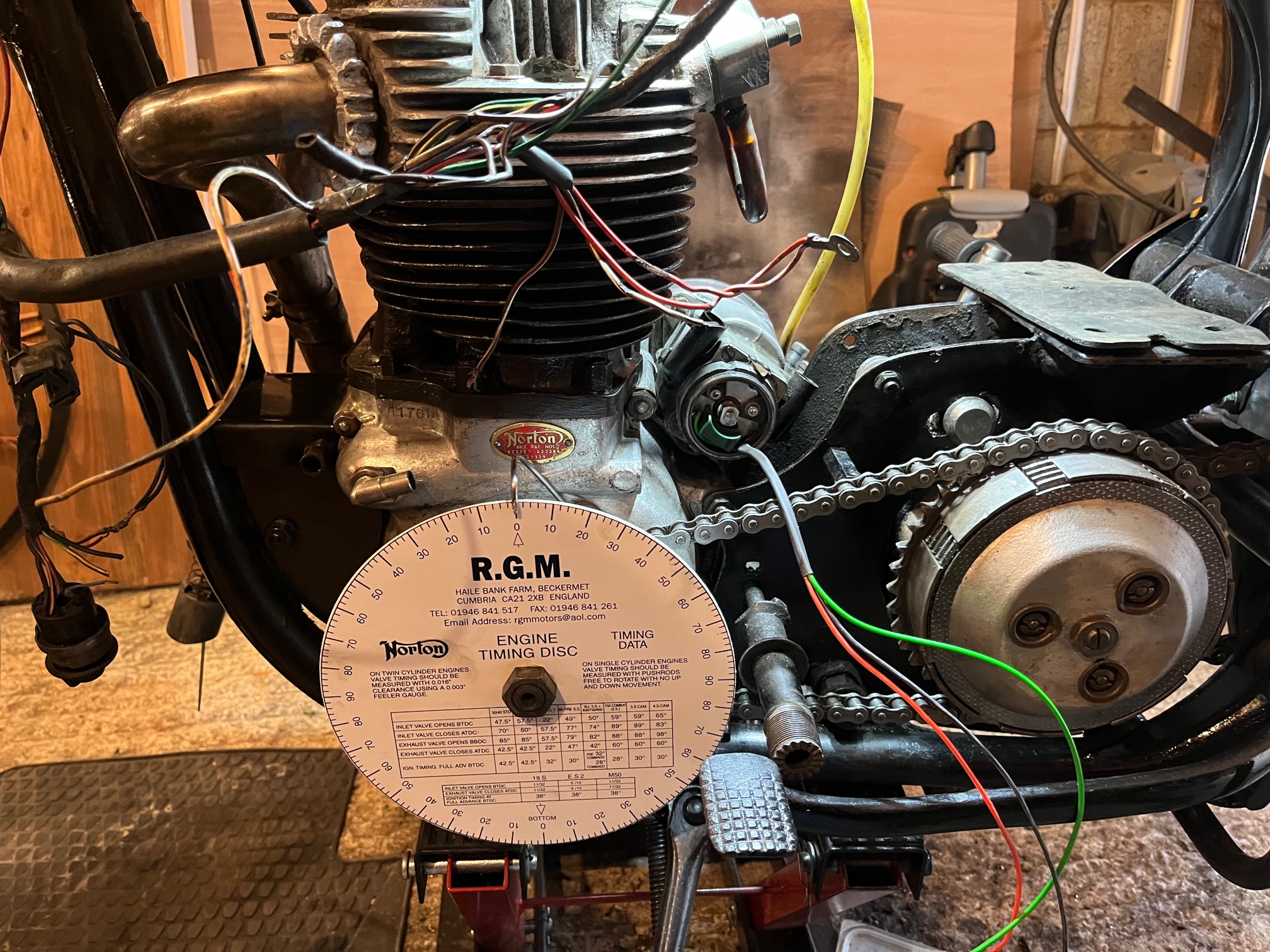

Hi Graham.
I recognise your images!
