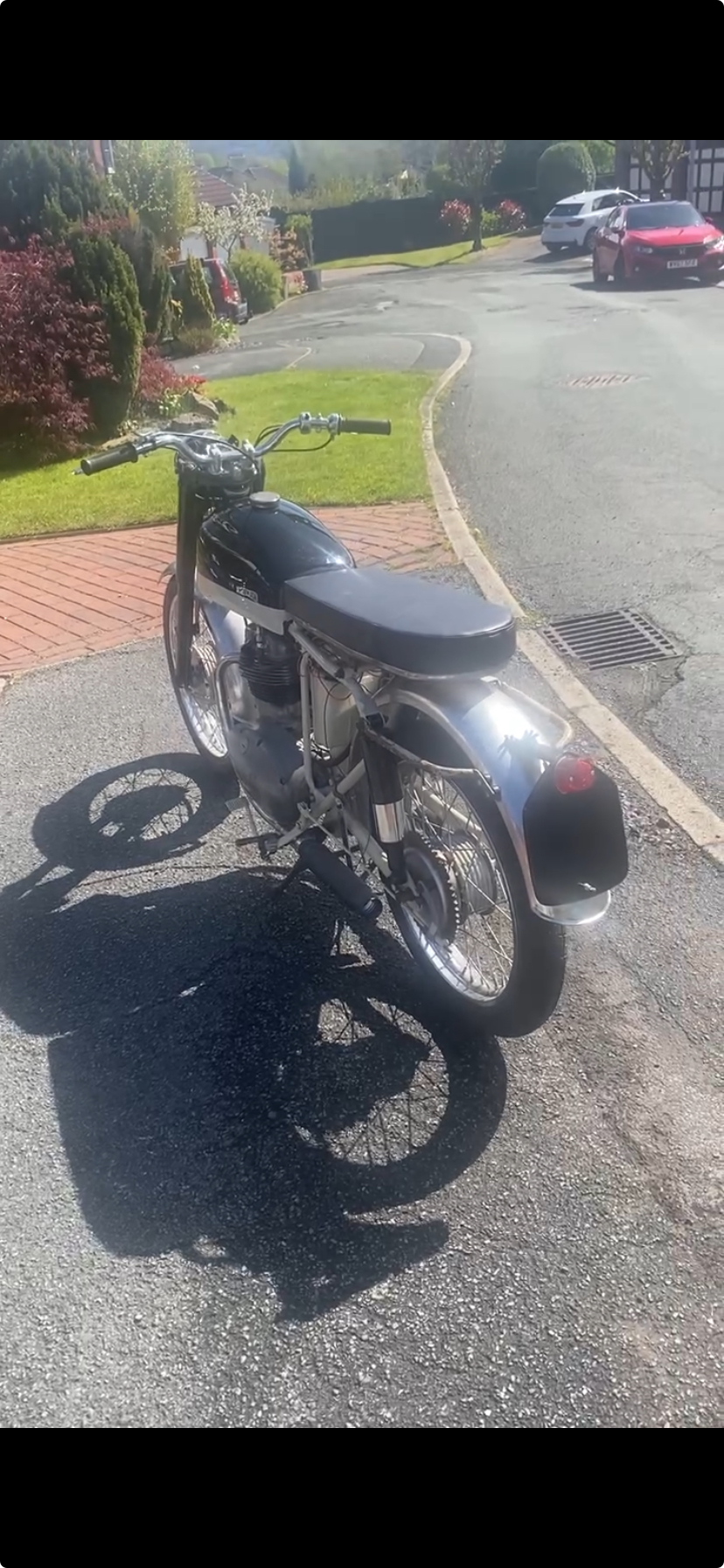

I thought I would add a photo of where I'm up to on this restoration. It's a work in progress and some parts are generic as the bike wasn't complete when I took it over. The most annoying thing is that the lugs that carry the exhaust bracket and pillion foot rests have been ground off, I think that is also where the frame number should be.
It turns out that starting in first gear is the thing to do!
Still loads to work on, but the fundamental requirement of a motorbike has been achieved.
Stand by for further questions on all sorts of stuff!
