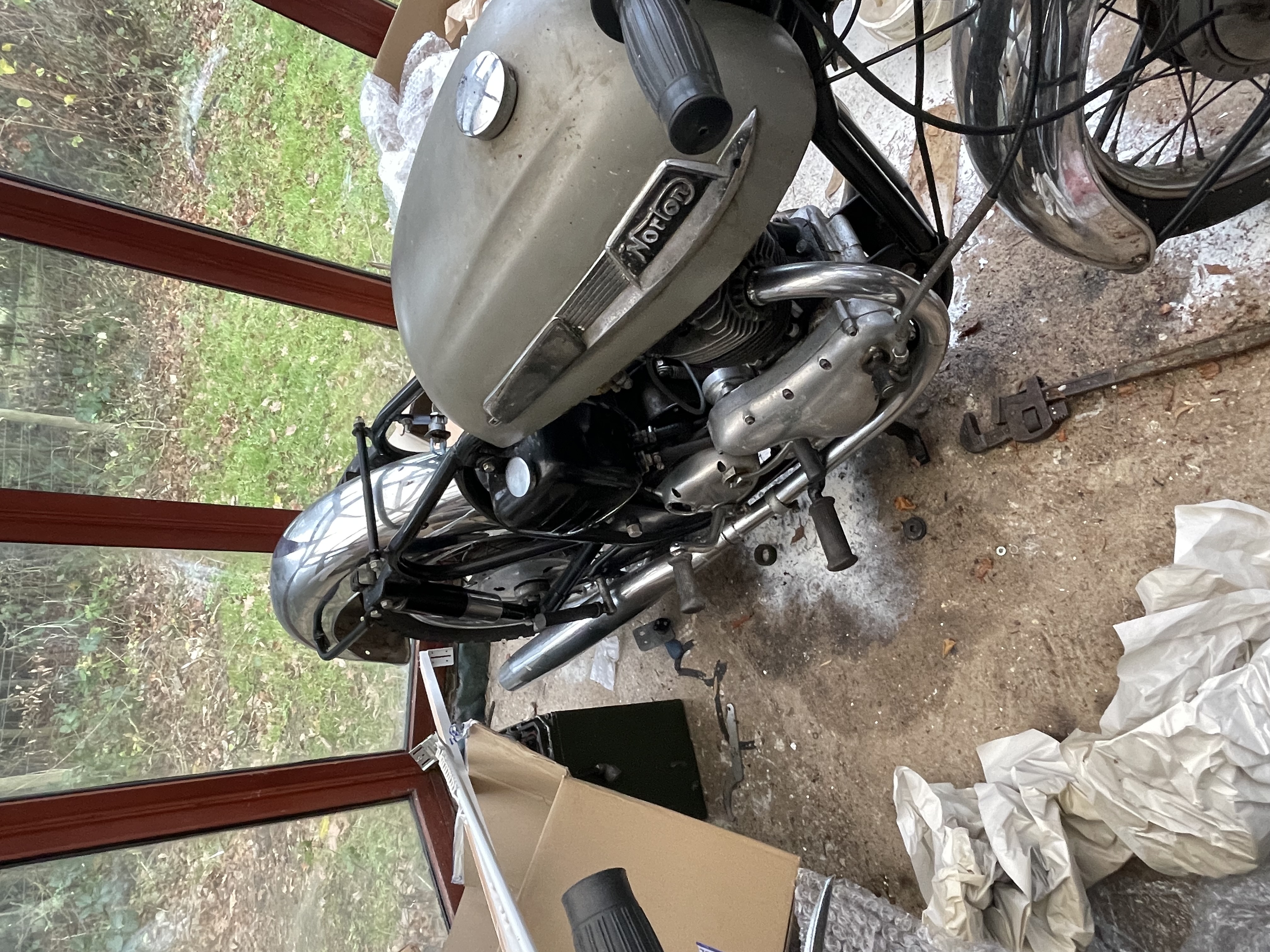

Ok. Just had first chance to look over the bike and it’s a bit grimmer than I thought. Might as well be a barn find not a conservatory find.

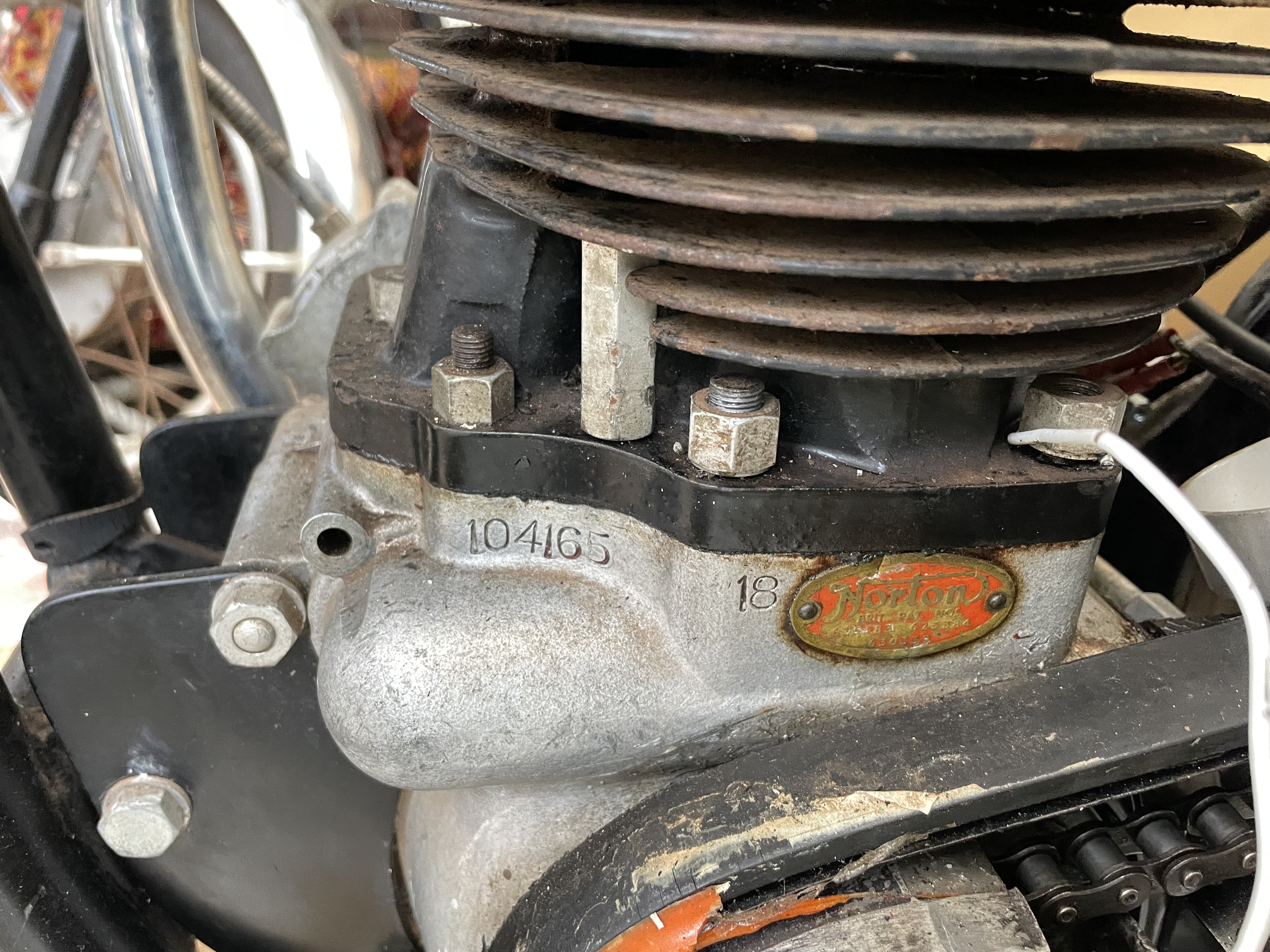

It’s apparently a 1966 650 ss engine in an  Atlas frame. I can’t verify that but have no cause to doubt that info. Is this an issue?
The bike turns over but clutch plates are stuck. Carbs look proper sticky. There is oil and petrol in the respective tanks but She may have been stored for over 40 years. I certainly recall seeing her last back around 1975.

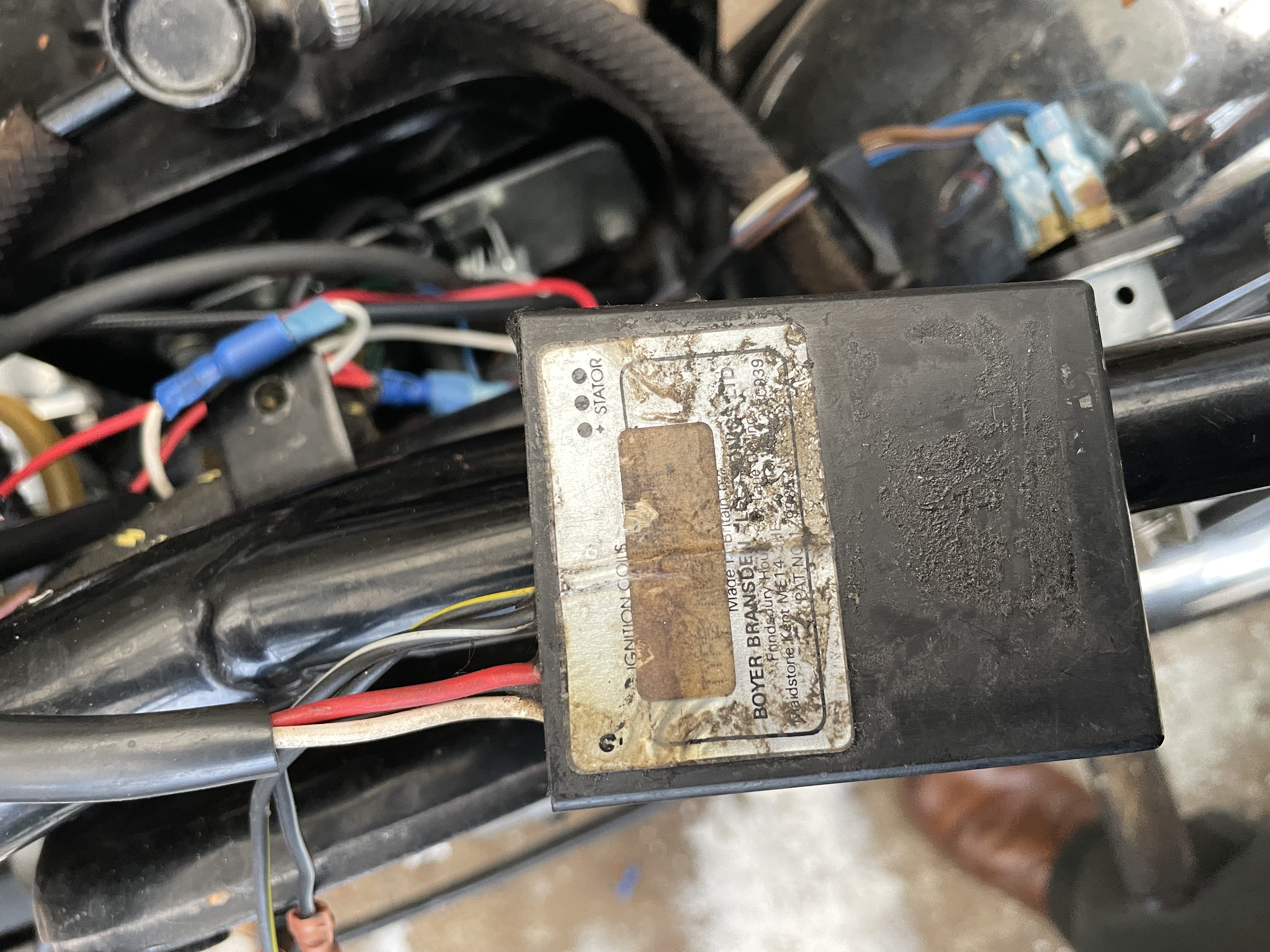

Any idea what the ignition set up is? Hopefully I can get spares. I do have the magneto but would prefer to keep the twin coils.

Does not look too bad.  The bike is 64 or later probably. The ignition is a boyer which needs a charged battery . and might not need to be messed with. the clutch will need to be dismantled and washed in petrol and re asembled . Might need internal rubbers changing .Will need a proper service , brakes and tyres checked. Join your local branch.
Some more photos - I think it’s a 1962 engine using Roy Bacon’s data.
Yes - a Boyer - thanks - but I can’t decipher the model number - any ideas?
I think there are issues with the head holding down fixings ,barrel fixings and  also a missing case stud and nut. with these 3  obvious  and simple  errors i would not be confident that its been properly assembled . Get someone competant to look around. looks like it was thrown together to be off loaded.  Where are you based ?. Clutch cable is likely too short to allow proper set up for internal clutch lever and pushrod ,very poor clutch cable run, Alternator stator  fitted in reverse . think its not connected?.All good clues as to previous owners competance. Still a good project that will make you an expert, (sooner or later!). You want more problems ?, give me more photos !.

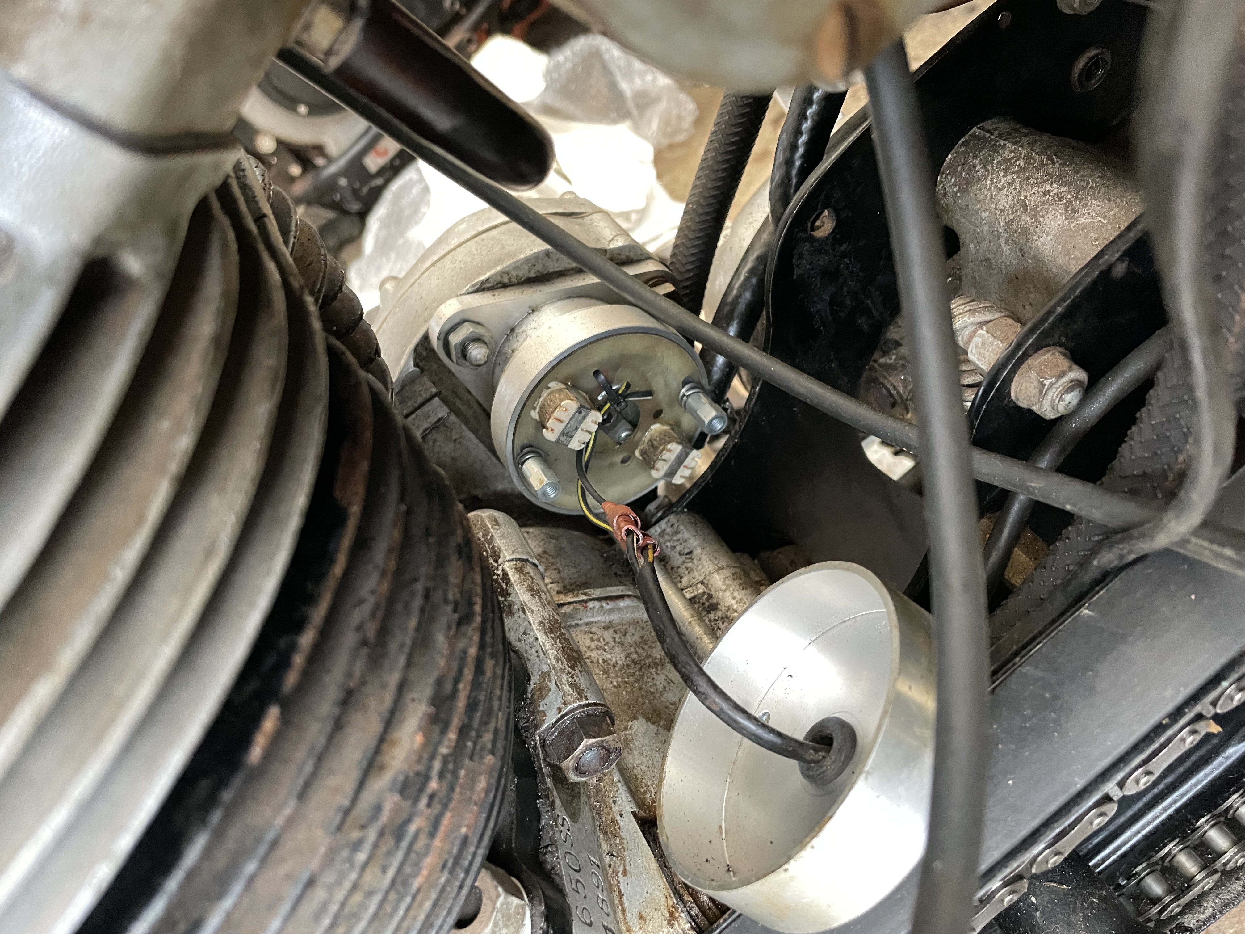

The rear cylinder base nut has a stiff wire under used as a pointer for a timing disc? Alternator wiring is with a domestic 3 core cable with some dubious looking soldering at the coils.  It looks like it’s been kept going my an enthusiast, but to be confident of a reliable machine later be suspicious of all non original work.  But as already stated doesn’t look to be a difficult rebuild, quite complete, but in need of thorough checks.

I think the alternator is the right way round.  The white wire looks like a timing pointer.  The second base bolt from the front is wrong.
The alternator doesn't have a right or wrong way. Except that the wires must stay away from the P chain. And the gap rotor/stator must be 8 thou or more. The model of Boyer ignition is NOT critical if it sparks go for it. The alternator looks like the 1962 or early, this is NOT an issue. But it is a bit tired (we all are after 70yrs). Alternator life, working etc leave till the rest is done. The machine is 12V good, but after 10 yrs of doing nothing a new battery will be in order. DO NOT worry about battery charging at this point. Get the engine running and the clutch, then worry about oil and tyres. If the battery is new and/or well charged the bike should be ok for a 50 mile gallop to see what works or not. WHEN the engine runs nicely and the throttle works full range and all the gears are there and the oil goes round every where it is supposed to and nowhere else! Then worry about the battery charging. You said in an 'Atlas frame'. The frame 650SS and Atlas is identical. Alternator good/bad can be sorted as a separate issue in due course.

Hi Alan , the official Norton line is that the alt leads must face the engine ,probably to avoid the case contact and they do say that it wont work correctly if reversed. ! . I dont see why either .
The Lucas (and Wipac) permenant magnet alternator is a coil of wire with a PM wizzing past it, it does not know which direction from or going so the idea of 'won't work correctly if reversed' is nonsense!
Would be 20 for an Atlas, 18 for a 650. It’s on the left gusset plate just above the footrest. Take a look in the online Library for good information on your type of machine. You got some weeks before you need to be road ready  so just go through it end to end like any machine and  ensure it’s all there within acceptable wear limits and lubricated as appropriate.  Make a list of bits to improve, you will have a fine machine in the end.
