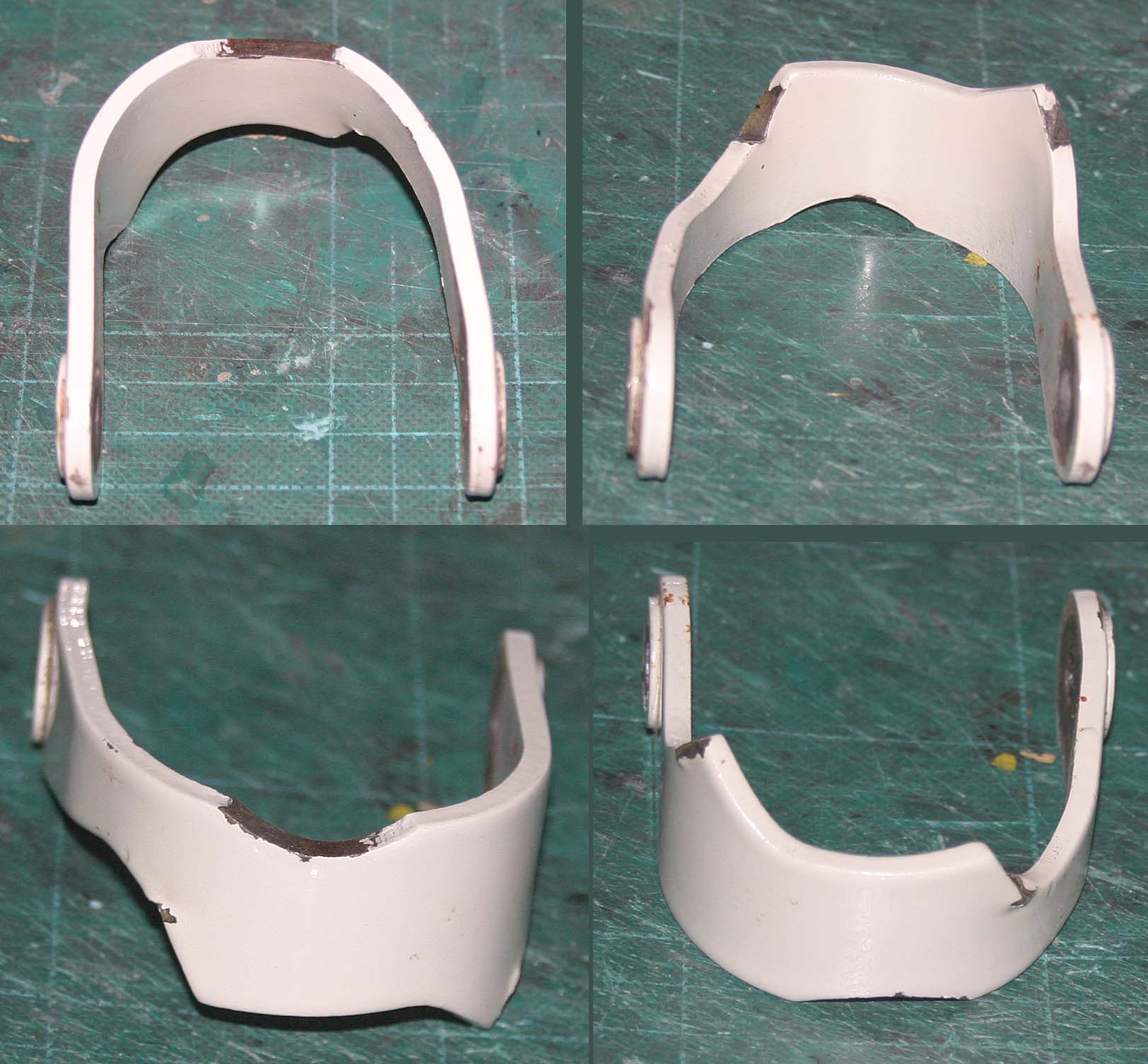

I have removed the plate and it looks like an out of shape version of the one in the shop.
Can any one explain the odd shape as the bottom yoke looks symetrical and I would expect the forks to travel the same each side.
Stan

Thanks for the reply, I had actually figured out it was well out of shape and that as I don't have access to a forge and anvil these days the cost of gas to heat it and reform it would cost as much as a new one. So one has arrived, was tested, painted and got fitted this afternoon - all good now.
I just wondered why the two sides were not the same shape as one is deeper than the other and to me not logical as the yoke looks symetrical and I expect the forks to turn the same both ways.

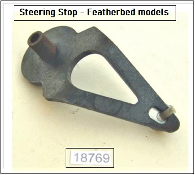

Your forks are symmetrical UNDERNEATH the lower yoke - have a look, and there will be two bump stops in the same place underneath on both sides. The Featherbed frame steering stop thus is the same on both sides. See picture below.
Lord only knows why the lower yoke is assymetrical, forcing the Navi steering stop to be different both sides.
steering Stem

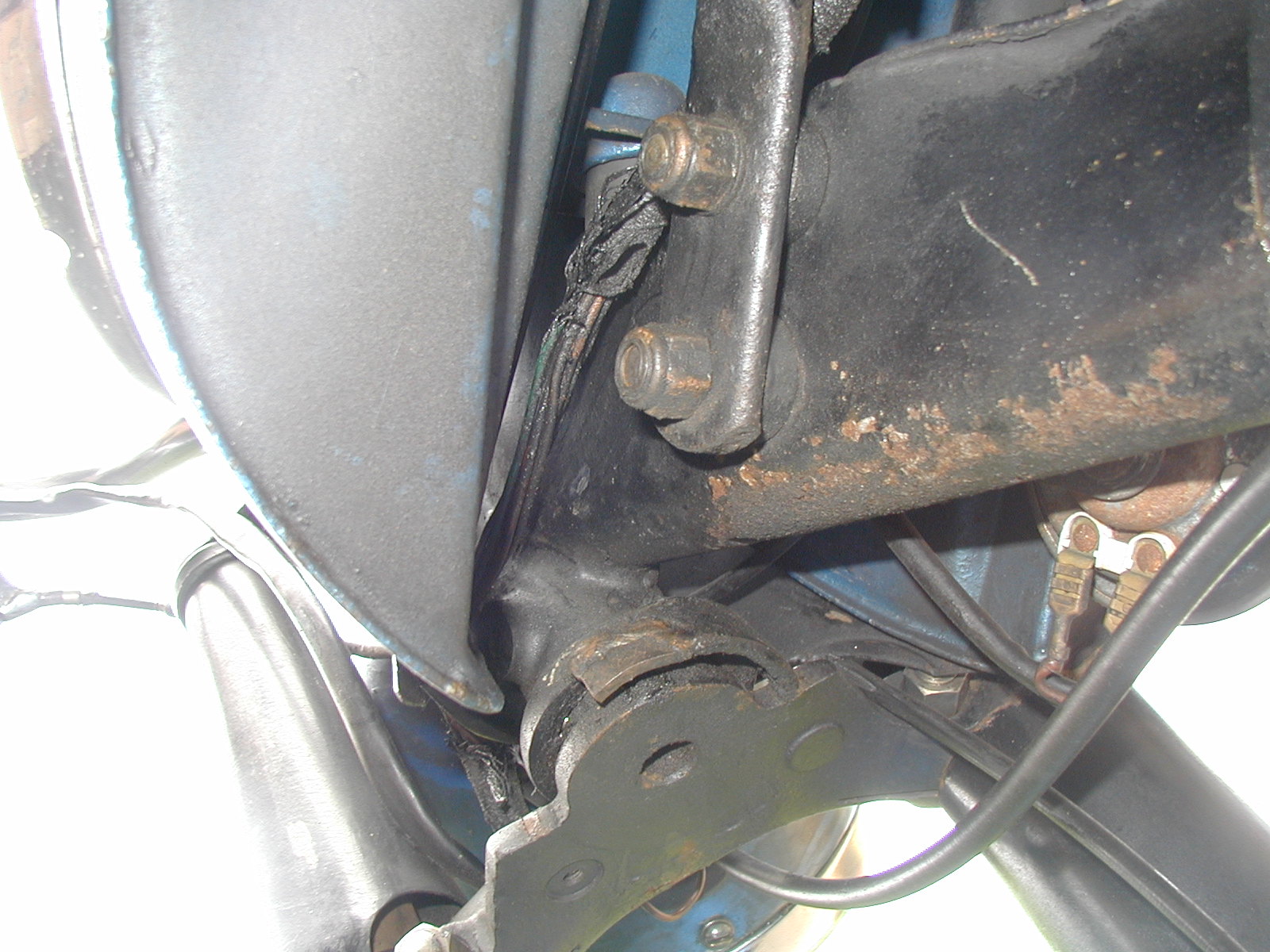

The bottom yoke is symmetrical, and the steering stop takes the form of a welded piece (often broken off) on the back of the lower headstock - at the rear of the lower head bearing - see photo of mine attached (inc repair I had to make):
Thank you Andy, good to know I don't need that part. Also your uptank (!) shot is very good, from what I recall last time I saw my frame it had this welded item in situ.
