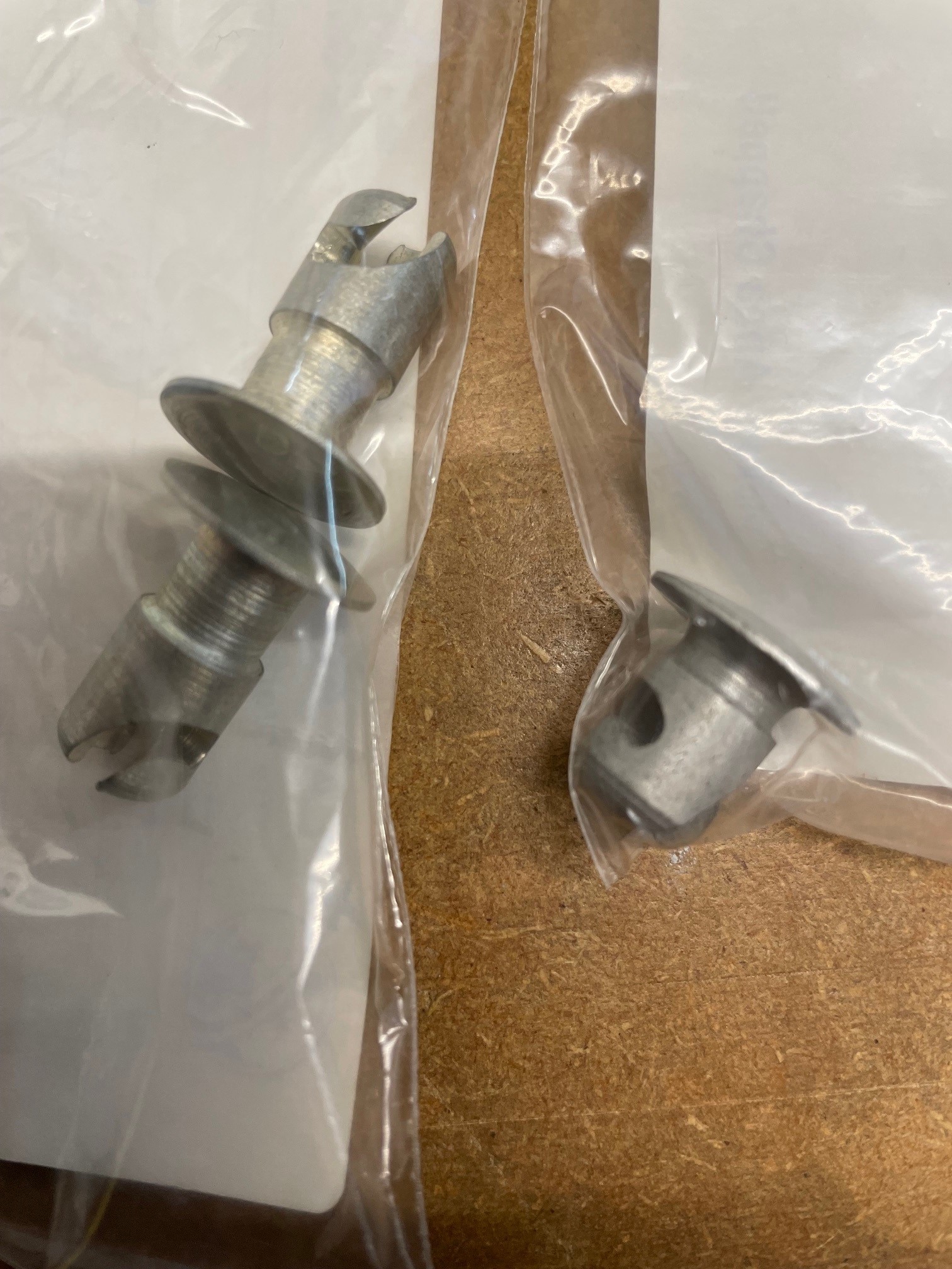

Hi Robert for the "short"…
Hi Robert
for the "short" ones (front and bottom fixing) I got A6-35 - they were from 2 x batches, one zinc plated and the other batch cad plated - but I'll just get them replated along with other stuff
for the "long" ones I got AJ6-60
the J means a longer undercut - ie the slimmed down part under the head
I've attached a picture (fingers crossed) of the ones I bought
they both fitted perfectly for me
