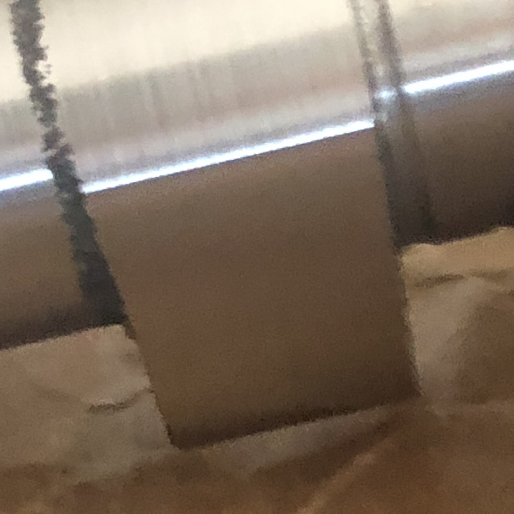

This is a difficult one to photograph - what I'm trying to show is the ground profile 'blend' of the ramp to the base diameter - there's not much of a blend! This is the first new camshaft I've ever bought - should it be so? as I wonder whether it will be a harsh point on the followers.
What camshaft is it?
What Camshaft is it?
It's a 2S

Hi Martin,
The valve needs to open and close at a graduated rate so the valve gear is not over-stressed. Cams with extensive profiles (ramps) are used with flat profile followers and the ramps provide the gradual opening and closing action. The cam profile you have are used with radiused followers and it is the profile of these followers that provide the gradual action. If you have bought the camshaft from a reputable source, there shouldn't be a problem.

Is there a definite 'line'…
Is there a definite 'line' between the base circle and the flank of the cam? The ramps of a cam lobe are usually quite short, not very wide at all. The nomenclature used when describing cams can be much mistaken. The ramp is the bit between the base circle and the flank, often described as the 'quietening ramp' Which is a bit funny when hearing these engines run! The flank of the cam is where the majority of the valve lifts occurs. I've never heard of the 2S commando cam requiring radiused followers.
From the drawing the 2S has…
From the drawing the 2S has its base circle removed to enable it have a clearance circle which is different, it looks like the clearance circle has been ground after the cam has been ground. This would produce a ridge of about 0.009'' in height.
The photo is not good enough…
The photo is not good enough to make a good comparison but my new 2s has an definate change of direction but no step or sharp line at the end of the base circle . While we are talking 2S cams , When i rebuild my 99 who thinks a 2S would make any improvement on the std 60 Daytona ?, normal classic use ,mid range the important area.
