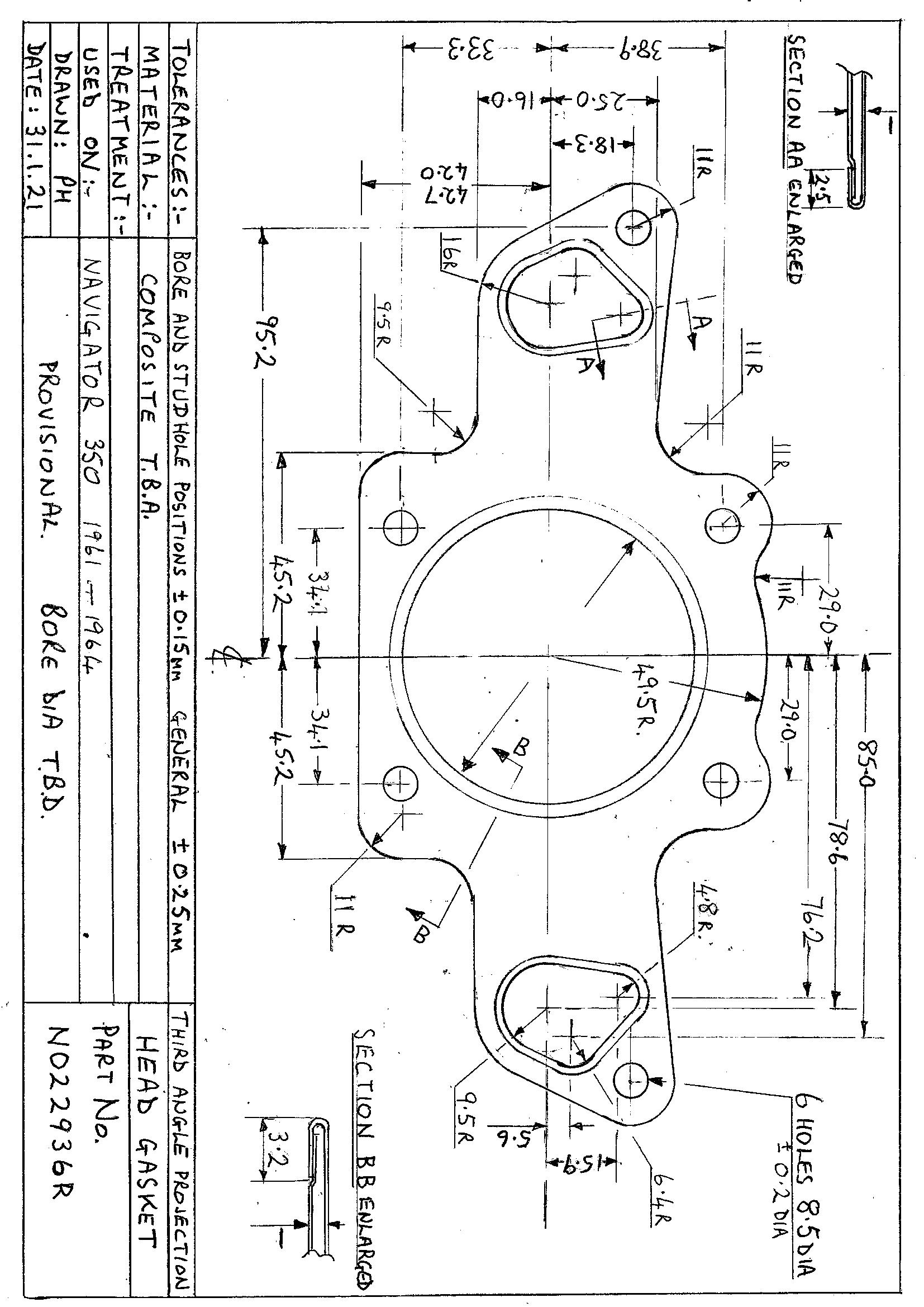

Navigator Cylinder head gasket Bore size?
I've done a drawing of a gasket for the 1961 - 64 Navigator. These machines have a spigot on the top of the cylinder which engages with a circular recess in the cylinder head.
The bore of the gasket has to fit over the spigot.
Is there anyone out there who has a Navigator cylinder accessible and a digital caliper. Can you give me the outside diameter of the Navigator spigot? I'll add it to the drawing attached and see if I can get some quotes.
Unlike the original gasket, this one is to go under each cylinder head and will allow owners to change one gasket without disturbing the other cylinder. Tooling costs should be less, but you will have to buy two for a top end overhaul.
Thanks for your help.

Gasket Bore Size
John, thank you for taking the trouble to measure the barrel. 2 23/32 inches in old money.
Tony, thanks for the drawing information. Can you confirm that drawing 22835 is a head gasket for the '61 to '64 Navigator? Not a base gasket? I've got part number 22936 listed as head gasket for Navigator.
The base gaskets are a very close, too close, fit on the long barrel spigots and if my experience is anything to go by, too tight for a head gasket.

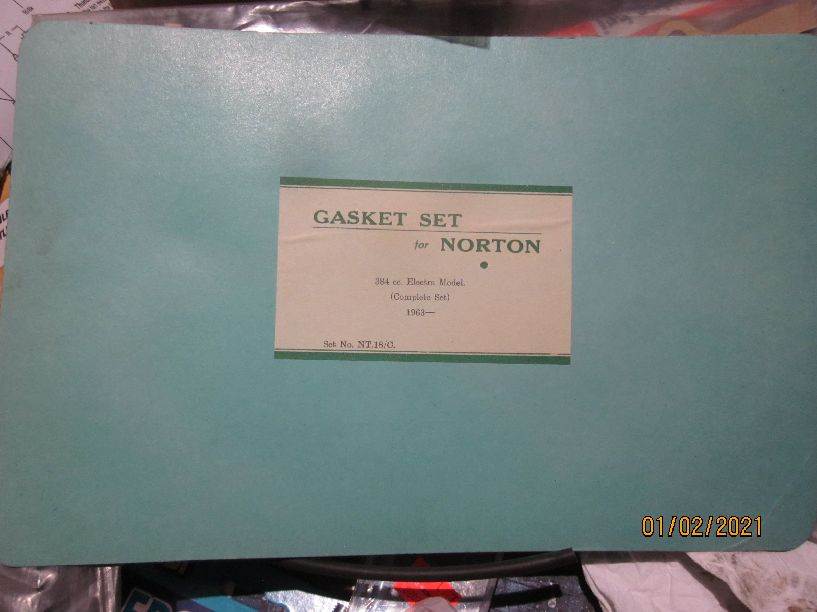

Navi Head Spigots & Gasket Sizes
Hi Peter,
I just pulled a Navi barrel off the "assembly line".
The spigot measures 69.00mm on both sides - (Tony R. - above - suggests the tolerances were 69.04 - 69.11mm), but I have seen since that this tolerance was amended to 68.99 - 69.11mm.
The lower spigot (into the crankcase) measures 69.50mm.
I also checked three NOS gasket sets - 2x Navi & 1x Electra. (see photos)
Navi Head gasket - cylinder spigot clearance hole = 69.80mm on both sides.
Navi Base gasket - bottom of cylinder clearance hole = 70.00mm on both (Example 2 gave 72.00/72.50mm) - Sadly, I only had 1x Navi Head Gasket to measure.
Electra Head gasket - cylinder clearance hole = slightly tighter at 69.20mm on both sides.
Electra Base gasket - bottom of cylinder clearance hole = 74.00mm on both sides.
Hope that helps!
