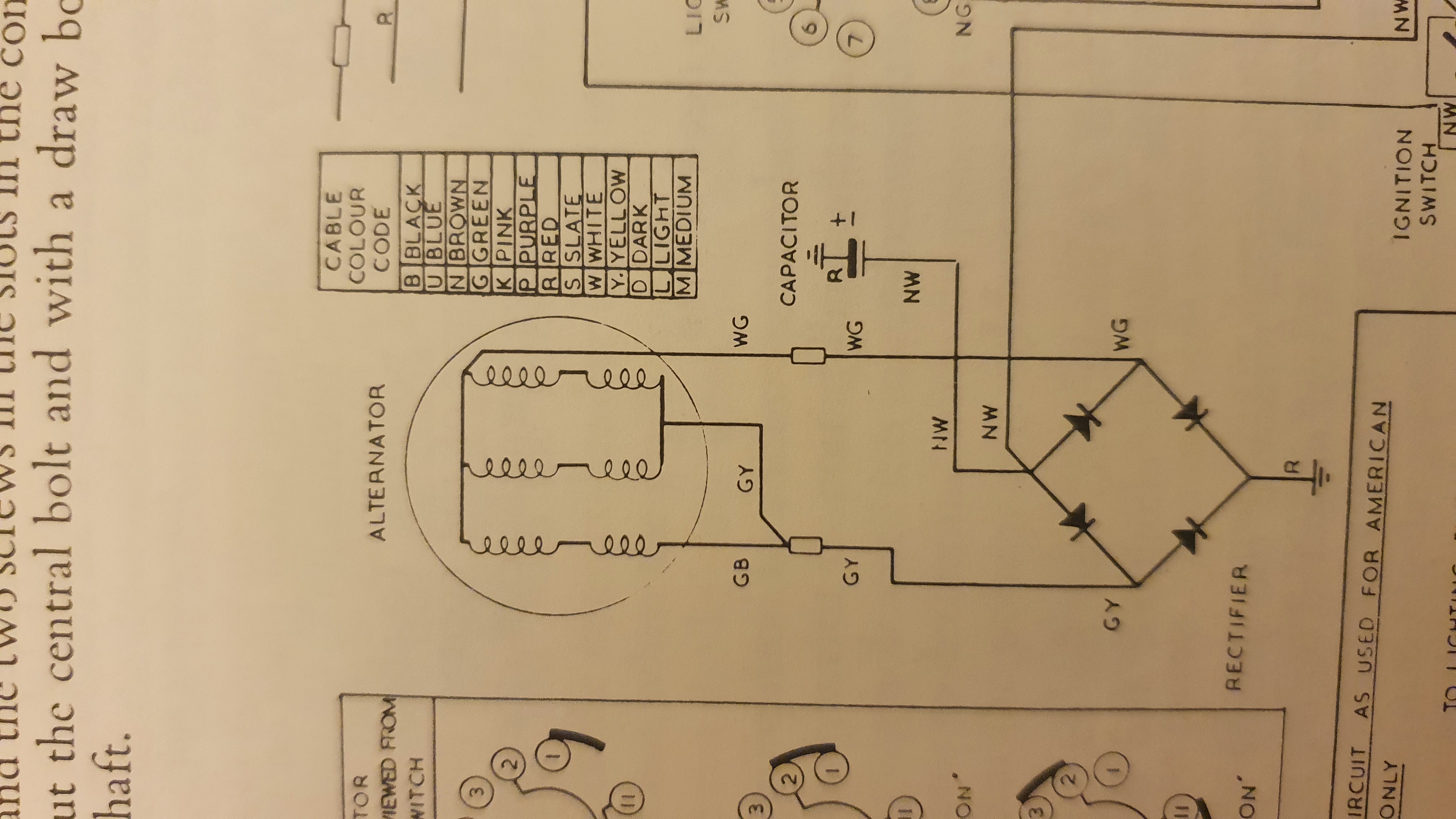

This extract from one of the wiring diagrams might help you to decide why some pairs chosen from three wires will have different resistances.
If your wire colours are the same (they did change), then if GB to WG has resistance "R", then GB to GY will have "R/3", and GY to WG will have "R/2".
But resistance from terminals to earth goes through the rectifier...which should be small or zero one way and large or infinite the other way, regardless of the rotor.
You do not have the rectifier in circuit when you are testing resistance of the stator. The figures you have are good enough to use the stator. If you want to check the output current of the stator then you use a Bridge Rectifier, not a regulator rectifier.
