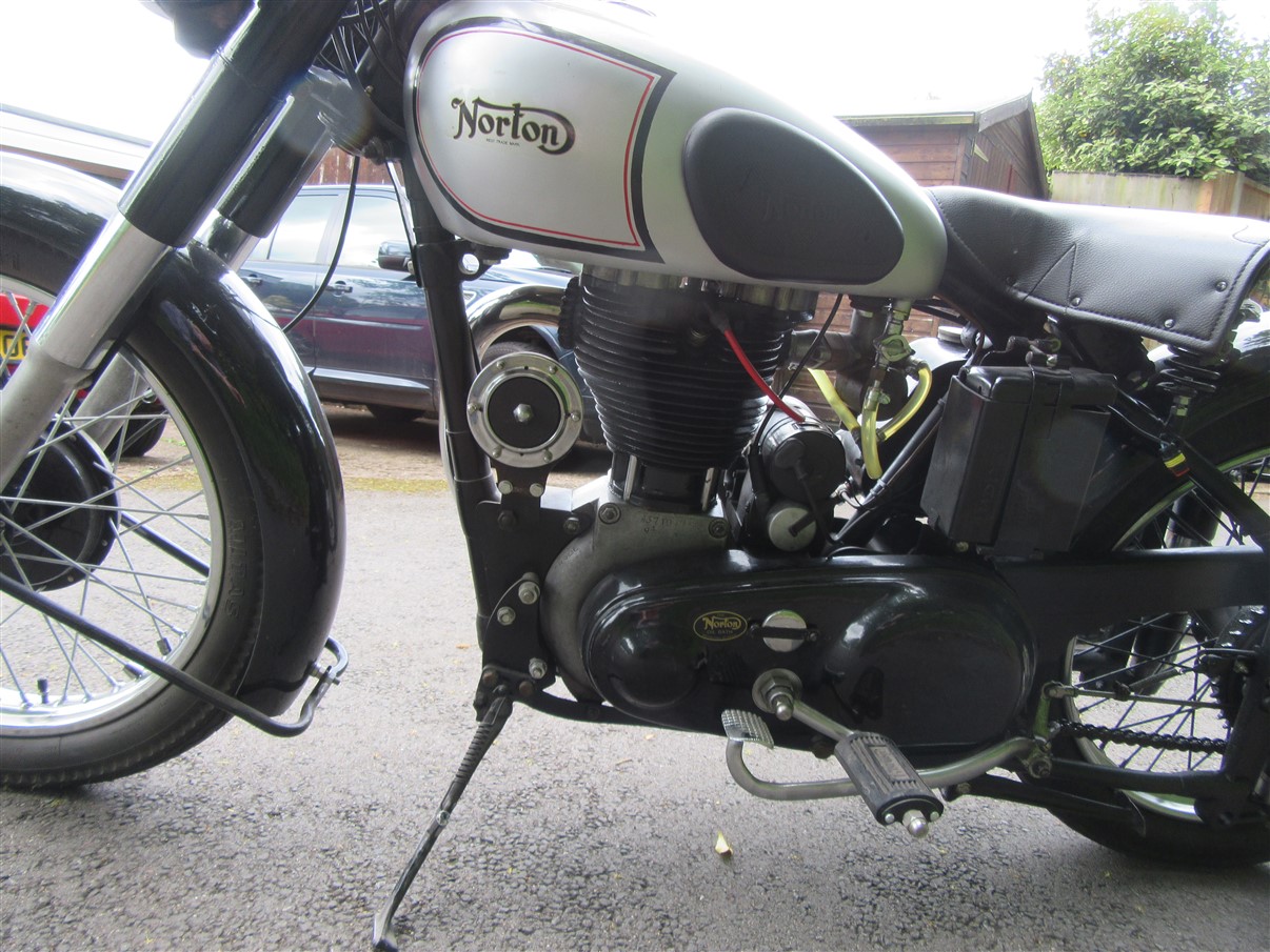

My 1951 ES2 frame (F4 xxxxx) has the horn mounted near the saddle as shown on the photo.

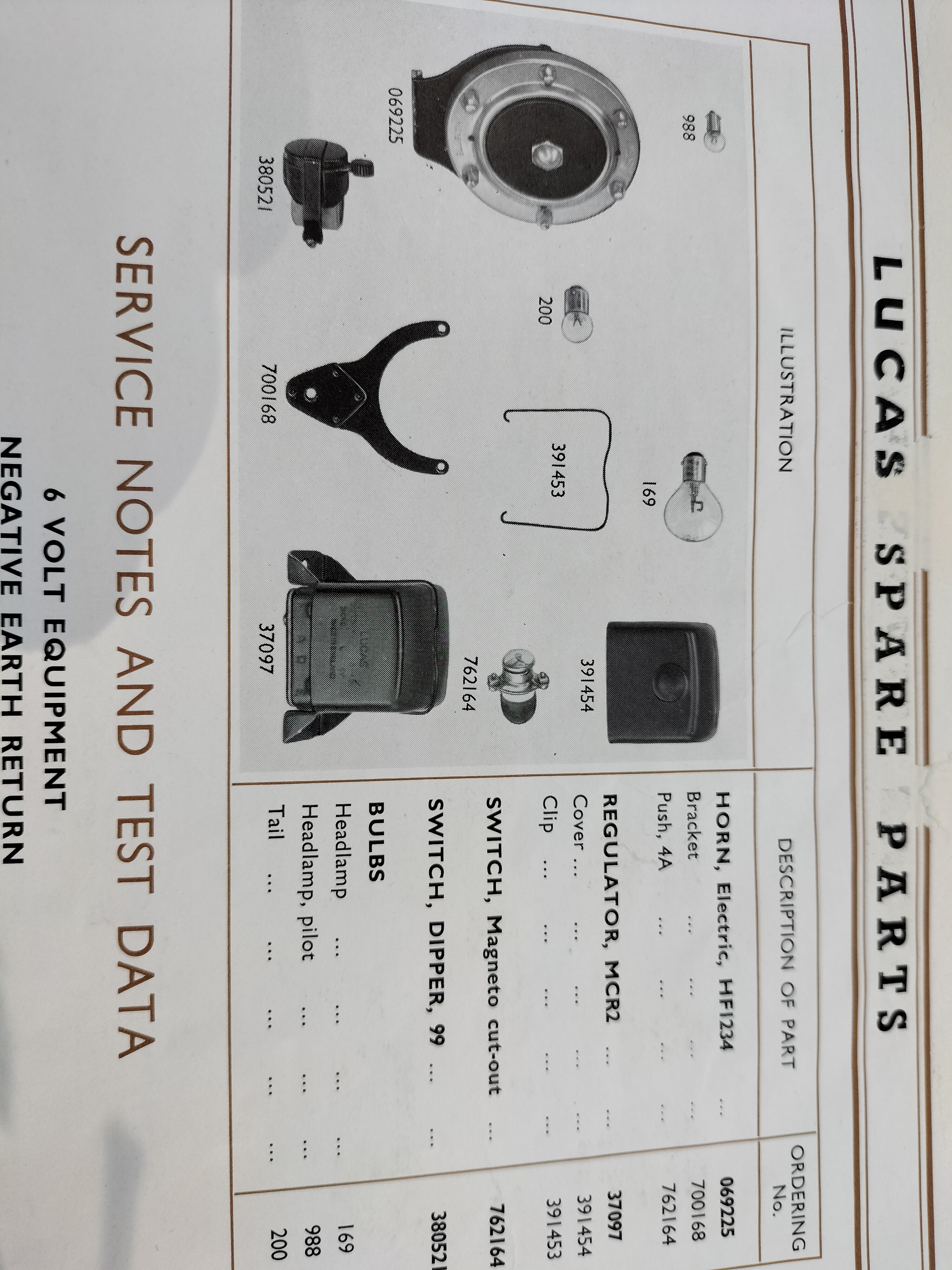

The horn type is a Lucas HF1234 Altette type as shown in the page from the 1951 Lucas manual also attached.
Check your frame number to be sure it's a 1950 onwards frame.
