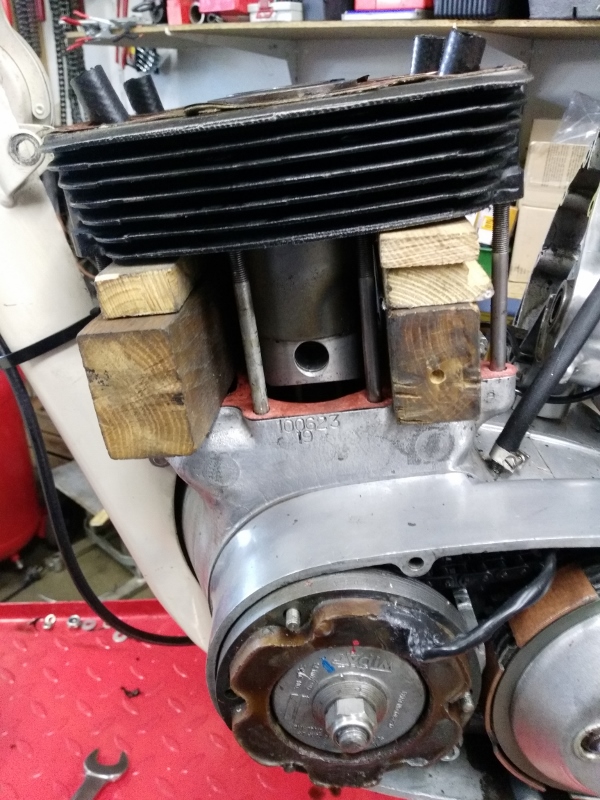

Fitting barrels
This is how I did it: Inserted the pistons in the barrels and supported the barrels with some wood then fumbled the wrist pins into the pistons. Insert the wrist pin circlips on the inner sides of the pistons first.
fitting pistons on a Jubilee
Hi Ulrich & others, fitting pistons before the condod cannot work on a Jubilee, as the conrod does not come up high enough to manipulate it, so you have to fit the pistons to the con rod first. - Unlike the Navi engine in the picture above.
However - it might be a good idea to check that they they do fit first - that the ring gaps are all OK, etc.
The good news about a Jubilee is that you can do one cylinder at a time!
Also, I would only put in 4 studs at first - the ones that go inside the rocker boxes. You can use them to park & manouvre the barrels - whilst leaving room for fingers & nails to do the work
