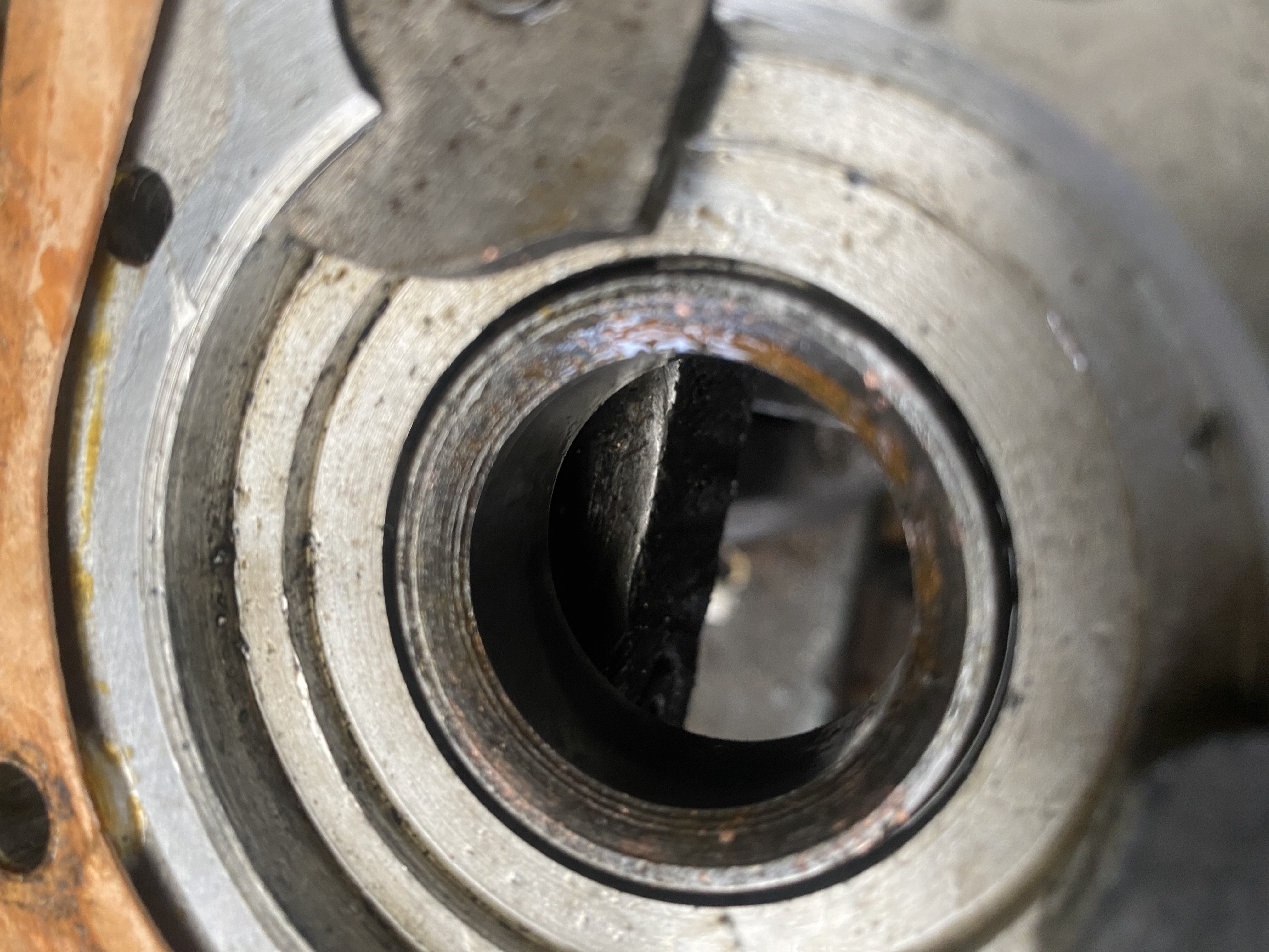

I recently fitted a new kick start shaft, now when I kick it over the back wheel rotates and the kickstart won't return properly. I've had it all apart again and checked that everything is ok ( which it appears to be) but on reassembly it's exactly the same.
I have run it up on the stand and set it to a very fast 'idle' selected top gear and run it for about 5 minutes and it seems fine in as much as the kickstart doesn't try to move.
Any ideas please?

Thanks for the replies Tim, the odd thing is, and therefore I believe the cause of the problem, that I have no endfloat at all on the kickstart shaft(?). I now have the kickstart returning ok but the sprocket is still turning and feels a bit tight, and that's without the outer cover being in place.
Fixed
Tim, I've found the issue and fixed it ! The steel kickstart top hat bush in the inner cover was not fully home ( not something I had touched), I warmed the casting and seated it down and all was ok , end float on the k/s shaft and everything working as it should. Took it apart again removed the bush cleaned everything and put it back with a dab of loctite. Shimmed it up and now ready to fit.
