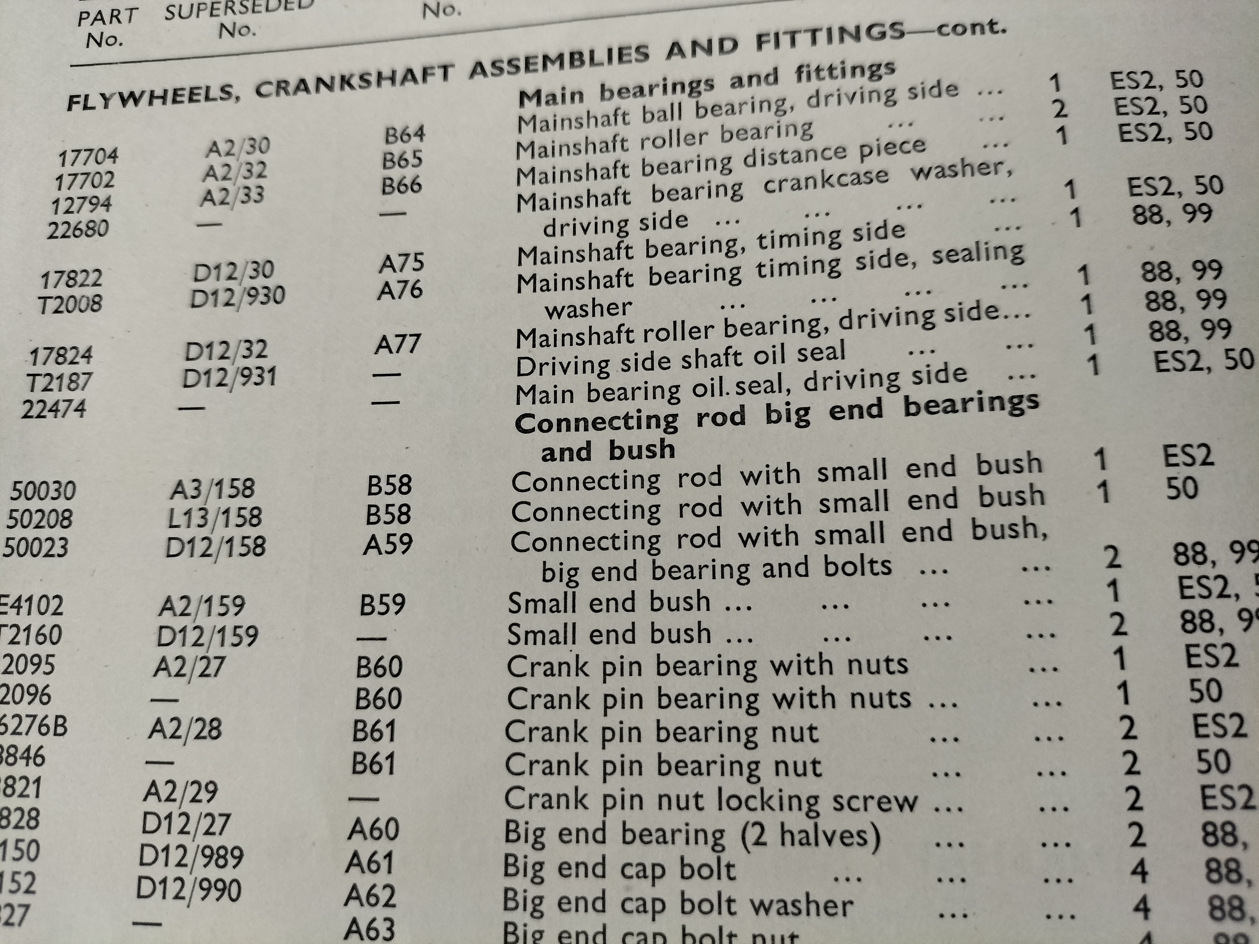

The seal is listed, but not illustrated, in the Spare Parts List for 1959 Models 88, 99, ES2 and 50. It is Publication PS 206.
The part number is 22474 and is listed just above the Connecting rod details as shown in the attached photo.
