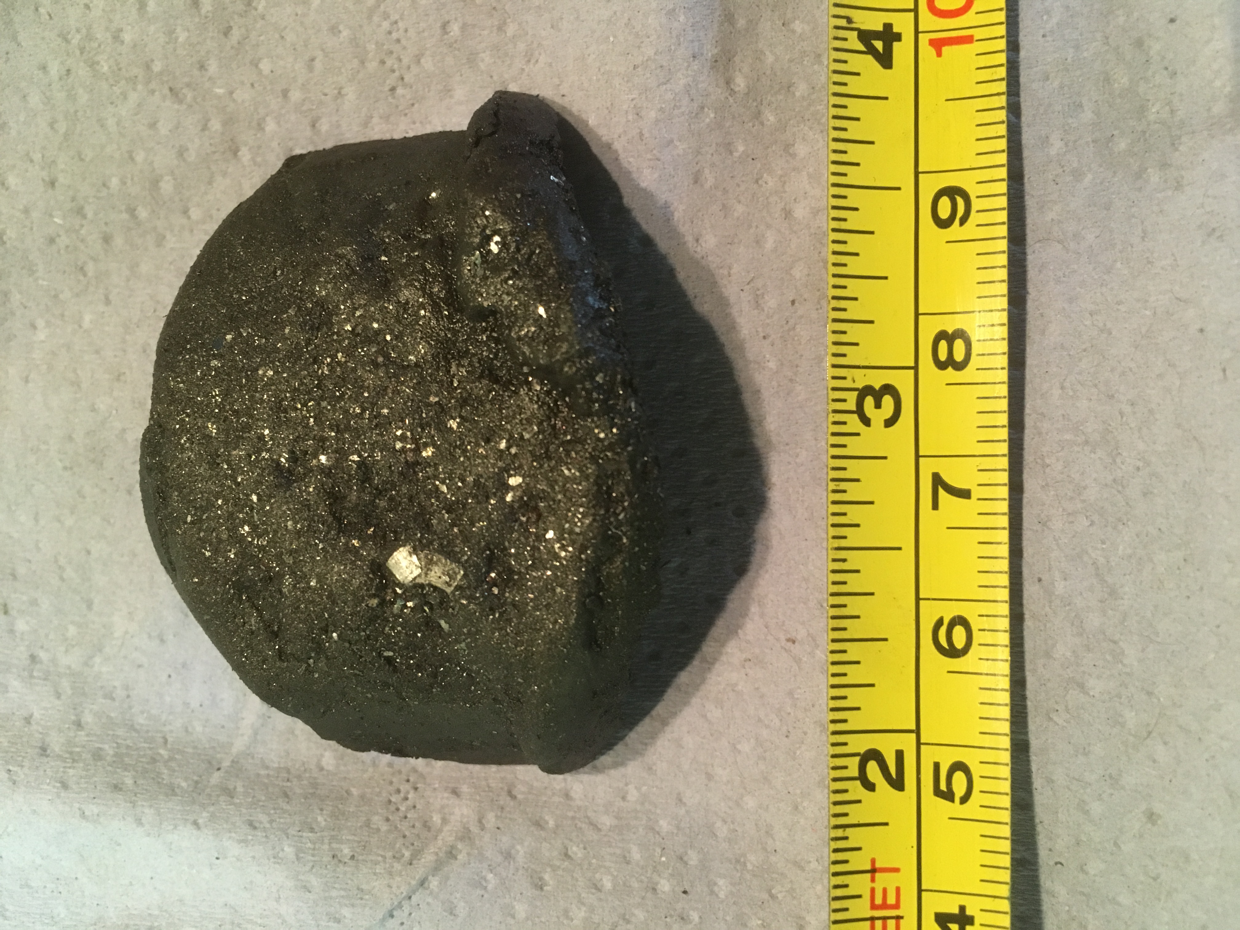

This morning I pulled the crankshaft apart on my barn find Domi 99. In a previous post I mentioned that a large chunk of the drive side oil seal support face in the left-hand crankcase was missing. Well I think I found a lot of it today - the sludge in the crankshaft was solid and much of it sparkled more than Fools Gold. The ‘best’ bit was a chunk of aluminium 5mm long and 1mm thick (photo below). It should make a good doorstop  :-)

The photos looks like the lumps of clinker you would expect to find in the bottom of a steam loco's fire box. It looks like an amalgamation of alloy swarf, tar from old oil and possibly what's left of old oil seals that has turned to concrete over time. If you are really interested you could try to dissolve it in petrol or thinners to find out what it is. Whatever the 'clinker' is it shouldn't have been there.
What's more alarming is the fact that there is alloy present and, from your photo it look like there are some fairly large bits of swarf. You could expect to find some fine metallic particles in the oil from the initial running in of a new engine but not what look like pieces of swarf, When you have cleaned the inside of the crank case a general inspection will soon show where any pieces of the crank case have suffered damage. .
Regarding the thin wire on the crank bolts/nuts. This sounds like the threads have stripped, the wire being the actual threaded part. Whether or not the nuts were punched or not isn't an issue as undoing them would more than likely remove the marks anyway.
Best of luck and I hope there is no serious damage.

Thanks for the reply. The sludge is as hard as stone. The engine has had a very hard life - the bike’s got 91,000 on the clock and there’s plenty of evidence that it suffered a major catastrophe at some point. The barrel skirts were smashed and there are a couple of large gouges out of the inside of the crankcases. Popular opinion is that one or more conrods let go at some point. The bike was then chucked in a shed and that’s where it rested until I came along and paid silly money for it. Oh well, it’s all part of the joy/madness called motorcycle restoration.
