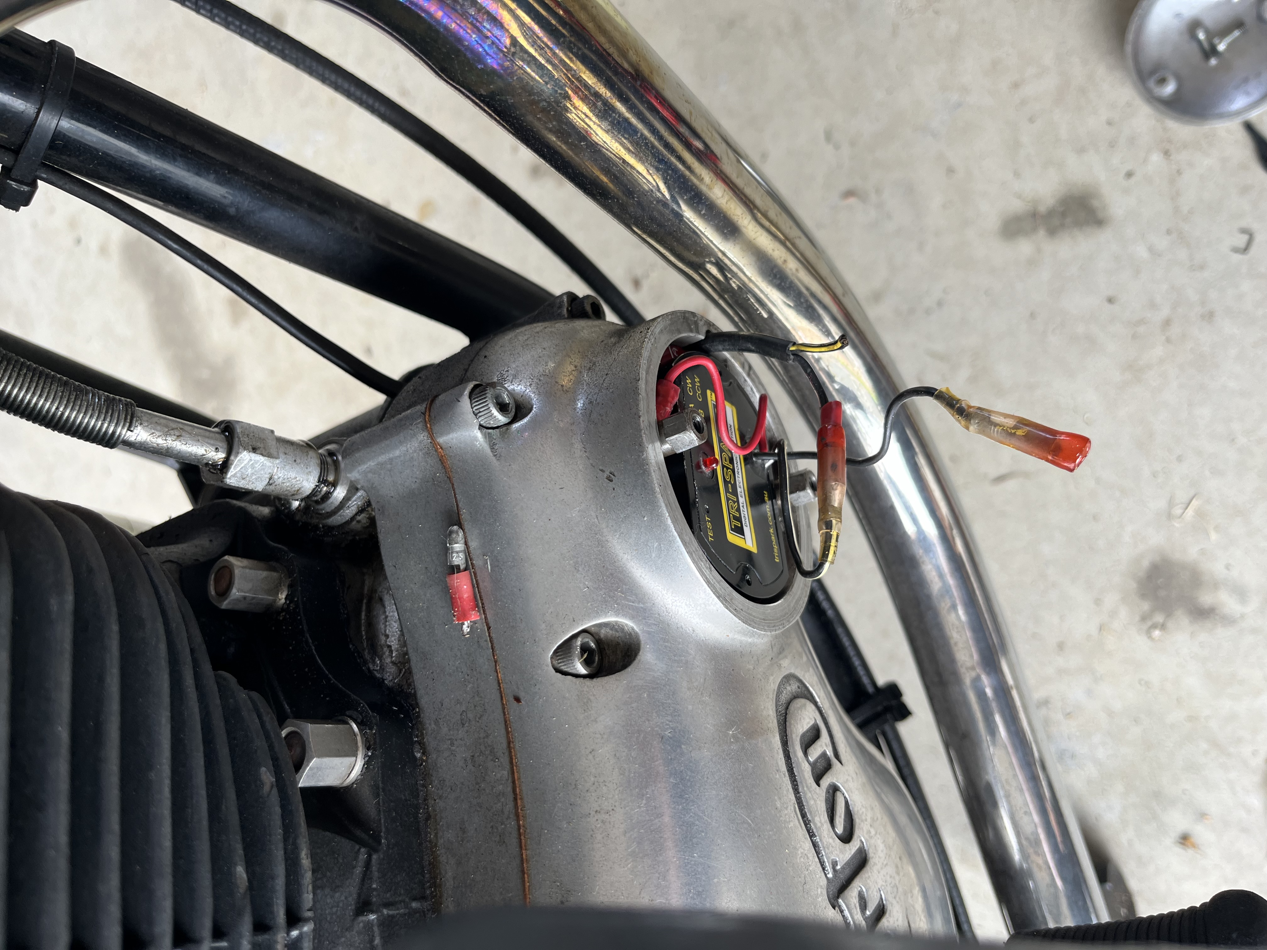

First, see the attached photo. The yellow/black wire from the ignition module to the coil pack was hanging on by a thread. I started it up after repairing the connection and it revved better then came the second problem.

The ignition wire snapping under vibration is very common at that point, especially on Boyers.
Try and get  small cable tie to pull back the wires and stop them moving around to a avoid a repeat experience.

... what happened to my Commando in deepest France one year. Like you I thought it was carburation. I'm astonished that Boyer actually use those horrible crimped connectors. I have Boyer on my Electra and have replaced those connectors with soldered Japanese bullets with heat shrink to help keep them rigid.
