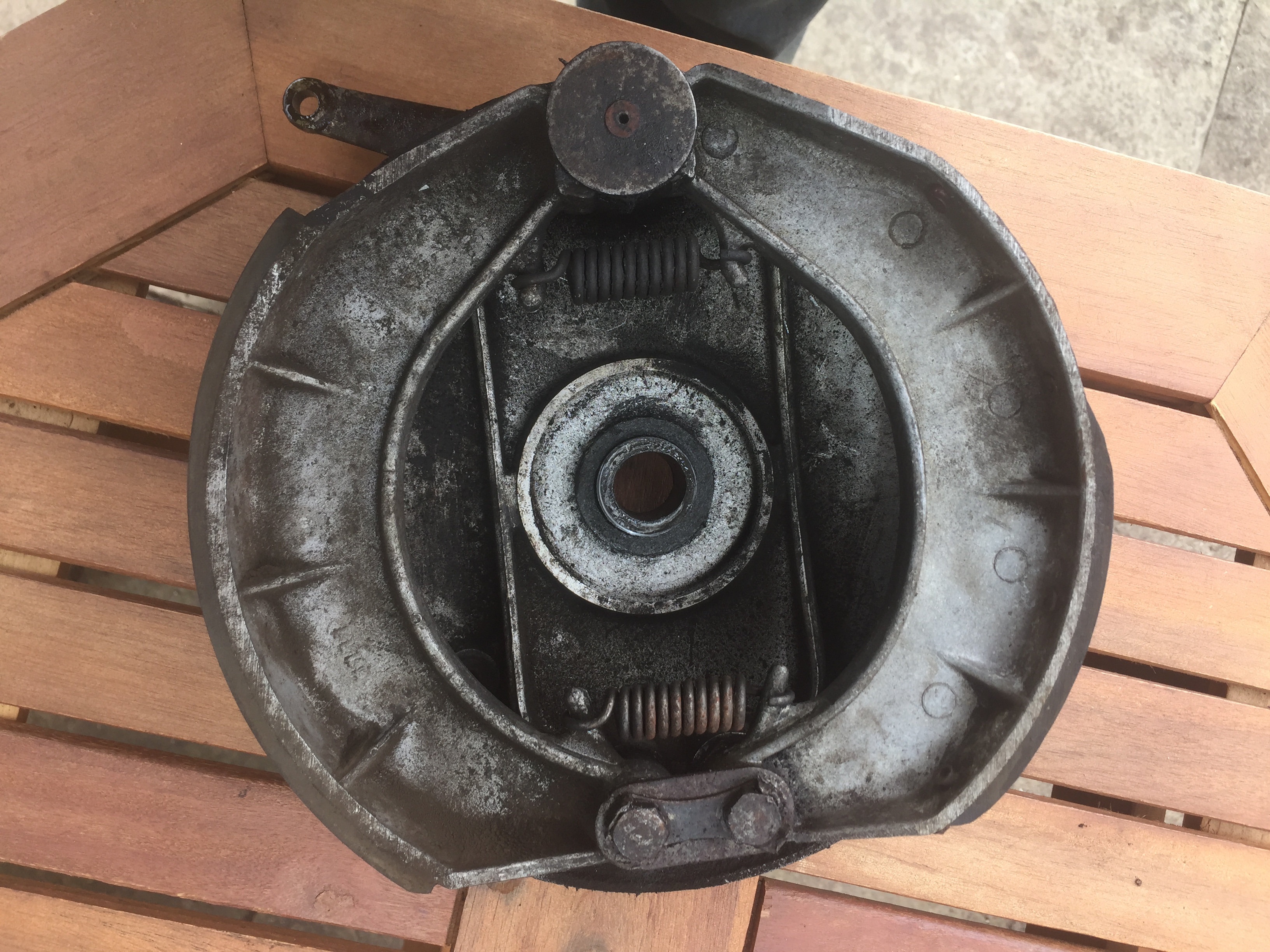

I have a SLS brake on two bikes and a TLS on another , I am often tinkering and usually manage to keep the efficiency up . However the TLS has had new "superior" linings fitted and will lock up on first application but refuse to do much else. A brake on a refurbished (by a well known expert ) 650 gave me a nasty fright when unloading backwards down a steep ramp when it exhibited absolutely zero retardation in reverse. Perversely my 99 with unknown autojumble shoes will stop dead in reverse but only half hearted in forward motion. If I park my low milage Renault van on a slope after a hot drive its likely to take itself off for a drive when cooled off !!. I need to get a grip on things. Anchor and a chain ?? ,After "expert" recall attention to the hydraulics at the renault dealership the brake/ clutch pedals would drop to the floor as if tired out. Needless to say thats the last time they will touch it !. Anyone fancy a lift or pillion ride with me??.

“Perversely my 99 with…
“Perversely my 99 with unknown autojumble shoes will stop dead in reverse but only half hearted in forward motion.”
That usually means the trailing shoe is contacting the drum before the leading shoe.

Hydraulic brakes that 'go to the floor' is air in the system, just needs bleeding!! I have always chamfered the leading edges of drum brakes. Some years ago when I first had the TLS Commando brake and was totaly un-impressed with its rubbish performance (seeing how good the SLS is) I phoned the factory, they advised me that the large central hole was there to allow for centralising the brake plate. But the TLS has adjustment on the brake rod for that!! So I had a bush made to reduce the hole dia, much better. Then another thing we find is that when adjusting the TLS with the rod, they shoes don't come on together-you can get them on at different times depends which 'spanner' you pull on first/most. All proves the need for a stiffening plate. But there has also been the realisation that the TLS shoes are narrower than the SLS ones!! Seems a backward step.

Hi Michael, About 10 years ago i had an engineer friend open out the brake plate as suggested. It was completely ruined by that and was scrapped as it would not release cleanly. So anyone thinking of doing that be prepared by organising a spare plate first. Luckilly i had a very scruffy spare plate that came off a Dunstall bike with tatty ugly air scoops . It turned out to be the best SLS i have used . Its on my 99 and hopefully will be back to rude health once I swap the shoes over and put the thickest shoe on the leading position, something I regularly do but I have been too busy working on other members problems !.

Regarding adjustment of TLS…
Regarding adjustment of TLS. I set my adjuster rod length on the bench. Adjusted until both shoes started to move at exactly the same instant. Then mounted it on the bike, giving a good hard pull on the brake lever before tightening the spindle. MOT inspector was very impressed by its performance.
The book method of using two spanners to hold the shoes on and adjusting the rod to fit doesn't work for me because (unlike the author of the Book) I don't have three hands.

“ i had an engineer friend…
“ i had an engineer friend open out the brake plate as suggested. It was completely ruined by that”
I attacked mine with a file and nothing was ruined. Seems unlikely that all the 1964-on backplates were ruined either.
Athough the bigger spindle hole did allow centring, removing lining material from the trailing edge of the trailing shoe has made a bigger improvement to the brake.
I’m not recommending you do anything mad like this.
I have already tried that…
I have already tried that Michael, probably helps if you don’t swap shoes like I do , it achieves a similar result by increasing the wear on the trailing shoe and keeping the pressure on the leading shoe which does most work.

Hi Steve, I agree that an almost invisible layer of rust will cause grabbing , but the Atlas will do it every day and the 99 not at all even when left in my damp shed!. There is obviously some other factor in play in addition . What fun we have with old bikes!.off to the shed now to swap my brake shoes over and see if stopping going backward can be transformed into stopping in the usual direction . —- later, can’t see anything unusual except the linings are very “full” and barely fit in the drum , and nowhere near run in yet .

My TLS shoes are 1 1/4" wide…
My TLS shoes are 1 1/4" wide. I'm sure that's no different from SLS.
My TLS has linings from Norton about 15 or 20 years ago, so they are asbestos free. It snatches dangerously just after I leave the shed if it's been laid up for a week or two, or of it's been wet. I have to apply it as I ride up the straight road until it clears.
A fortnight ago it did the same after was caught in the rain on my way home. It either slipped or snatched. Scariest trip...low speed, driving rain and only the back brake.
Today's task...remove wheel, clean dust, and improve the chamfer on the leading edges.
Does anyone have suggestions? Would a very much longer chamfer help to reduce snatch, even if there's a bit less effective braking area? Or even something simple like better return springs?
