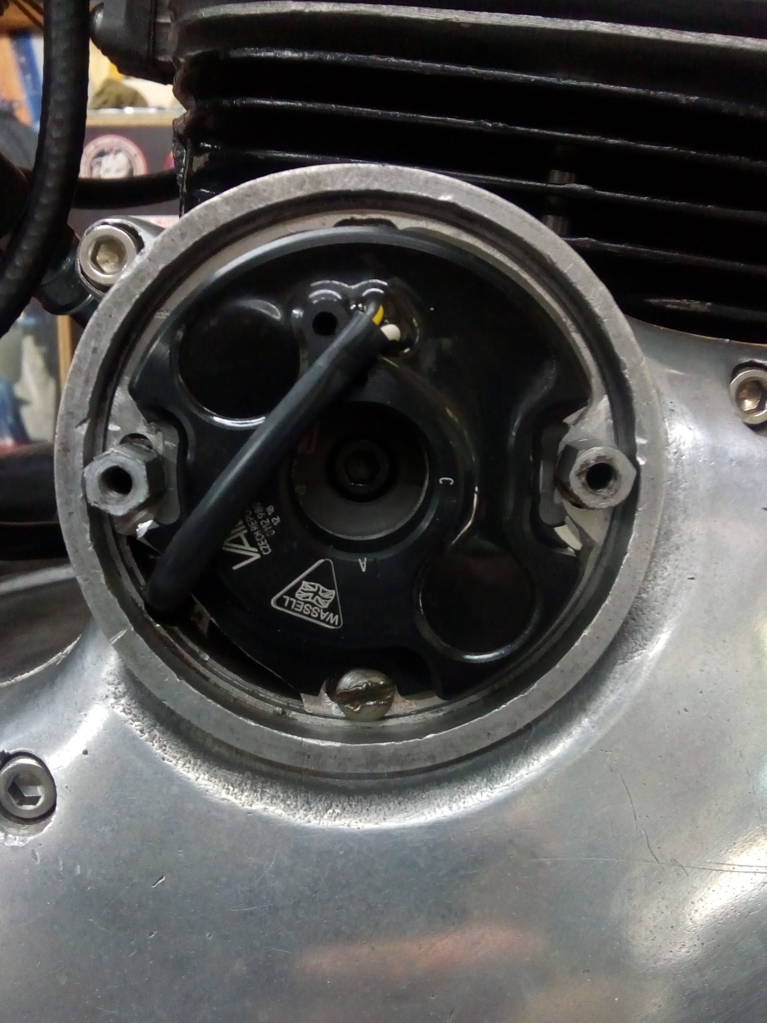

Can't comment on lightweights but have a Wassel system fitted as a replacement to my Boyer which was on a 1971 T120R Triumph. The Boyer had lasted 15 years until it started to breakdown when under load otherwise fine. The Wassel has been on 2 years and always starts the bike first or second kick. It was cheaper than Pazon and my local classic workshop said in his opinion little to choose between these 3 options. In did like the encasement of the important bits in hard plastic (as the photo above) unlike the Boyer which seemed rather exposed. The Dommie is still on its original set up but wonder consider a Wassel replacement if its starts playing up. Trust of some help. Hugh

Thanks, Hugh for your words of wisdom & foto.
However, I think the wires look a little vulnerable to vibration where they exit the unit.
I might be tempted to just dab a blob of silicon sealant on them to provide a bit of support against the vibes.
