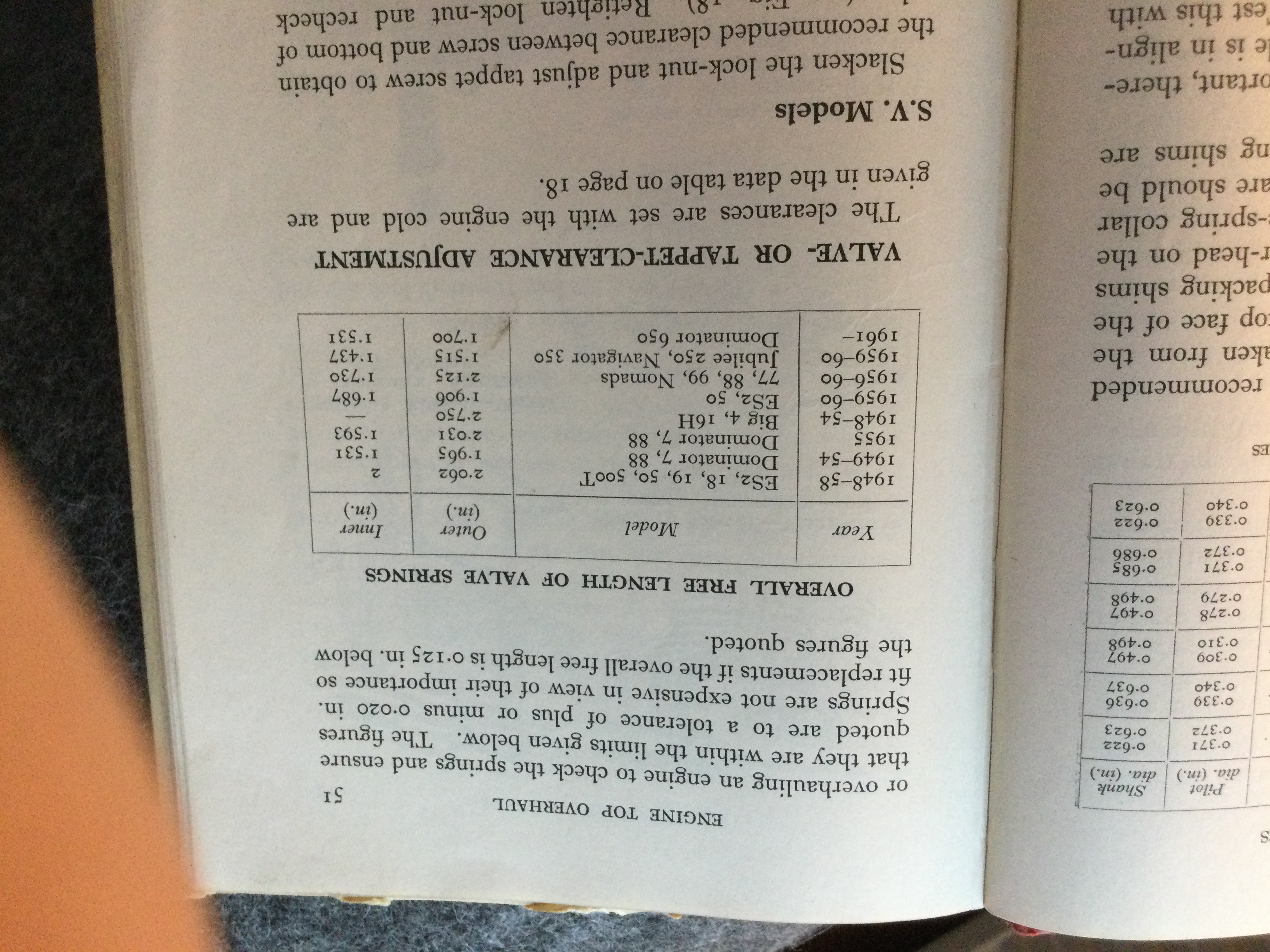

The Garrett book gives free lengths in the table as attached. For performance use it’s the poundage derived from the wire size that controls the valve.  The length ( providing your not coil bound on maximum lift), can be compensated for with shim or thermal insulator.
A drill press and weigh scale under a spring on the work table, depressing the spring to a working length will tell you how worn your springs are compared to the new ones.

Thanks Jonathan. I looked back at previous correspondence here. It seems the books say the outer should be 1.7" for my 88SS, but 1.65 is what is now sold for 1962-on twins (downdraft head). Someone wrote he thought it was to protect Combat head owners from becoming coil bound  because the same springs apply to all. Since they are on order, I might as well use them I suppose.
