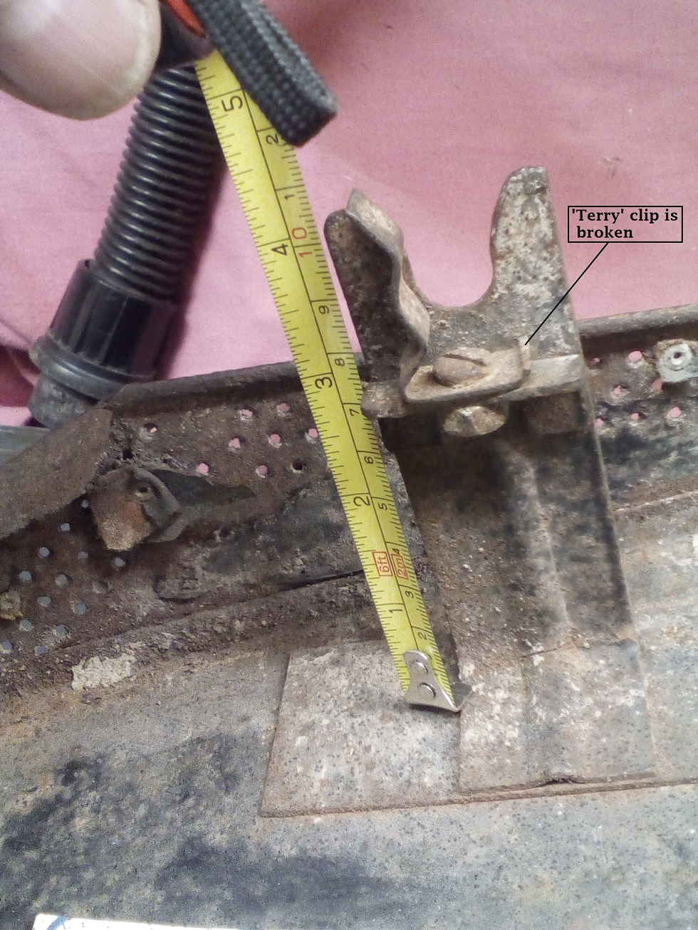

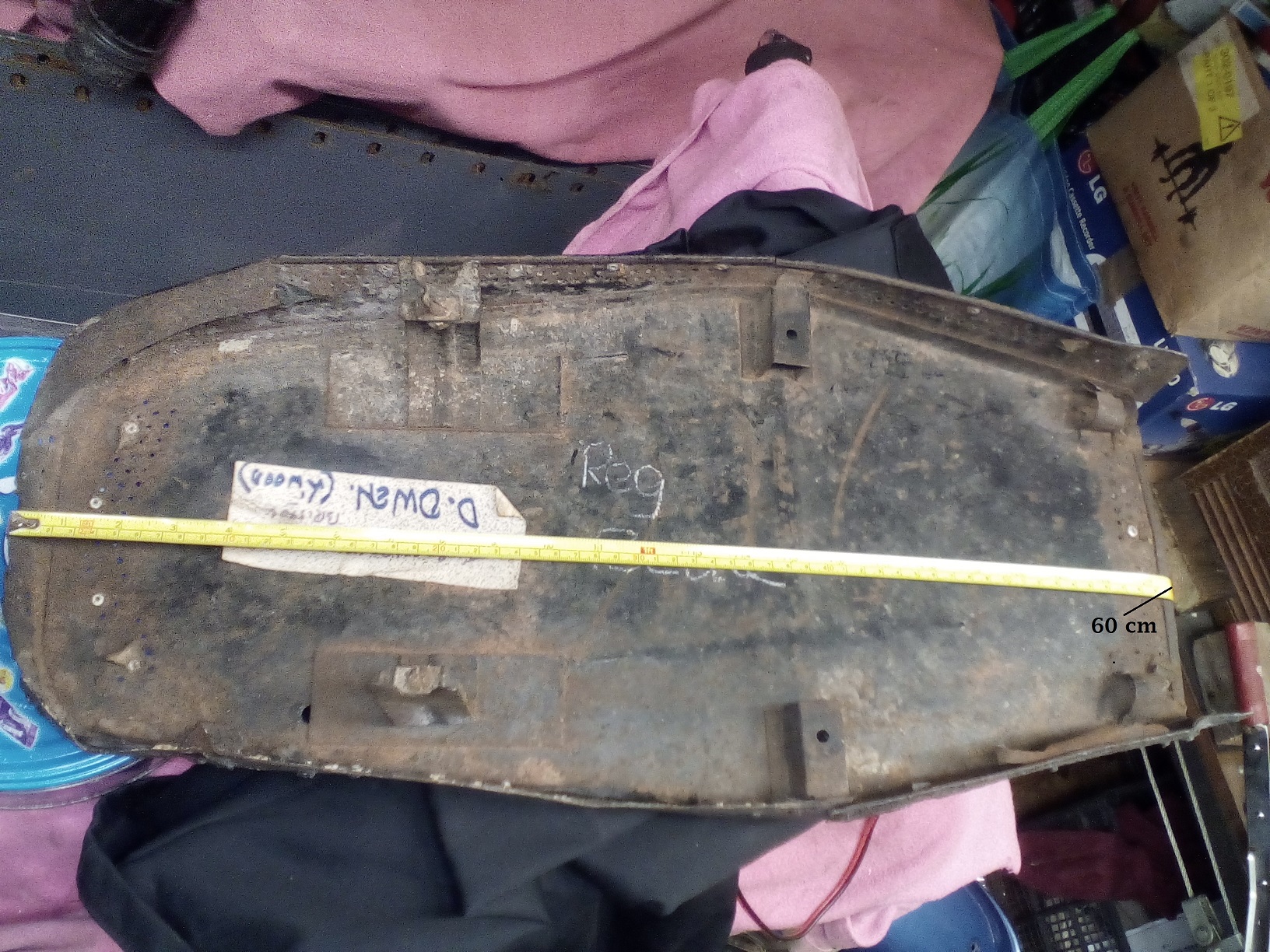

Terry clip pictures
Posted on your other query - but please find the pictures attached again - and below is what the seat mounting post looks like
Terry clip.
Andy, your second picture with the tape measure showing the fixing height is very helpful. Parts sell the terry clips, they also sell seat extensions. Im hoping that I can drill the seat pan and pass a bolt through the pan, seat extension and terry clip. Ive ordered these from parts. Hopefully this will work, if not I will make some right angled brackets as per your picture and bolt in place. Any bolt I pass through the pan I will ask Leightons to weld the head in place. If I do make brackets I will also ask them to weld these.
