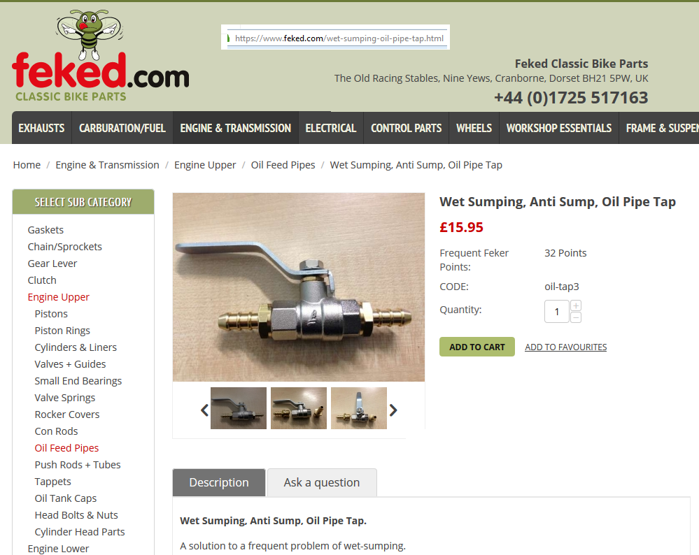

Only 3 options:
1) Ride regularly. We never had this issue when the bikes were used daily..... OR....
2) Fit a proper Full Flow On/Off tap in the feed to the engine - such as the Feked one attached. This MUST be fitted with a micro-switch to cut off the ignition as one day (as many people I know have) you WILL ride off forgetting about it.... OR...
3) Drain the oil tank after each blat, AND put the can containing the oil on the seat, as sooner or later you WILL ride off without putting the oil back in.
